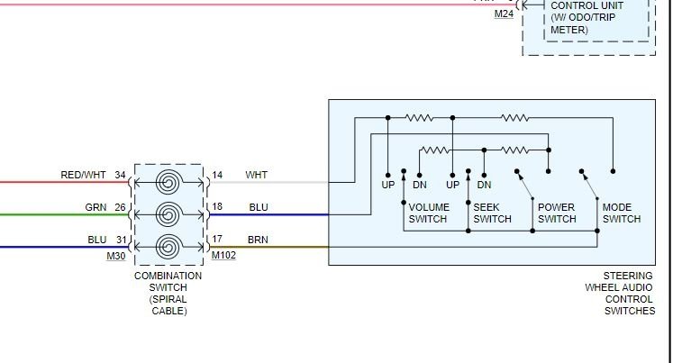

I was working on my car recently and a wire dropped out and now my horn and steering wheel buttons don't work, any help?

What were you working on, where approximately did the wire fall from, and what color is the wire?
I attached a pic of the audio switches on the steering wheel. See if any of the colors match what you found. As far as the horn, it should be a green or green and white wire.
Let me know what else on the steering wheel isn't working. For example, cruise control.
