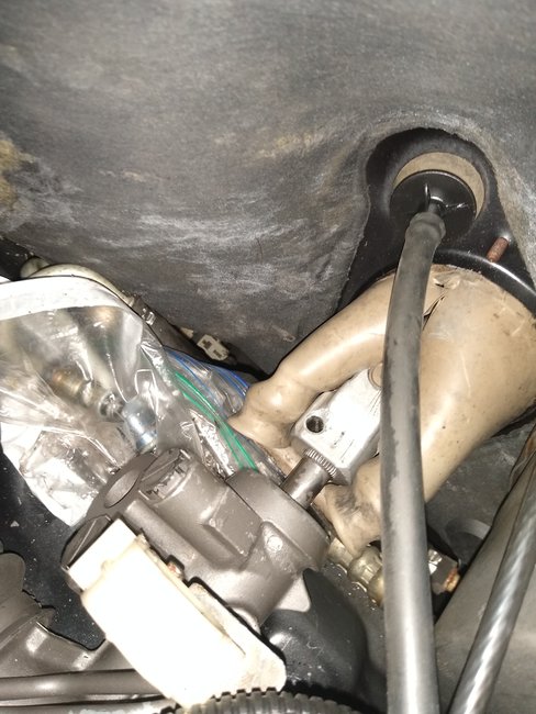

I see what others mean by the rubber boot going through firewall covering steering shaft as being in the way of accessing the roll pin.
So one should pull boot to interior to access roll pin.

I will remove steering column coupler as instructions stated, so I can access roll pin.
Saturday, August 22nd, 2020 AT 5:10 PM
Sorry, was out today.
The first picture is a good one to use.
I just use a long punch with the correct size for the pin to drive it out and in.

Hi, update on R&P gear replacement.
I removed old gear successfully.
Was able to pull it out with steering coupler still attached.
Then I knocked out roll pin and detached steering coupler from shaft of old gear.
I tapped on steering coupler onto new gear and drove pin in place.
I then tried to install new gear with steering coupler attached, but could not get steering coupler back in thru rubber boot and firewall.
So I removed gear and knocked out pin.
I placed steering coupler into boot/firewall first, then placed
gear back in place, but I can't get shaft of gear into steering coupler.
You need to tap steering coupler onto shaft of gear and there is no room under steering wheel to do this.
Note I cut rubber boot. See image.
Maybe put grease on gear shaft to make it easier to install?

Yes, use WD 40 as a lube to get it to seat.

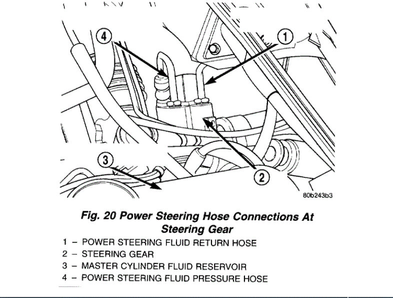

Hi Roy,
Sorry to drag this out. Appreciate the help. I placed new steering gear in. Drove roll pin in place.
Am replacing pressure and return hoses. I forgot to label ports on old gear. Which one is return and which is pressure?
+1
Saturday, September 5th, 2020 AT 7:32 PM
I attached a picture for the locations of the pressure and return lines.
+3

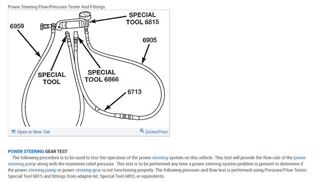

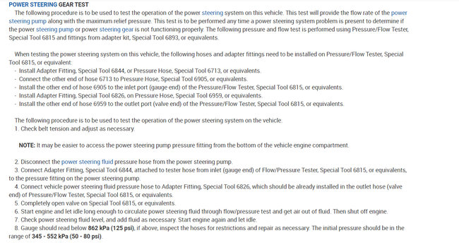

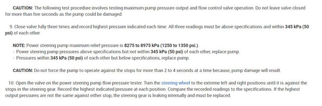

Tuesday, September 29th, 2020 AT 11:31 AM
The next step is to check the pressure output from the pump at idle and at 1,200 RPM's.
You should have 600 pounds at idle and about 1,000 at 1,200 RPM's.
+3
Tuesday, September 29th, 2020 AT 11:36 AM

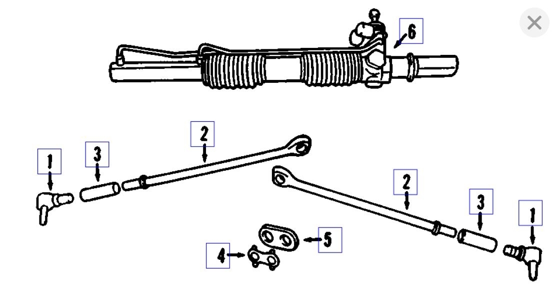

Hi folks,
About 6 months ago, I replaced my rack and pinion steering and power steering pump and outer tie rod bushings (moog kit).
Now last night when I go to make a right turn it is very difficult and then halfway through the turn it suddenly
becomes easy.
I never replace the outer tie rod like I should have 6 months ago.
I will update this with some pictures tomorrow morning.
But in the meantime what do you thinking about it may be being the outer tie rods? Or?
Thanks in advance if you can help me I appreciate it.
+1
Friday, February 12th, 2021 AT 11:51 AM

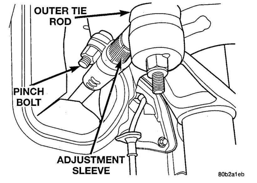

Okay, any part of the steering could be causing the issue.
It could be the tie rod end but you also have the ball joints as well that rotate when you turn.
https://www.2carpros.com/articles/tie-rod-end-replacement
https://www.2carpros.com/articles/how-to-release-a-ball-joint
I would disconnect the tie rods and see if the steering works correctly. If it does then hook up one side and see if it ends. Do the same to the other side as well.

Tie Rod Adjustment Sleeve Pinch Bolt
3. Loosen the pinch bolt at the outer to inner tie rod adjustment sleeve.

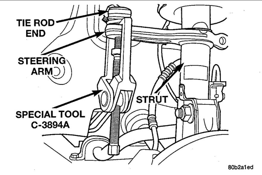

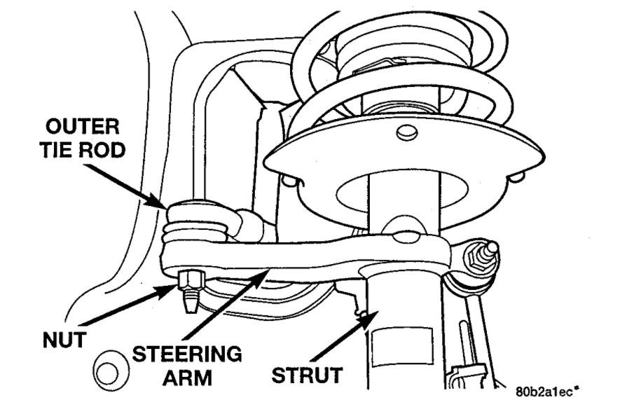

4. Remove the outer tie rod to strut steering arm attaching nut.
Tie Rod End Removal From Steering Arm
5. Remove the outer tie rod from the steering arm using Puller, Special Tool C-3894A, or equivalent.

1. Install the outer tie rod into the adjustment sleeve. Do not tighten the adjustment pinch bolt at this time.
2. Install the outer tie rod into the steering arm on front strut. Install tie rod to steering arm attaching nut. Tighten the attaching nut a torque of 37 Nm (27 ft. lbs.).
