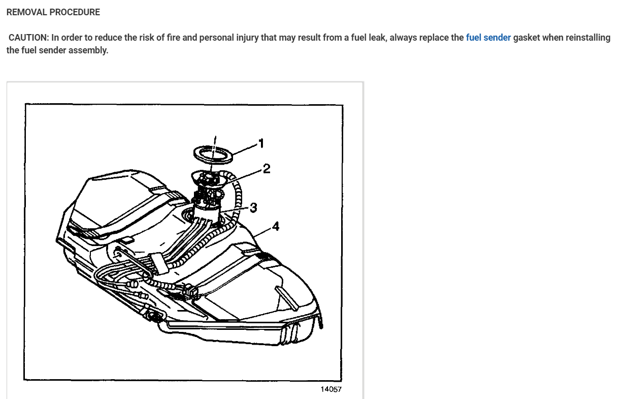

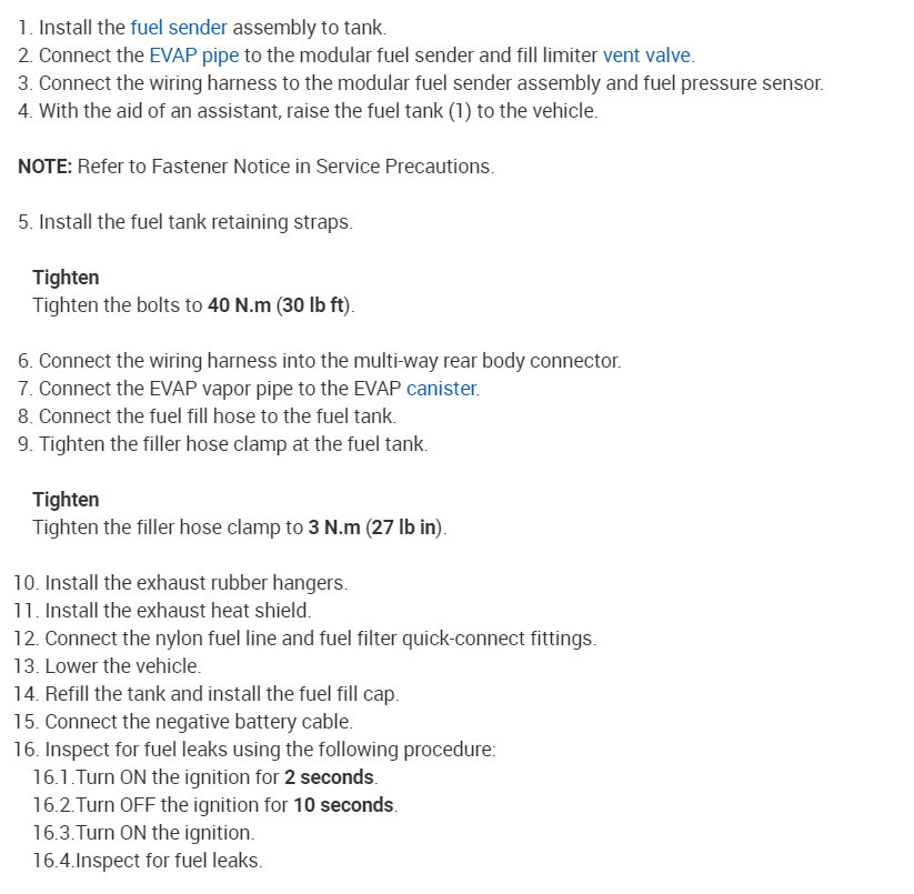

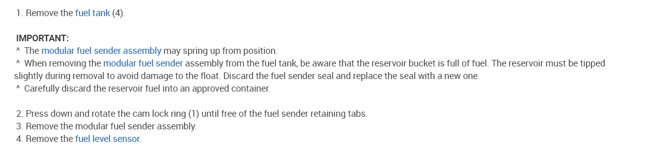

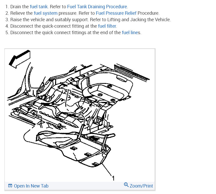

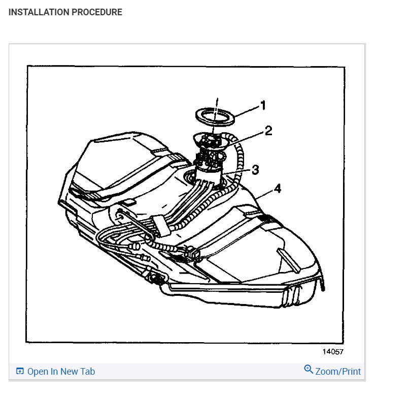

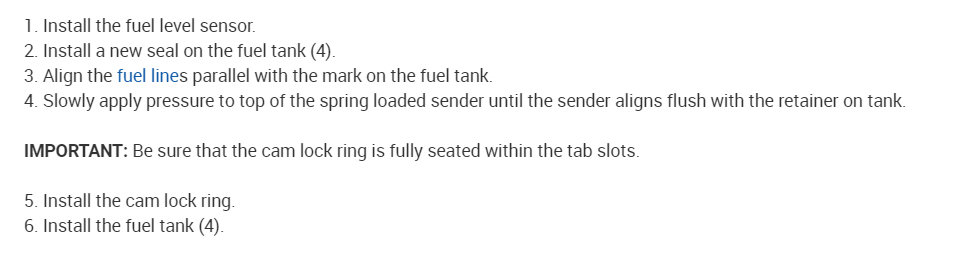

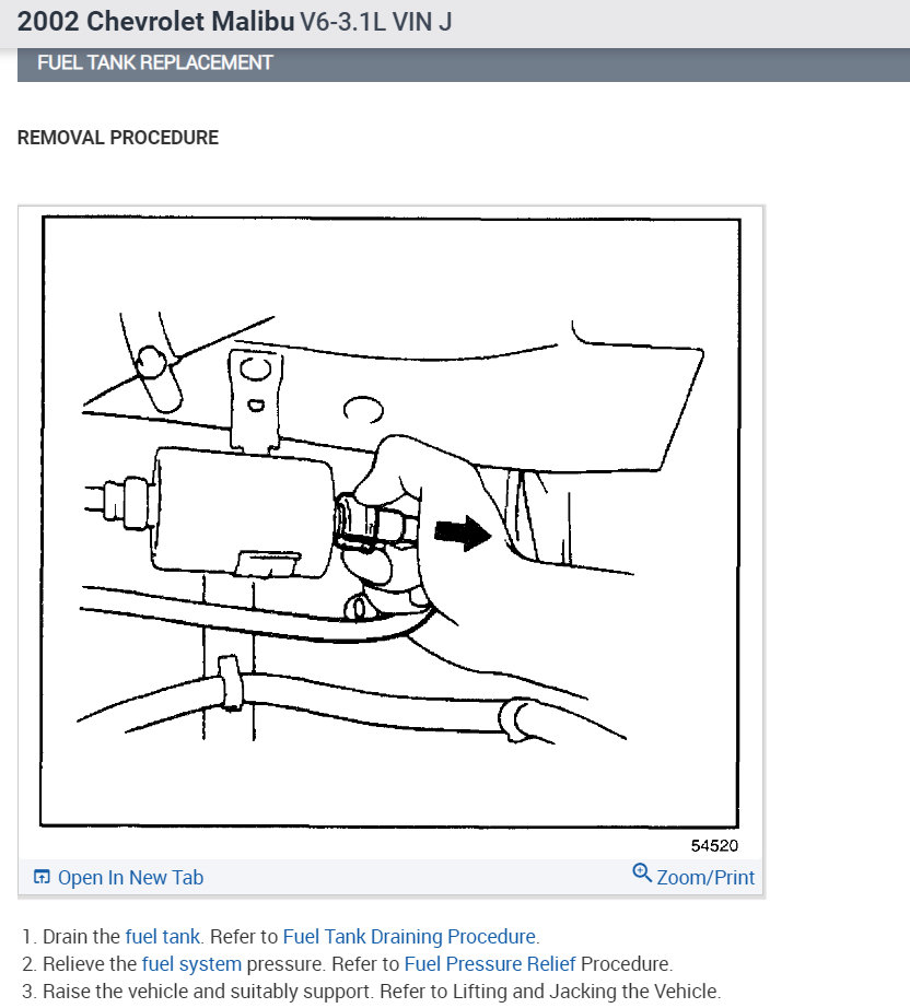

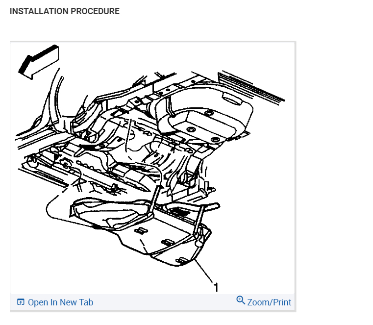

When the fuel pump was replaced, what brand was it? I only use AC Delco because of these kinds of problems. Also, we should run the codes to see what comes up here is a guide to show you how. You can get a code scanner from Amazon for about $20.00.
Here is a guide/video to show you how:
Here is a scanner link:
https://amzn.to/3Qi1SS6
Here are the correct replacement instructions for replacement of the fuel pump in the images below.
Wednesday, August 31st, 2022 AT 7:31 AM
