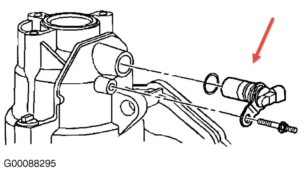

Yesterday I was driving on the Eway and trying to merge, the car had been driving fine, but all of a sudden it started acting like it did not want to go into a higher gear and rpm's were going way up. Also, my speedometer started going crazy. Any ideas?

Scan for codes it may be a vss going bad or you may have a transmission problem. Auto parts stores can do for free.

After the test it is for sure the VSS, Now to locate exactly where the Vss is located on this car.

Well scanning may have said that, but it may be something else to do like wiring. See picture this may be on passenger side of vehicle look for a wiring harness to it.
