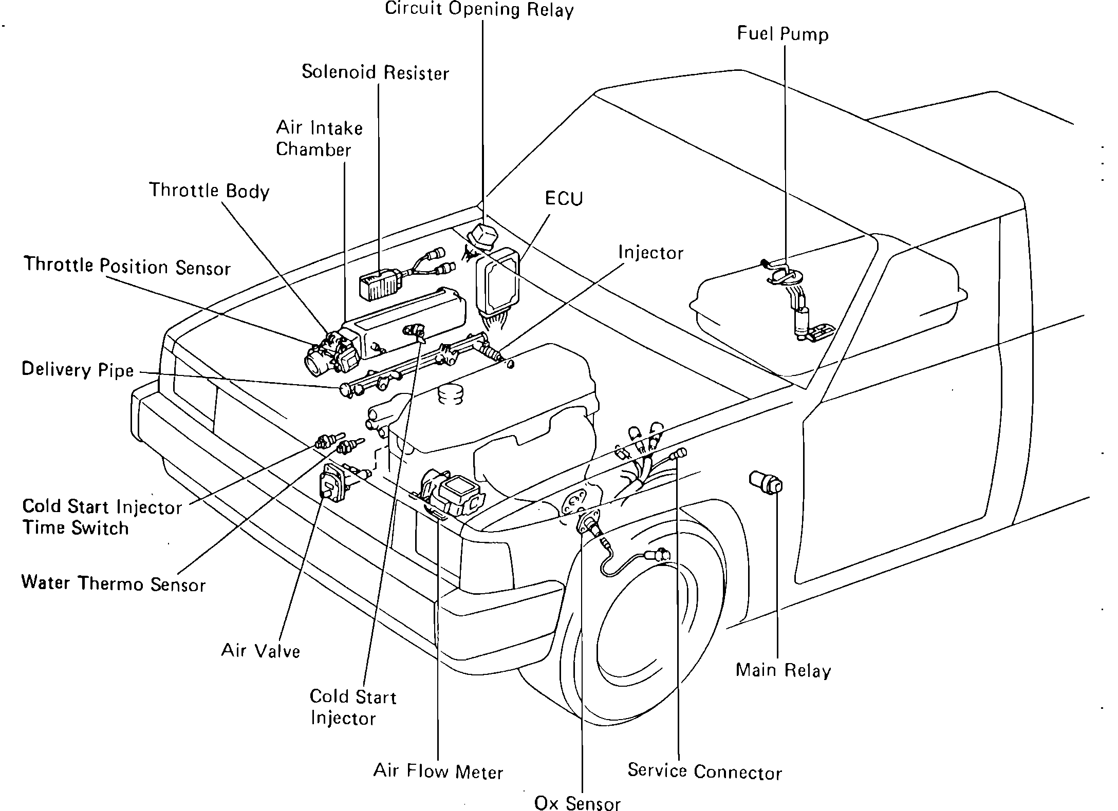

Well, every thing is new, battery, cables, cleaned all grounds still the same. While checking power at fuel pump, I noticed the 12 volts went away after start, where the heck is the fuel pump relay on this heap? The truck is a 1986 cab and chassis. Thanks a lot Joe it is nice of you to help. Google YouTube show newer trucks but zip on 1986.

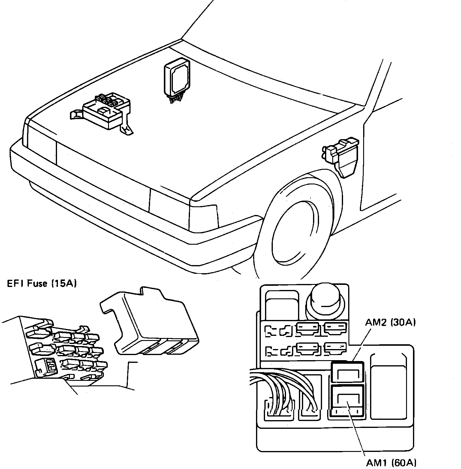

Welcome back. Check all fuses and the relay. I have attached pictures of the relay and fuse locations. Chances are it is not the switch.
Here is a link that discusses how to test a relay:
Thursday, November 8th, 2018 AT 7:29 PM
STEVEGRIFFIN
Hi Joe, yes you are right. There is power everywhere. Turns out a circuit opening relay and the ground wire are the problem, they should have named it gremlin switch to cut fuel. Thanks Joe
