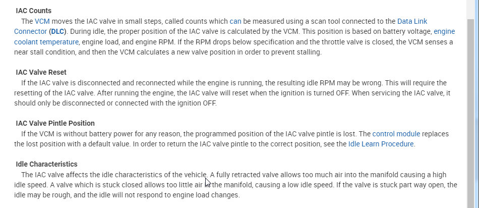

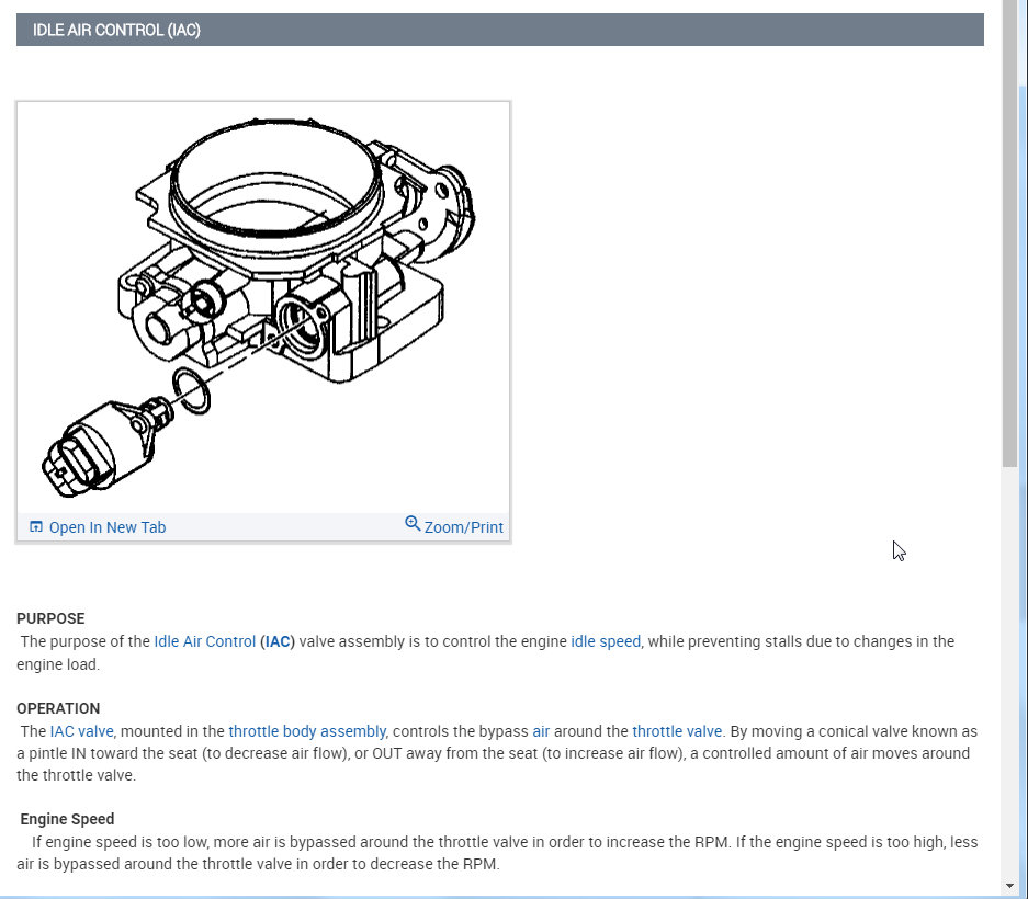

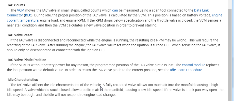

Can you give a little more detail about when this stalls? I understand that the engine will keep running if you give it throttle but you said it runs well in neutral but does this mean it will run without throttle input or no matter what you have to give it throttle to run?
If this will stall at idle no matter what, it sounds like the IAC. Review this material and let me know what you find.
Here is a guide that covers the basic things that cause stall at idle:
Let me know what you find with this and we can go from there. Thanks

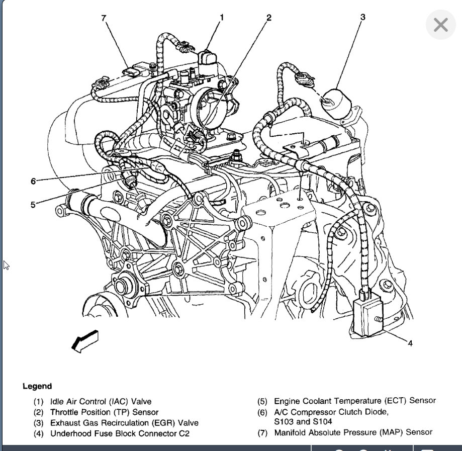

Thanks for your input. Yes, I have to throttle it no matter what. I will order a IAC online as I'm not going to pay $75.00 for it when I can get it for $20.00. I did pull it out and upon inspection it is pretty badly coked. Reading some of your other articles I did clean the ground for the fuel pump and snotted out the throttle body. I also bought a fuel filter to install. I was looking for the EGR valve but couldn't locate it. I know they can cause issues as well. I'm not sure how soon I will get the IAC but will update. Thanks for your help.
Thursday, April 9th, 2020 AT 2:03 PM
Sounds great. If the IAC was coked up then clearly that should be the first thing as you are doing. The EGR will most likely not cause a stall like this but we can address that if the IAC does not fix it but I attached the location.
Keep us updated with what you find. Thanks
