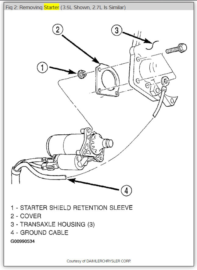

It sounds like the starter is going out, but to be sure you will need to use a test light and check the trigger wire (small) at the starter solenoid to see if its getting power when the key is turned to crank.
Check out toward the bottom of this guide which will show you how to do it.
And if found to be bad this guide will show you what you are in for when doing the repair.
Must will need to raise the car so you can get under it safely.
Here are some diagrams of your car (below).
Please let us know what you find. I'm interested to see what it is.

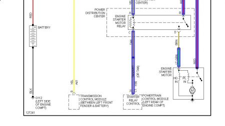

when I try to start the car, I turn the ignition on and the fuel pump comes on for a few seconds along with the dash lights but in the starter position there is nothing. I swapped out the starter relay, and verifyed that the starter itself was good. I also did a check on the ignition voltage supply to the relay and it is good. I am not shure if it is the pcm, or the wiring going to the pcm, or if the pcm is not getting proper input. I do know that the ground coming out of the pcm and going to the starter relay is insuficient. I am still not shure what it is?

The car will not even roll over when attempting to start. I did verify that the actual starter motor does crank the engine, I jumped the contacts in the relay socket and the starter motor worked fine so I know I dont need a starter. If I independantly grounded the one side of the coil (of the starter relay) that the pcm is supposed to ground, the other side that the ignition supplies works fine, so I am assuming that the park/neutral switch that is wired in series work fine also.
The part I dont under stand is why the pcm wont atomaticly send ground to the starter relay when it is calling for it?
Do I have a bad pcm, or wrong imput from any sensor, or is there any kind of short?
+2
Friday, October 20th, 2017 AT 12:08 PM (Merged)

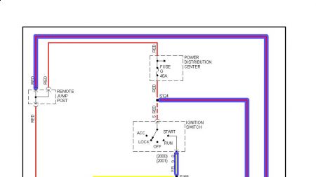

  • 75,992 POSTS

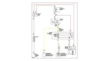

The start circuit comes from the ignition switch to the relay then computer grounds it then power is transfered thru the light green wire to the starter solenoid.
https://www.2carpros.com/forum/automotive_pictures/12900_starter_circuit_8.jpg

The start circuit comes from the ignition switch to the relay then computer grounds it then power is transfered thru the light green wire to the starter solenoid, you said.
The relay is not grounded by the computer, why?
  • 75,992 POSTS
The PCM control s the ground circuit look at the diagram-Try jumping the starter relay red and brown wire and see whether the starter engages the engine-

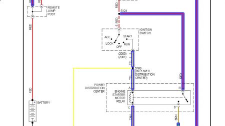

Inspect and test the starter relay and the starter relay control of the computer
https://www.2carpros.com/forum/automotive_pictures/12900_s1_40.jpg
https://www.2carpros.com/forum/automotive_pictures/12900_s2_37.jpg
https://www.2carpros.com/forum/automotive_pictures/12900_s3_6.jpg
+1
  • 75,992 POSTS
Do this remove the yellow wire from the starter relay-have helper hold key at start position -test for power at yellow wire -no power -test the ignition switch-power at yellow wire now you can replace the computer-
