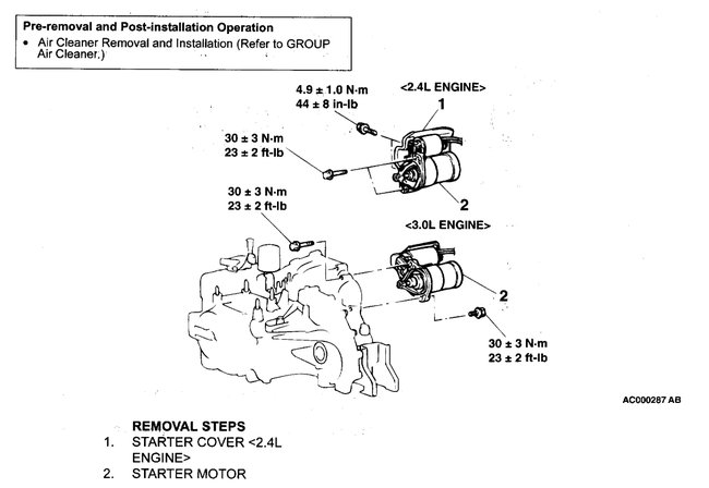

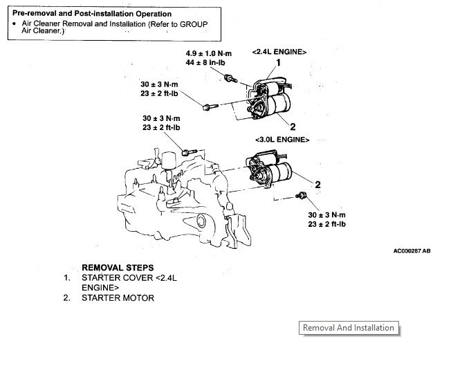

I am trying to take the starter out but cannot locate the other bolt to get the starter out.
Aug 8, 2018 at 6:07 AM
  • 54,162 POSTS
Here is a guide to help you see what you are in for when doing the job and diagrams below to show you how it is done on your car I included both engine to be safe.

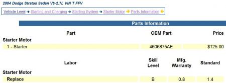

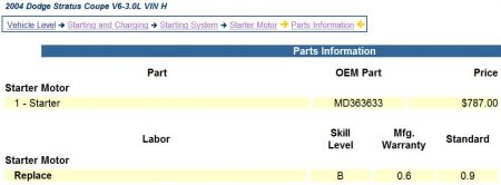

SNEAKYPETE69
2004 Dodge Stratus 6 cyl Front Wheel Drive Automatic
how long to change the starter motor? i think the shop is charging me too much
Aug 3, 2020 at 1:38 PM (Merged)
  • 75,992 POSTS
https://images.2carpros.com/forum/automotive_pictures/12900_s1_60.jpg
https://images.2carpros.com/forum/automotive_pictures/12900_s2_54.jpg
Note:Part and labor varies within location.

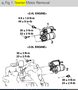

DANNY L
  • 5,648 POSTS
Hello, I am Danny.
I am sending you a link for reference. Starter is located at the left rear of your vehicle. Be sure to disconnect the negative battery cable before removing to prevent damage/shock/fire!

  • 54,162 POSTS
It is under the car near the transmission by the firewall. Here is a diagram (below) and a guide to help you get the problem fixed.

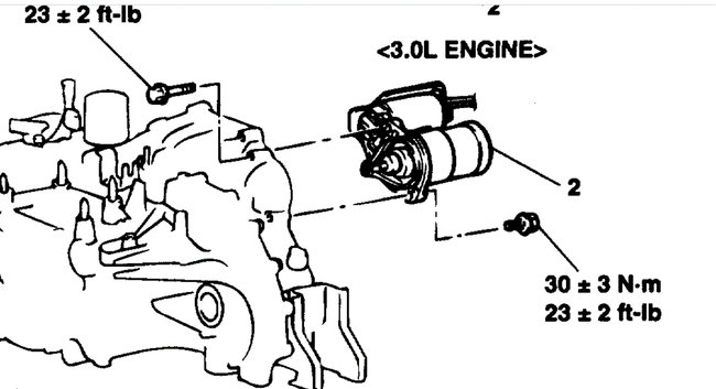

BRIAN CLARK4
  • 5 POSTS

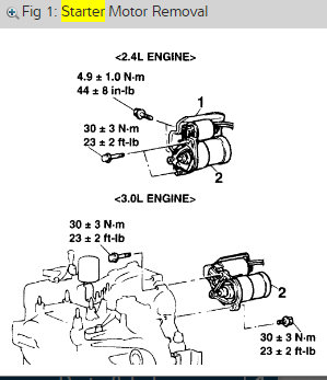

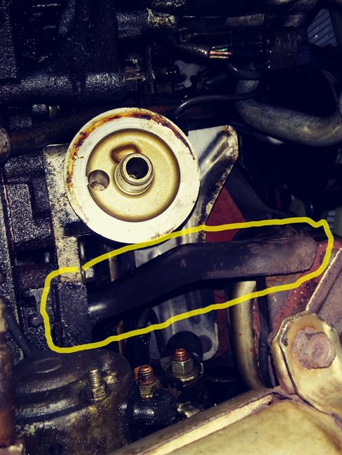

Car listed above is a SE 2 door coupe. Trying to remove a starter from this vehicle but have a engine bracket holding the end of the exhaust manifold in the way. Bottom bolt no problem, upper bolt for this bracket is in a really tight spot and tried to use every tool I could think of to get in there and remove it, without any luck. Without it's removal I have no way of getting to the upper bolt of the starter. Any suggestions or help to remove this bracket would be sincerely appreciated. I have watched other videos , and read instructions - the only things that they specify are in the way is the oil filter, the O2 sensor, and having to lower the exhaust pipe down a little to get it out. Nothing about this bracket, nor how to get at it's upper bolt.
Aug 3, 2020 at 1:40 PM (Merged)
  • 110,190 POSTS
Are you aware that the upper bolt comes from the transmission to the starter? If you have the air filter box removed, you should be able to access it.
BRIAN CLARK4
  • 5 POSTS
Hey Joe,
No I wasn't aware of that, but appreciate it greatly and will look for it. Do you have any idea about the bracket that I am referring to? Even after the bolt is removed that bracket looks like it will still be in the way of getting the starter out.
  • 110,190 POSTS
Do me a favor, it's been awhile since I did one of these. Can you upload a picture of the bracket you are referring to? It should spark some memory (good or bad). LOL In all honesty, this is one of the easier ones. Some cars require the intake to be removed. Ugh!!! It just keeps getting more and more interesting. Eventually, one will need a mechanical engineering degree to replace an air filter. LOL
Take care and I will watch for your reply.
BRIAN CLARK4
  • 5 POSTS
Hey Joe, here is the picture of the mount in question.

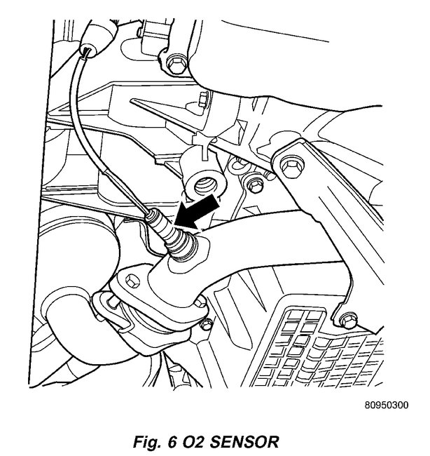

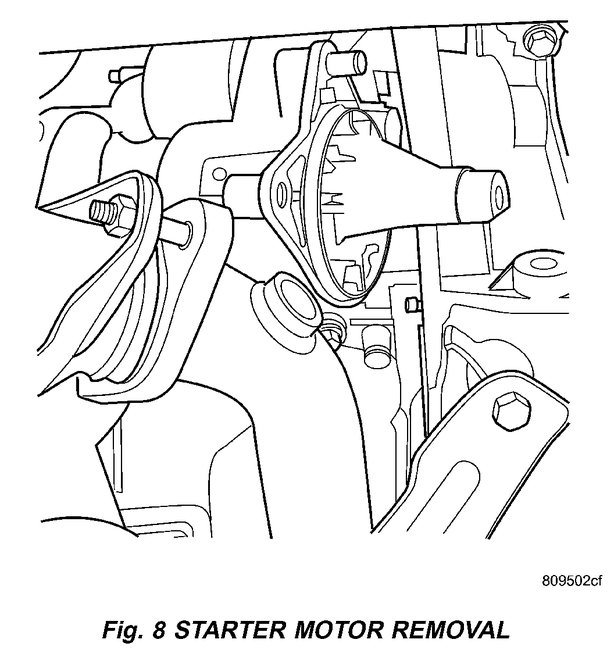

I have a 2002 Dodge Stratus, 2.7 liter v6. When I try to start it, the 20 amp start/fuel fuse keeps blowing. I'm almost certain the starter or solenoid that needs replacing. My question is how do you replace the starter. What other parts need to be removed in order to get to it?
Thanks
BLUELIGHTNIN6
  • 16,542 POSTS
https://images.2carpros.com/forum/automotive_pictures/261618_Noname_728.jpg
https://images.2carpros.com/forum/automotive_pictures/261618_Noname2_189.jpg
  • 110,190 POSTS

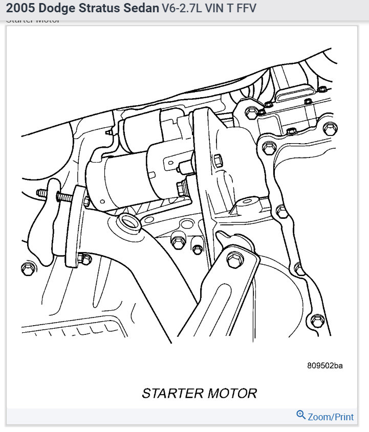

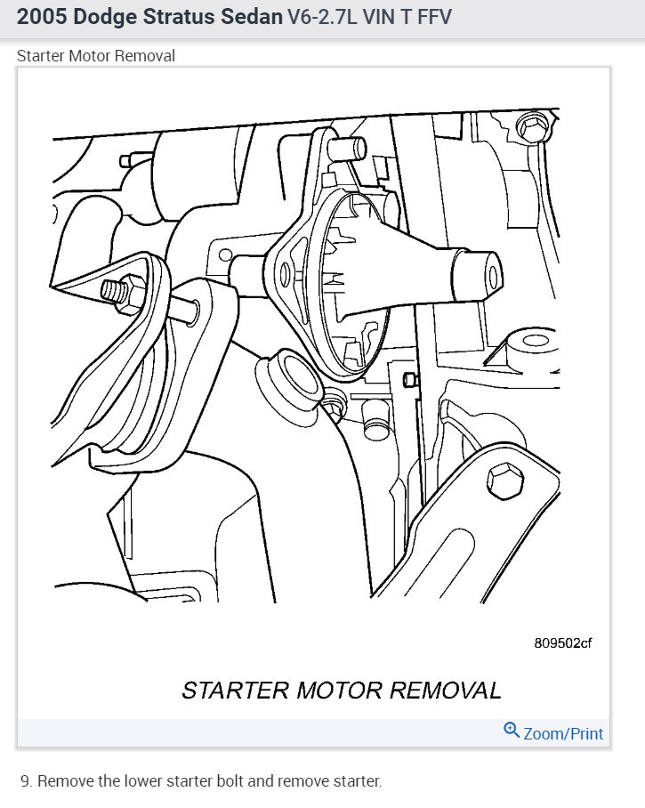

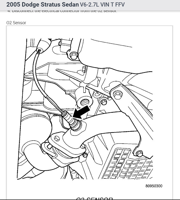

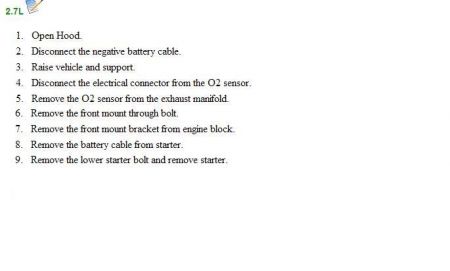

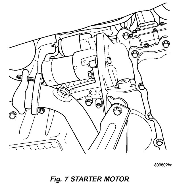

What is that attached to on the right hand side of your pic? Here are the directions specific to your vehicle. Take a look through them and let me know if they help in any way. As far as the pic, I believe that is a support between the engine block and transmission, but I'm not 100% sure. Also, please confirm something for me. You indicated this as a 3.0L V6. It should be the 2.7L. Is that correct? Also, let me know if it is a sedan or coupe.
_______________________________________
2002 Dodge Stratus Sedan V6-2.7L VIN R
Procedures
Vehicle Starting and Charging Starting System Starter Motor Service and Repair Procedures
PROCEDURES
REMOVAL
1. Open Hood.
2. Disconnect the negative battery cable.
3. Raise vehicle and support.
4. Disconnect the electrical connector from the O2 sensor.
Fig.6 O2 Sensor
Pic 1
5. Remove the O2 sensor from the exhaust manifold (Fig. 6).
6. Remove the front mount through bolt.
7. Remove the front mount bracket from engine block.
Fig.7 Starter Motor
pic 2
8. Remove the battery cable from starter (Fig. 7).
Fig.8 Starter Motor Removal
pic 3
9. Remove the lower starter bolt and remove starter (Fig. 8).

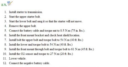

INSTALLATION
1. Install starter to transmission.
2. Start the upper starter bolt.
3. Start the lower bolt and snug it so that the starter will not move.
4. Remove the upper bolt.
5. Connect the battery cable and torque nut to 8.5 Nm (75 in. lbs.).
6. Install the front mount bracket and check heat shield location.
7. Install bolt the upper bolt and torque bolt to 54 Nm (40 ft. lbs.)
8. Install the lower and torque bolt to 54 Nm (40 ft. lbs.)
9. Install the front mount through bolt and torque bolt to 61 Nm (45 ft. lbs.)
10. Install the O2 sensor and torque to 27 Nm (20 ft. lbs.)
11. Lower vehicle.
12. Connect the negative battery cable.

Hey Joe. It's a 2002 3.0L SE coupe. The sedan instructions and illustrations are what originally got me disoriented with the removal of the starter because they are not the same. The bracket that is in question is one that connects the end of the manifold to the engine chasis. While It does have a arc bend upward, the retaining bold on the upper part of that is about 45 degrees pointing up, and without taking the entire manifold off there is no way to get to that bolt at least to my knowledge. My biggest concern , is when I drop the starter, that it will not clear it. The positioning of that bracket and a 45 degree upper bolt towards the hood would make it impossible to get to without removing the manifold. I barely got 2 fingers into the area on either side, It was definitely meant to be taken out from the top.
Mitsubishi engines.. ugh.. lol
BLUELIGHTNIN6
  • 16,542 POSTS
you should support it with a jack or similar tool, yes.
  • 110,190 POSTS
Brian,
OMG! I was looking at a sedan the entire time.
Believe it or not, I have no directions from the manual. Here is what I recall: Remove the oil filter, remove the O2 sensor. Then, you have to remove the two 19mm bolts from the down pipe on the exhaust to manifold and lower the pipe. That is the only way I ever remember doing it. And if I recall, there was no easy way to get it out even after that was done. I always had to fight them.
As far as that bracket, if it was bolted between the manifold and the chassis, I would think it would constantly break the manifold when the engine torqued.
Wow, nothing is ever easy. Tell me if you think lowering the Y pipe will help with space. That is honestly the only thing I can remember from these. I even went into the manual and looked up engine removal and nothing was listed for that support.
BRIAN CLARK4
  • 5 POSTS
Yeah, I appreciate it brother. I do not see any easy way through this problem. But I am going to press forward and hope that I can get it out and get the new one in without having to send it to a shop to have them tear the upper portion of the manifold shielding off and/or the manifold itself to get it done. It doesn't look like it will clear regardless of how I finagle it out, even having the Y pipe lowered , the space where the starter is, and this bracket - is going to have issues I believe. I really do appreciate your time and effort on it.
  • 110,190 POSTS
If you have a chance, let me know how things turn out. Honestly, I pulled a transmission out of a Dakota and I swear the car was built around it. LOL

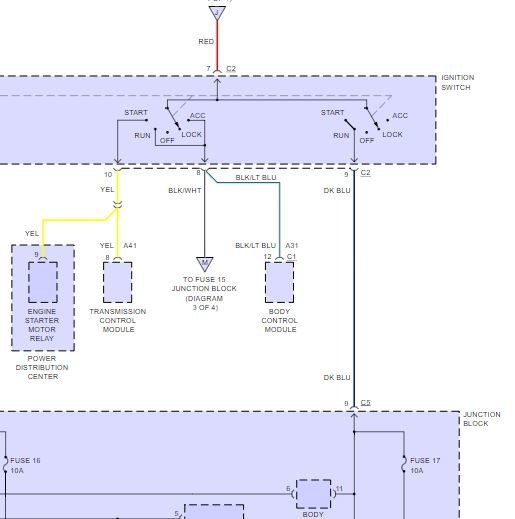

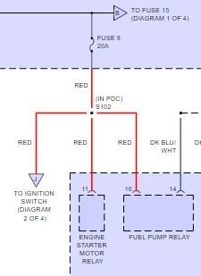

SAMMYS79
The 20 amp starter/fuel fuse started blowing when key is turned. I blew five in a row. when the engine does start it never blows the fuse. I was wondering if it is possible the starter solenoid is drawing to much.
Aug 3, 2020 at 1:41 PM (Merged)
PATENTED_REPAIR_PRO
  • 1,853 POSTS
Is this fuse #8 in the PDC located under the hood at the left front fender panel?
If so, exactly where is the ignition key position at when the fuse blows?
I see three things that fuse powers, the starter relay, the fuel pump relay and the ignition switch. So remove the fuel pump relay and the starter relay and then see if that fuse still blows when you turn the key to that position. If it still blows the fuse, then it must be with whatever the ignition switch feeds.
SAMMYS79
The exact key position is in the start position. Thing are fine when key is switched from off to on,dash lights up and all icons, as soon as key is switched to crank engine fuse blows. The other night when this first happened it had been raining while the car was being driven then shut off and parked for about three hours. I left the car sit in parking lot till morning, then went back to try to start it again. the overnight temp dropped from forty degrees down to eighteen degrees by morning. After blowing five fuses, it started. I drove it to my heated garage to try to trouble shoot the problem. I am thinking maybe something was wet, because I cannot get it to blow a fuse. not sure where to look, probable it will happen again if water gets back into the mix. So far you have been a great help, cleared up some misconceptions I had. I will monitor this as time goes. I welcome any advise.Thanks again!
