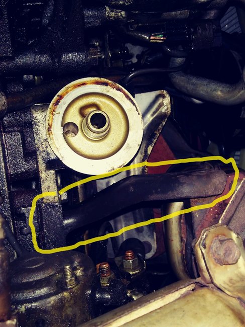

Car listed above is a SE 2 door coupe. Trying to remove a starter from this vehicle but have a engine bracket holding the end of the exhaust manifold in the way. Bottom bolt no problem, upper bolt for this bracket is in a really tight spot and tried to use every tool I could think of to get in there and remove it, without any luck. Without it's removal I have no way of getting to the upper bolt of the starter. Any suggestions or help to remove this bracket would be sincerely appreciated. I have watched other videos, and read instructions - the only things that they specify are in the way is the oil filter, the O2 sensor, and having to lower the exhaust pipe down a little to get it out. Nothing about this bracket, nor how to get at it's upper bolt.

No I wasn't aware of that, but appreciate it greatly and will look for it. Do you have any idea about the bracket that I am referring to? Even after the bolt is removed that bracket looks like it will still be in the way of getting the starter out.

Do me a favor, it's been awhile since I did one of these. Can you upload a picture of the bracket you are referring to? It should spark some memory (good or bad). LOL In all honesty, this is one of the easier ones. Some cars require the intake to be removed. Ugh! It just keeps getting more and more interesting. Eventually, one will need a mechanical engineering degree to replace an air filter. LOL

Hey Joe, here is the picture of the mount in question.

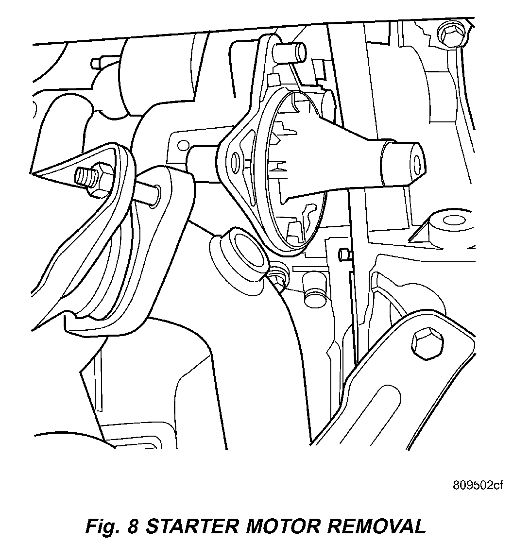

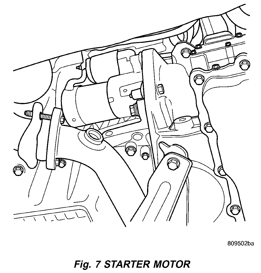

What is that attached to on the right hand side of your pic? Here are the directions specific to your vehicle. Take a look through them and let me know if they help in any way. As far as the pic, I believe that is a support between the engine block and transmission, but I'm not 100% sure. Also, please confirm something for me. You indicated this as a 3.0L V6. It should be the 2.7L. Is that correct? Also, let me know if it is a sedan or coupe.

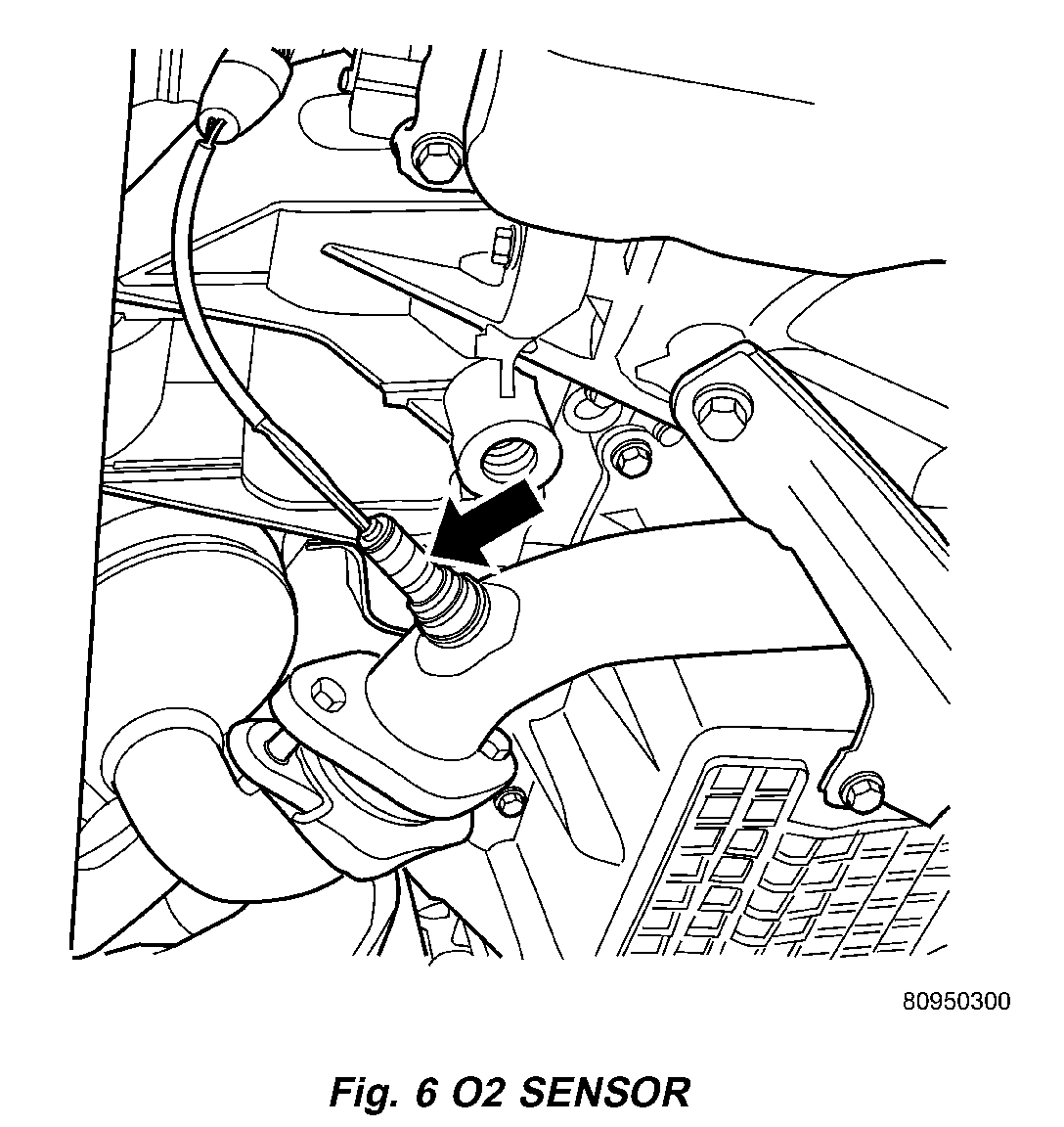

4. Disconnect the electrical connector from the O2 sensor.
Fig.6 O2 Sensor
Pic 1
5. Remove the O2 sensor from the exhaust manifold (Fig. 6).

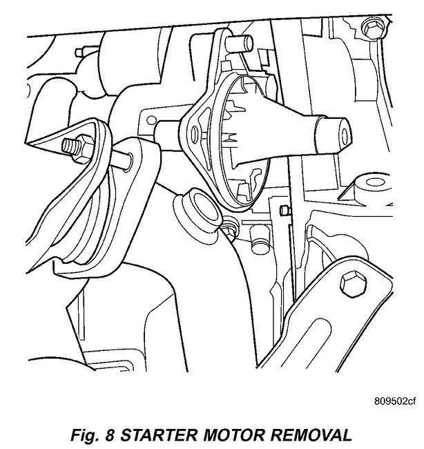

Fig.7 Starter Motor
pic 2
8. Remove the battery cable from starter (Fig. 7).
Fig.8 Starter Motor Removal
pic 3
9. Remove the lower starter bolt and remove starter (Fig. 8).

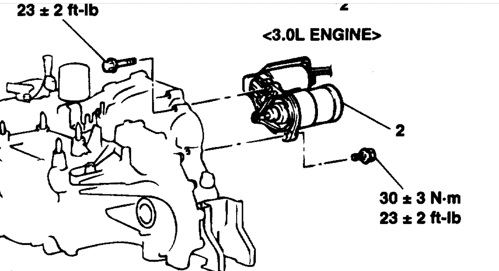

Hey Joe. It's a 2002 3.0L SE coupe. The sedan instructions and illustrations are what originally got me disoriented with the removal of the starter because they are not the same. The bracket that is in question is one that connects the end of the manifold to the engine chasis. While It does have a arc bend upward, the retaining bold on the upper part of that is about 45 degrees pointing up, and without taking the entire manifold off there is no way to get to that bolt at least to my knowledge. My biggest concern, is when I drop the starter, that it will not clear it. The positioning of that bracket and a 45 degree upper bolt towards the hood would make it impossible to get to without removing the manifold. I barely got 2 fingers into the area on either side, It was definitely meant to be taken out from the top.

Believe it or not, I have no directions from the manual. Here is what I recall: Remove the oil filter, remove the O2 sensor. Then, you have to remove the two 19mm bolts from the down pipe on the exhaust to manifold and lower the pipe. That is the only way I ever remember doing it. And if I recall, there was no easy way to get it out even after that was done. I always had to fight them.
As far as that bracket, if it was bolted between the manifold and the chassis, I would think it would constantly break the manifold when the engine torqued.
Wow, nothing is ever easy. Tell me if you think lowering the Y pipe will help with space. That is honestly the only thing I can remember from these. I even went into the manual and looked up engine removal and nothing was listed for that support.

Yeah, I appreciate it brother. I do not see any easy way through this problem. But I am going to press forward and hope that I can get it out and get the new one in without having to send it to a shop to have them tear the upper portion of the manifold shielding off and/or the manifold itself to get it done. It doesn't look like it will clear regardless of how I finagle it out, even having the Y pipe lowered, the space where the starter is, and this bracket - is going to have issues I believe. I really do appreciate your time and effort on it.

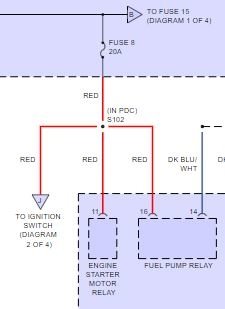

The 20 amp starter/fuel fuse started blowing when key is turned. I blew five in a row. When the engine does start it never blows the fuse. I was wondering if it is possible the starter solenoid is drawing to much.

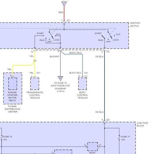

Is this fuse #8 in the PDC located under the hood at the left front fender panel?
If so, exactly where is the ignition key position at when the fuse blows?
I see three things that fuse powers, the starter relay, the fuel pump relay and the ignition switch. So remove the fuel pump relay and the starter relay and then see if that fuse still blows when you turn the key to that position. If it still blows the fuse, then it must be with whatever the ignition switch feeds.

The exact key position is in the start position. Thing are fine when key is switched from off to on, dash lights up and all icons, as soon as key is switched to crank engine fuse blows. The other night when this first happened it had been raining while the car was being driven then shut off and parked for about three hours. I left the car sit in parking lot till morning, then went back to try to start it again. The overnight temp dropped from forty degrees down to eighteen degrees by morning. After blowing five fuses, it started. I drove it to my heated garage to try to trouble shoot the problem. I am thinking maybe something was wet, because I cannot get it to blow a fuse. Not sure where to look, probable it will happen again if water gets back into the mix. So far you have been a great help, cleared up some misconceptions I had. I will monitor this as time goes. I welcome any advise. Thanks again!
