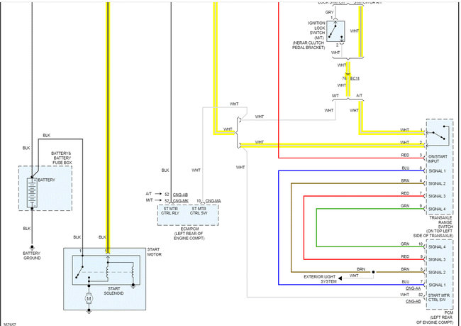

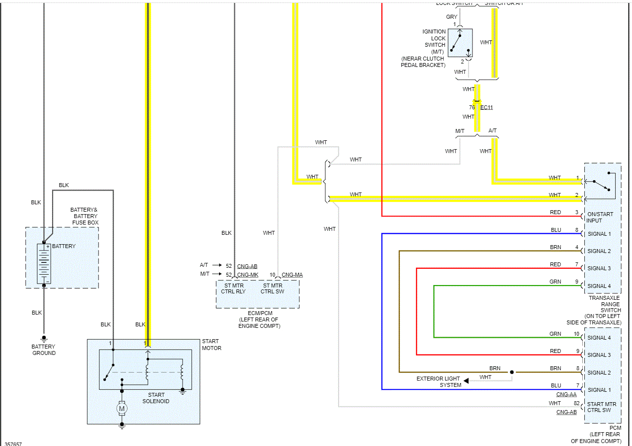

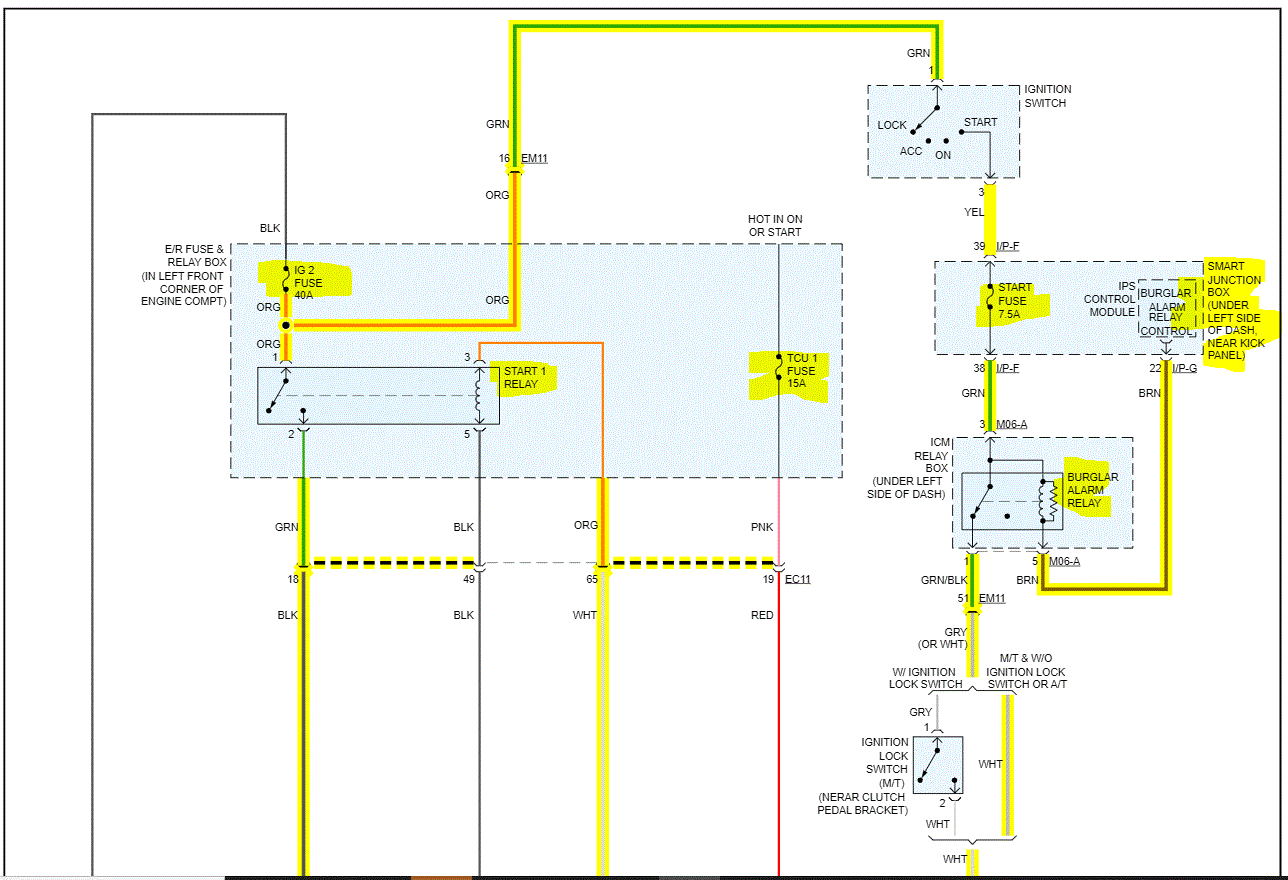

I attached the wiring schematic below for the starting system for your reference. I'm not sure if it has a smart key or not, so I went with "not". If that's wrong, let me know.
Now, since everything is new, are you certain the engine isn't locked up, preventing the starter from turning it? If you have checked and it turns, we need to next confirm all connections are tight, clean, and free of corrosion. Although the battery is new, please confirm it is fully charged and the connections to it are clean and tight.
Take a look through this link. It describes exactly what you described and what to check for.

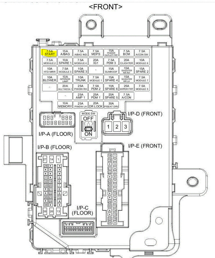

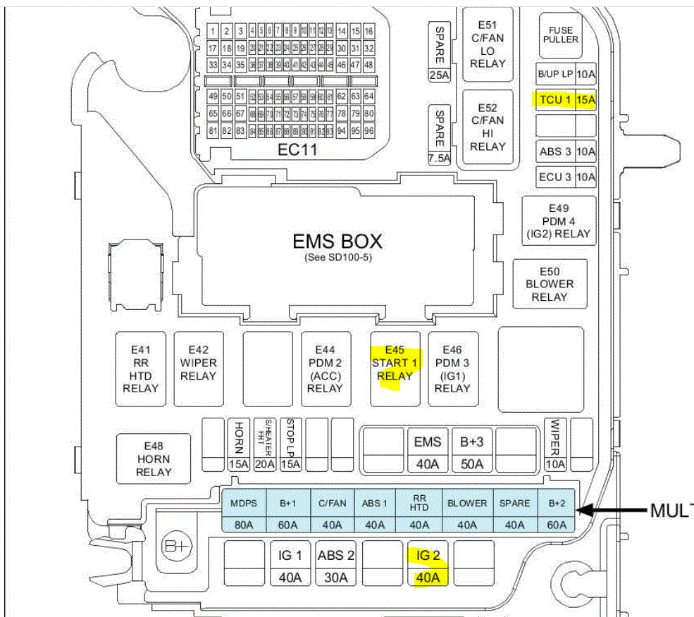

Next, I attached the wiring schematic below and highlighted fuses and relays to check. As far as the click you hear, is it in the vehicle or under the hood? There are two different relays related to the starting system and they are at different locations.
When you check the fuses identified, first, confirm the fuse itself is good. I suspect you already did that. However, if the fuse is good, you should also confirm there is power to and from it. Here is a link you may find helpful:
Next, if all fuses are good, confirm both relays are good. If there is a different relay with the same part number in the box, switch them to see if it makes a difference. If there isn't, here is a link that explains how to test one:
See pics below. Note: I had to cut the schematic in half to make it readable for you. I did overlap the two pics so you can follow from one to the next. Also, I attached pics of the fuse boxes and fuse locations.

So far, the 7.5 fuse is new and getting power. The clicking/ticking nose is in the fuse box under the hood. I moved the starter relay and put a different relay in place of the start relay. No difference the ticking stops when you remove the ECU fuse.

Has the battery terminal that was loose been taken care of? Also, at the starter, you have two primary wires to worry about. One is straight from the battery and will have 12v at all times and will be a much heavier gauge wire than the other. There will be a smaller wire that is the trigger wire. It is smaller in diameter and only receives 12v when the key is in the start position.
According to the wiring schematic, both wires at the starter will be black (which is odd). Locate the larger one and confirm 12v at all times. Then check the other with the key in the start position. Here is a link you may find helpful:

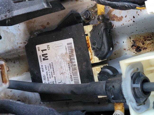

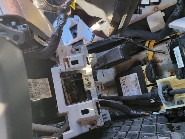

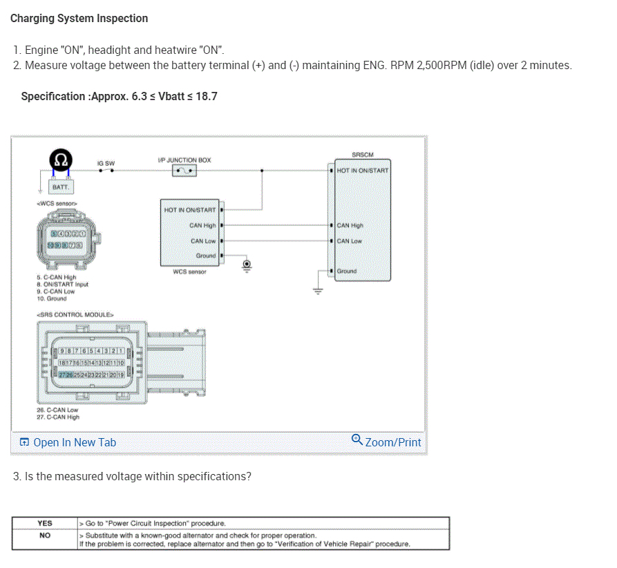

The battery terminal has been taken care of, but still no start. We've taken apart the center console to get to the body control module and we found this in the pictures I've uploaded. Looks like soda or something blew up and got all over inside. Secondly, we got it to crank once but lost complete power. We had a chance to do it again but again lost power and couldn't repeat the process. The lights stopped flickering on the dashboard until we tried to start it (the two times we got it to crank) still ticking in the fuse box. Lights flickering, the minute we push in the brake pedal the dash goes off and voltage drops to 0. After we couldn't get it to repeat those 2 times it started to read 6 volts. Couldn't get it to power up to 12 again. On my scanner it keeps bringing up B1112 and B1111 and cam time out codes. The body control module came up faulty until we cleared it and never came back up on the scanner. The code P0625 came up, as well as the airbag SRS was on the scanner. That's why I asked if a bad airbag crash sensor would cause a vehicle not to start. It has not been an accident at all. She went somewhere the day before, drove fine, the next day it would not start. Replaced the starter, alternator, battery, fuses are okay, the relays.
Sunday, January 30th, 2022 AT 8:19 PM
  • 110,194 POSTS

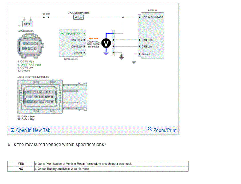

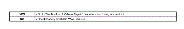

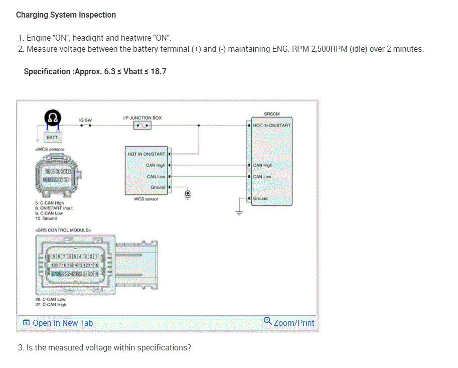

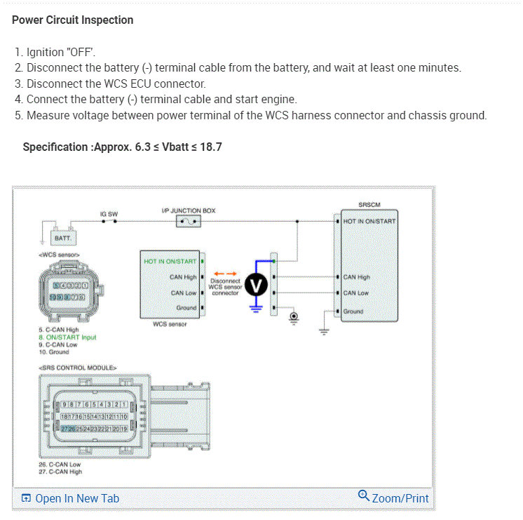

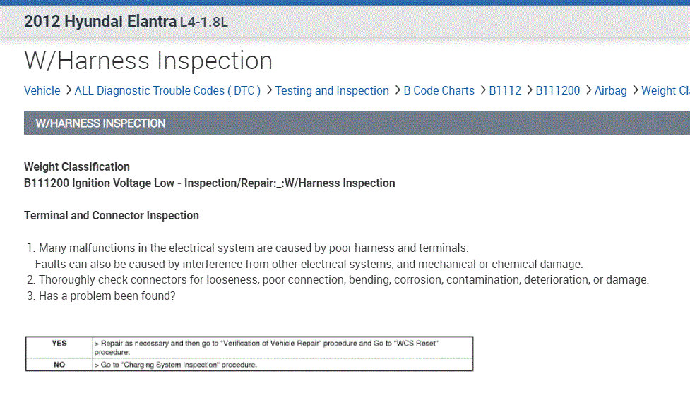

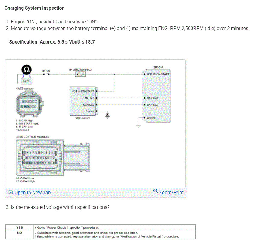

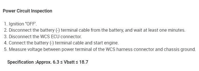

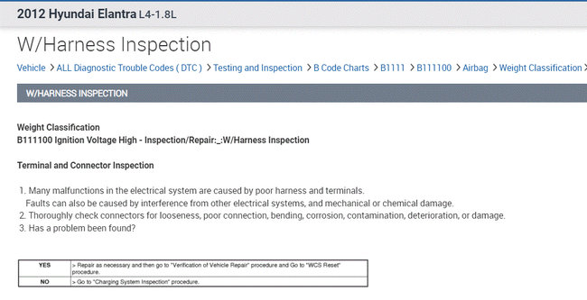

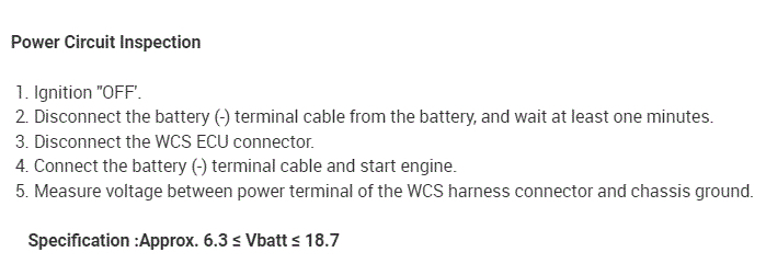

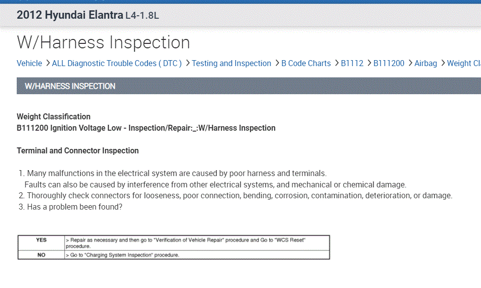

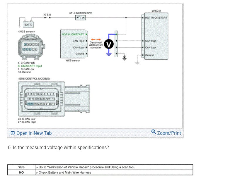

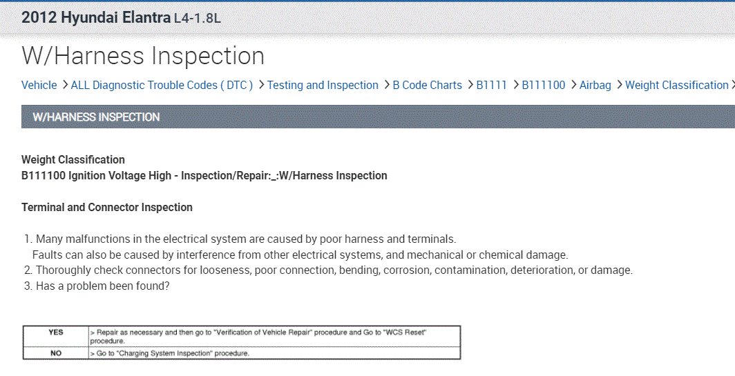

Looking at the codes P1111 and 1112, we have a connection issue. Interestingly, the two codes are opposites.
Do me a favor. Take a look through the diagnostics below and let me know if you are comfortable doing it. Personally, I would start with 1112, but that's your call. It starts at pic 5.
