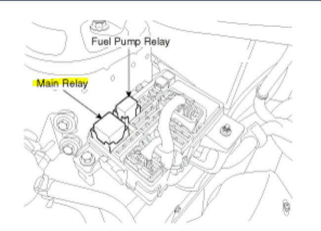

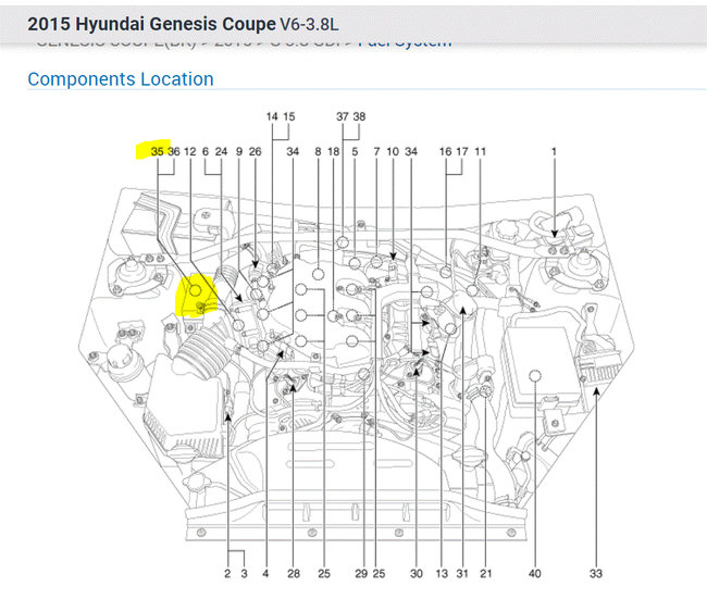

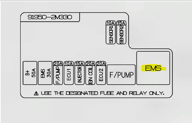

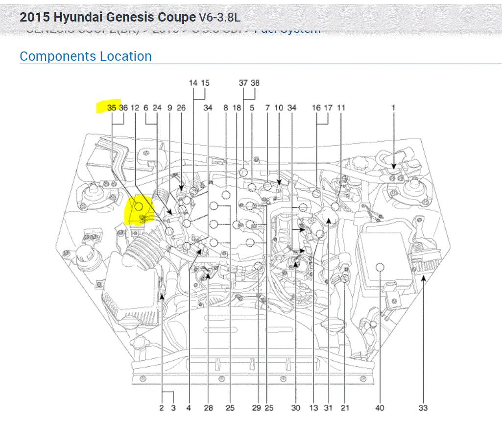

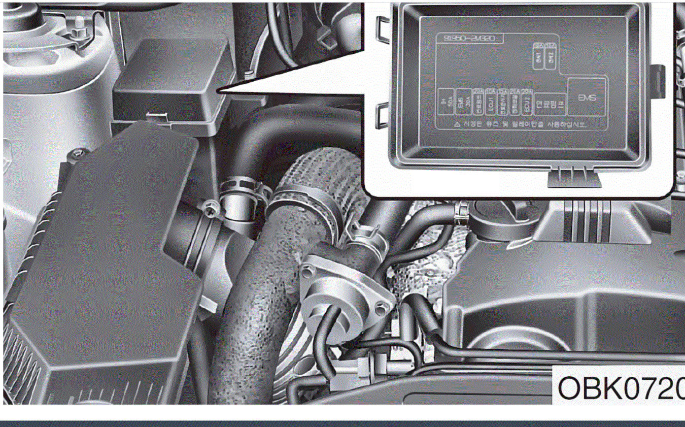

If you are seeing the tachometer move, then the crankshaft position sensor is likely working. It sounds like you are getting spark when the key is in the start position and then lose it when you turn the key to run. It could be related to the engine management system relay (main relay).
Take a look below. I attached two pics, The first is the relay location and the second is the location of the EMS relay. Remove that relay and check it. Here is a link that shows how to test the relay:
If it checks good, on each coil pack, there will be a pink wire. Disconnect one of the connectors, turn the key to the run position, and there should be power to the pink wire on all coils. A ground path is provided via the PCM when the coil should engage.
Here is a link that you may find helpful:
Let me know what you find. If the EMS relay is good and there is no power to the coils and all fuses are good, we have to move to the ignition switch.

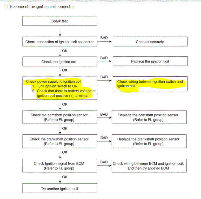

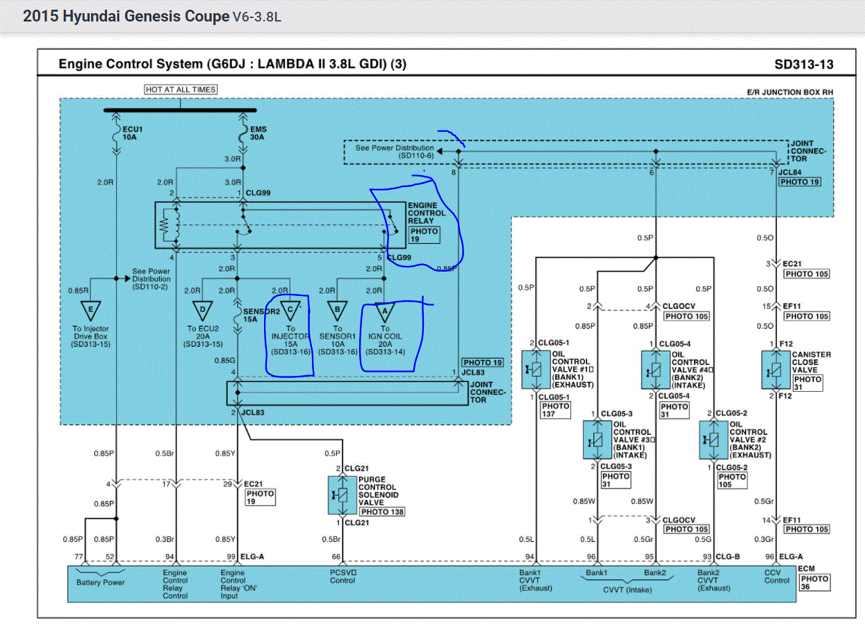

Were you able to confirm if there is power to the coils with the key in the run position? Take a look at pic 1 below. I highlighted where I feel we are at this point. If there is power, then we need to inspect the cam and crank sensor. If there is no power, then we need to check the wiring between the ignition (push button) and the coils. Just fyi, the powertrain management schematics are 7 pages long. Ugh. LOL
See pic below.

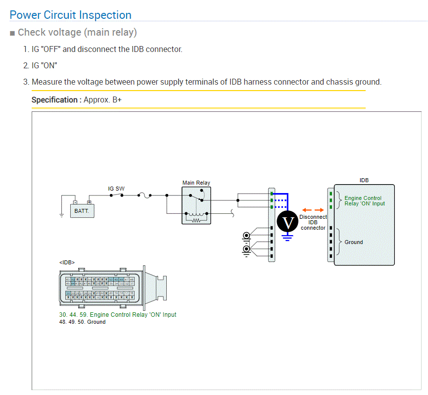

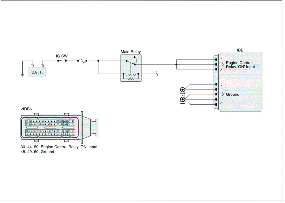

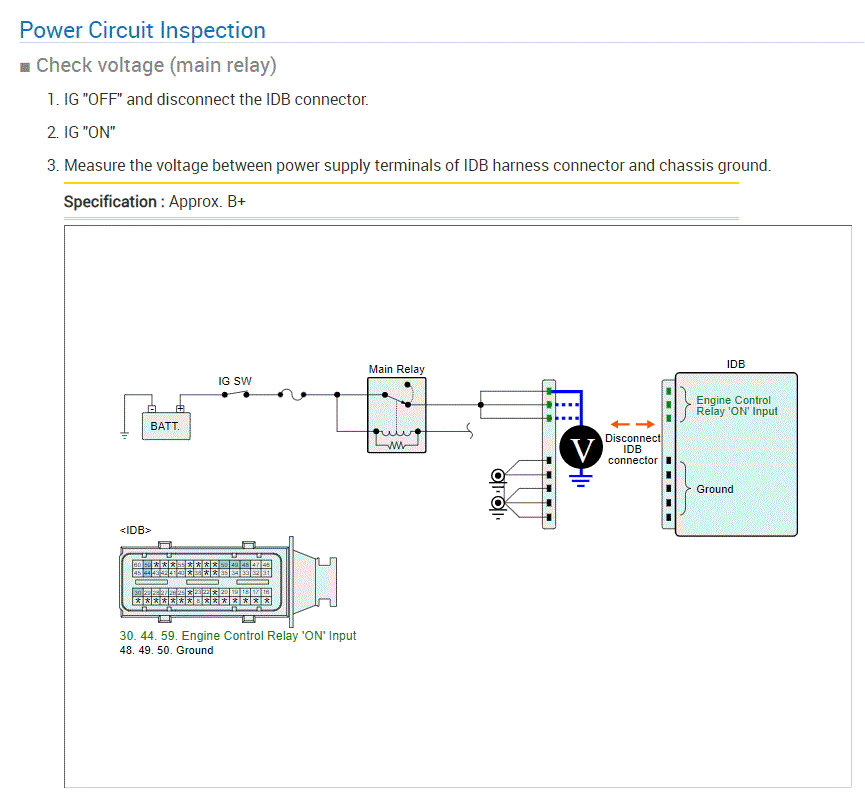

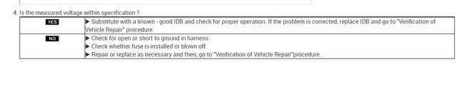

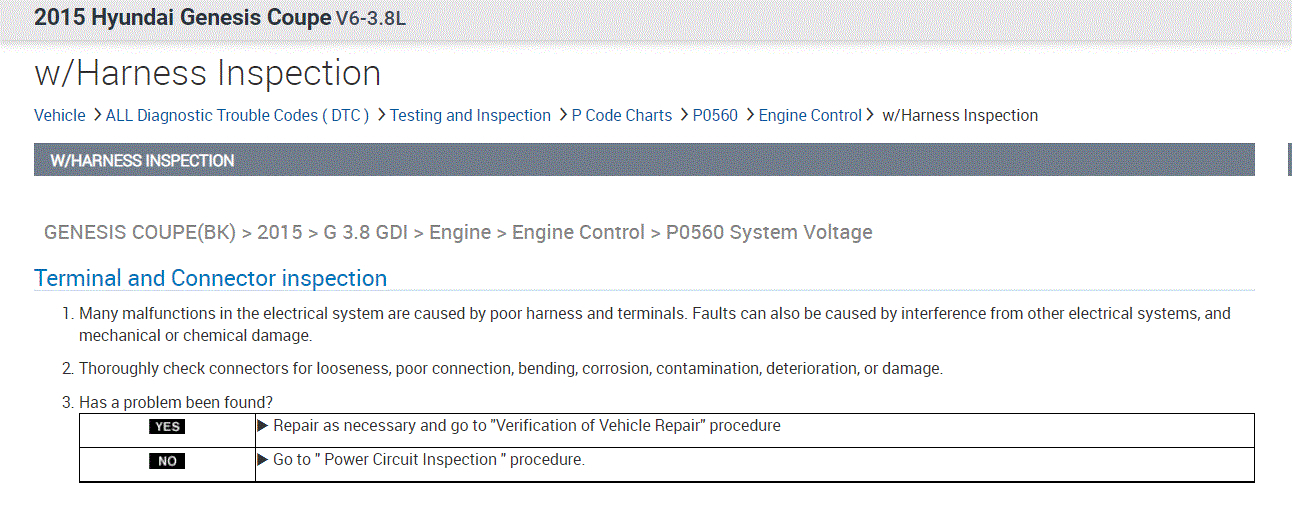

The compression sounds fine. I looked back at the code you provided (P0560). Since we know there is an issue there, let's start by checking.
The code leads us to the IDB (injector drive box). This also takes us back to the main relay I previously mentioned.
Take a look at the attachments below. That is the test procedure for the code. Let me know what you find.
Also, the voltages you mentioned above sound fine.
+1
Tuesday, July 20th, 2021 AT 8:36 PM
SWILSON3828
  • 112 POSTS
Thank you again. I did verify ground to Pins #48, #49, #50 on the injector distribution box connection, and also verified voltage on pins #30, #44, #59. All three between 2.4v and 2.6 v.

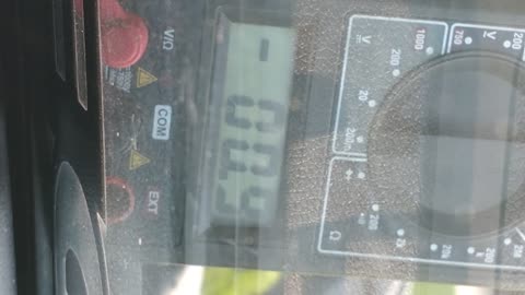

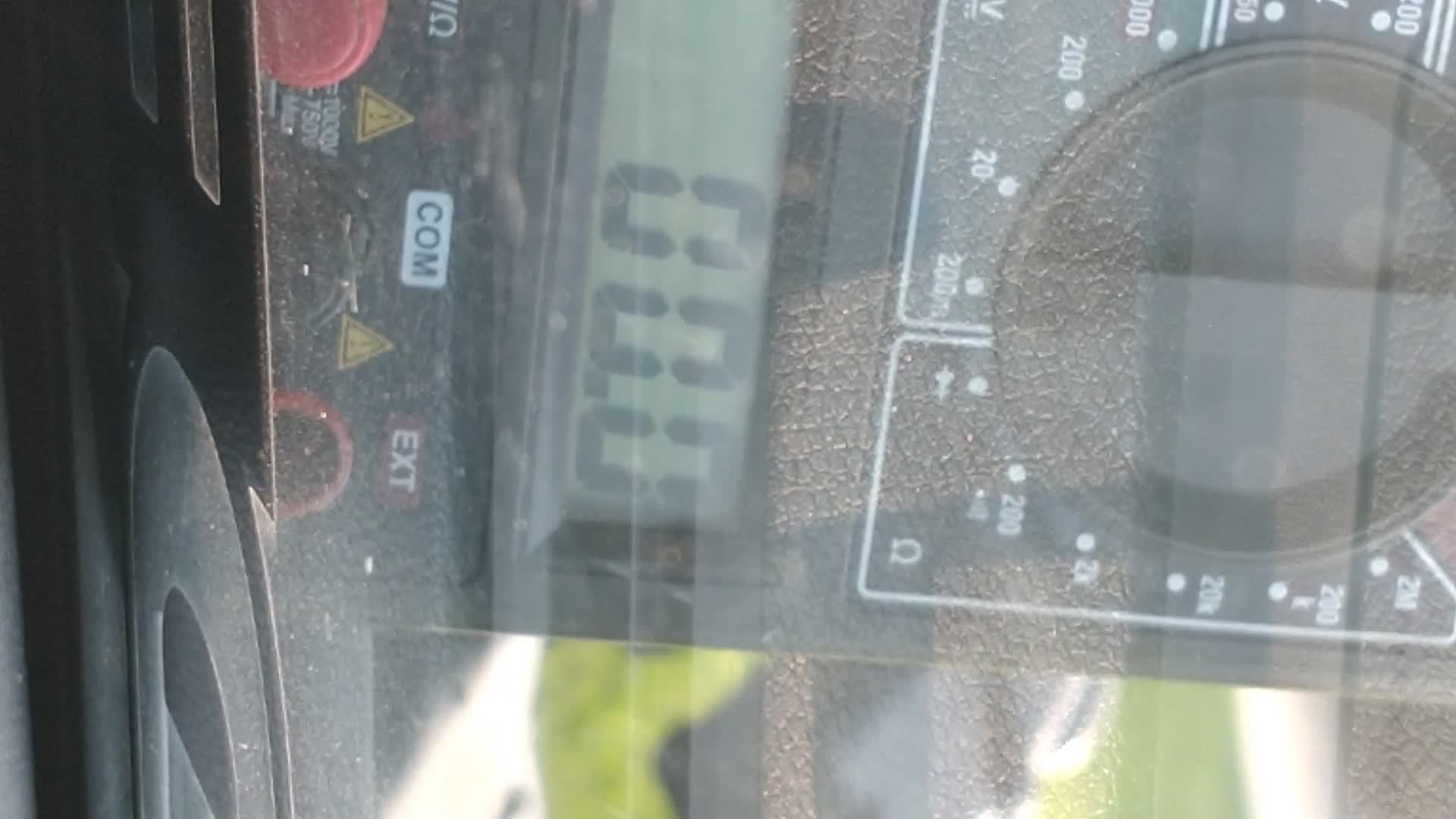

I do not have access to live data but I did use some alligator clips and a multimeter to verify the crank was putting out a pulsating voltage when the engine was being cranked. I will include the video of the readout. Although the pins on the injector control box checked out properly per your information I'm not sure if the signal is getting to the injectors. I'm also questioning the fuel pressure regulator within the fuel pump unit. If i'm not mIstaken the FPR regulates the fuel pressure based on the pressure in the intake manifold so as to create the proper fuel/air mixture? Also, I do need to include that I rarely hear the fuel pump prime when the ignition is turned on. And I can definitely hear it as I can hear it running from the outside of the car when I have jumped the fuel pressure relay. I may hear it prime one time out of every twenty or thirty crank/start/shuts off cycles. Then again this pump might be the type that doesn't prime but only pumps fuel when the motor is actually cranking. Thanks
Wednesday, July 21st, 2021 AT 10:07 PM
  • 110,194 POSTS
You made a good point with the injectors. Have you checked for a pulse at them? If you haven't, take a look through this link and check for a pulse. The link explains how to test them.
https://www.2carpros.com/articles/how-to-test-a-fuel-injector
All you really need is a test light. Let me know what you find.

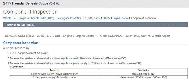

  • 110,194 POSTS

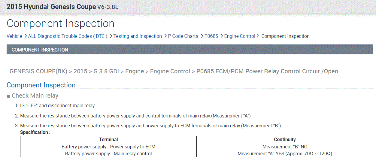

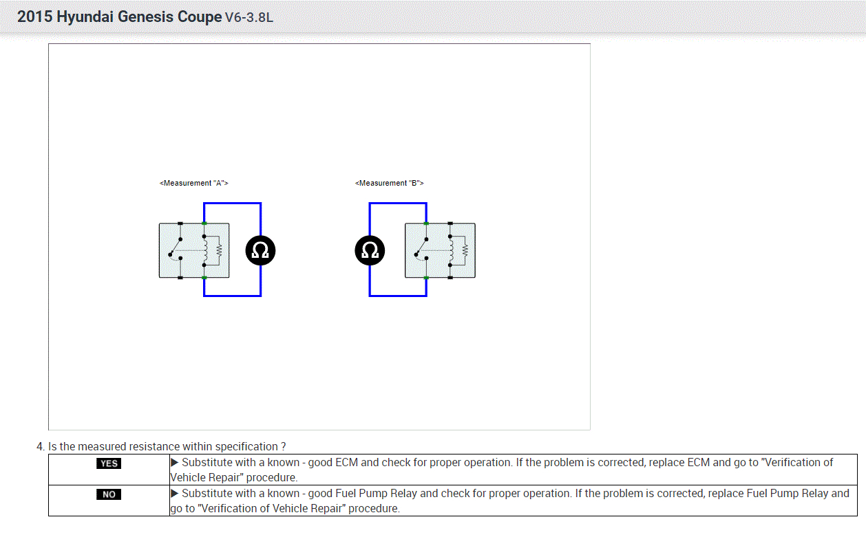

The code you have is for the power relay "open". Basically, that indicates there is a broken wire or one that isn't connecting for some reason.
Pics 1 and 2 below show the location. The remaining pics are test procedures for this code.
Let me know if this helps.

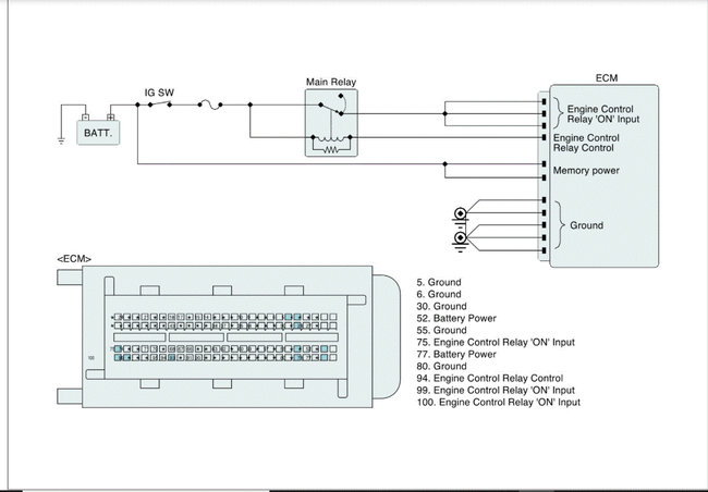

Greetings,
I checked the ECM harness per the information above and this is what I came up with, and these readings on the positive points are with the ignition in the "on" position
#'s 5, 6, 30, 55, 80 (Grounds) all measured 5.2 Ohms
#52 Battery 12.26 volts
#75 ECR Relay "on" input .87 volts
#77 Battery 12.26 volts
#94 ECR control 12.25 volts
#99 ECR "on" input .87 volts
#100 ECR "on" input.87 volts
. So it appears the ECR main relay is only transferring.87 to the to the ECR "on" inputs when energized.

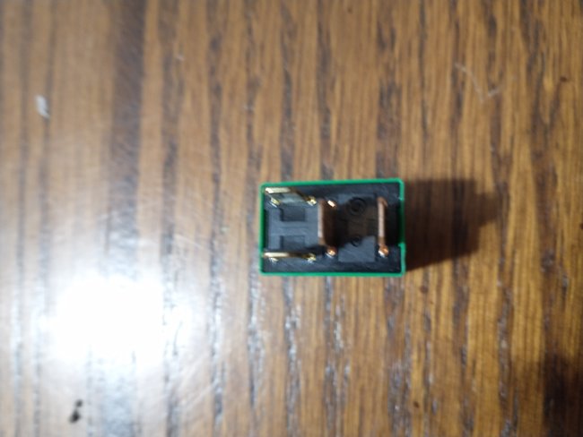

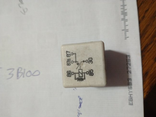

I am a bit confused on testing the ECR per instructions as on the diagram page that shows measurements A and B it mentions if "no" then replace with a known good fuel pump relay, so I tested both of the relays per the instructions. Unfortunately the fuel pump relay doesn't have a schematic diagram on it like the ECR does
For the ECR the control pins (85 & 86) are showing 16.2 ohms and the load pins (87a and 30) are showing infinity. With the ignition off there is a constant voltage at both pins 86 and 30.
The FPR the control pins ( the darker bronze pins on the picture) are showing 88 ohms and the load pins (the two lighter gold colored pins) are showing infinity. The only pin on the FPR that has a constant voltage with the ignition off is the bronze pin furthest right. Also, and finally I was unable to locate a ground on the ECR connection at the fuse box with the ignition on or off. My apologies again for the length and thank you
Saturday, July 24th, 2021 AT 8:44 PM
  • 110,194 POSTS
It sounds like the ECR relay is bad. As far as the fuel pump relay, are there any markings on the bottom of the relay?
Take a look through this link and see if anything helps:

Goodness, it ended up being a loose female terminal connection for one of the switch pins for the ECM. I put a new ECM in and checked the power and grounds for the ECU and they were showing the same as they were with the old ECM with several showing.86 volts, so I decided to get a read at the terminal itself so I shaved a wired and jammed it into the terminal with the switch pin of the ECM and it went from.86 volts to 12.4 volts and heard the fuel pump priming too when I opened the door. Car started right up and idled good. Drove it around for a bit and it did fine! Still curious why I could never find a ground at the ECM, but I'm not going to complain. I'm sort of scared to remove the wire though, lol. Thank you so much for your help and all of the information. Would have never been able to find the issue without it Thank you!
