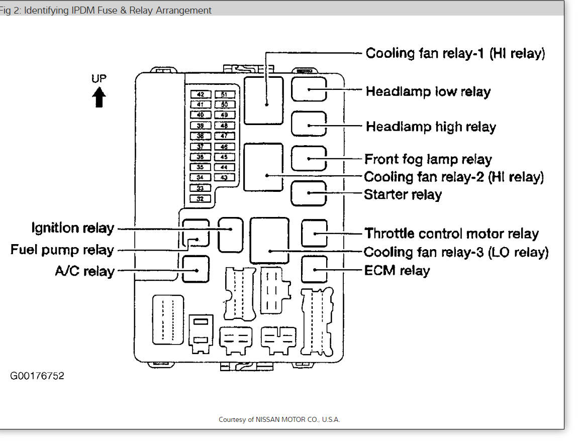

It stalls while driving, reverse or just idle. Just replaced all coils plugs and valve gaskets, crankshaft sensor and cam sensor, also just replaced O2 sensors up steam and down stream. Also cleaned the throttle body and MAF sensor, still having the same stalls problem. Can anybody help with the problem?

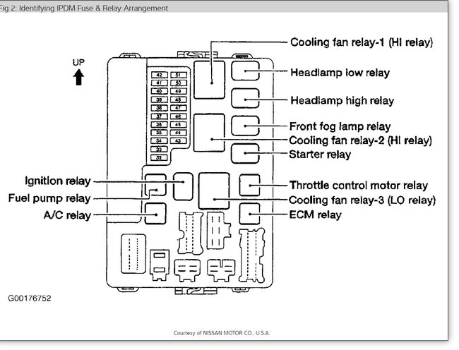

It sounds like the ECM relay is going out but to be sure lets run down this guide to test the relay, here is the location of the relay below.
and
