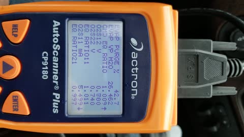

Did you see the video I sent you of the o2 sensor fluctuating? This only happens after the trucks overnight. Once it has warmed up it seems to be fine for the rest of the day.
Tuesday, April 21st, 2020 AT 11:56 AM
  • 52,797 POSTS
Sorry, could barely see the scan tool and could not see any information at all.
Tuesday, April 21st, 2020 AT 12:10 PM

The man's were jumping from.625 to 253.457.
Tuesday, April 21st, 2020 AT 12:39 PM
MRT1963
  • 28 POSTS
I resent video.
Tuesday, April 21st, 2020 AT 12:40 PM
MRT1963
  • 28 POSTS
I meant Ma's were fluctuating.
Tuesday, April 21st, 2020 AT 12:41 PM
  • 52,797 POSTS
That was the same video that I cannot see any readings at all.
What were the voltages? That is what I requested from you 2 times.
I need all the readings not just the O2 sensor readings.
Tuesday, April 21st, 2020 AT 12:43 PM
MRT1963
  • 28 POSTS
Lower o2 sensor volts.805 to o2s12.090 o2s22.165then both back to.835. O2s11 ma 26.497 o2s12 ma 61.486 jumping to o2s11 ma 250.480 and o2s11 251.479. One if the uppers will be 246.480 and the other will be 2.499.

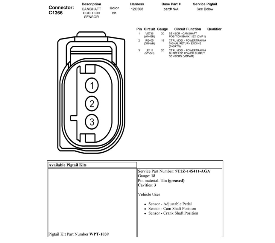

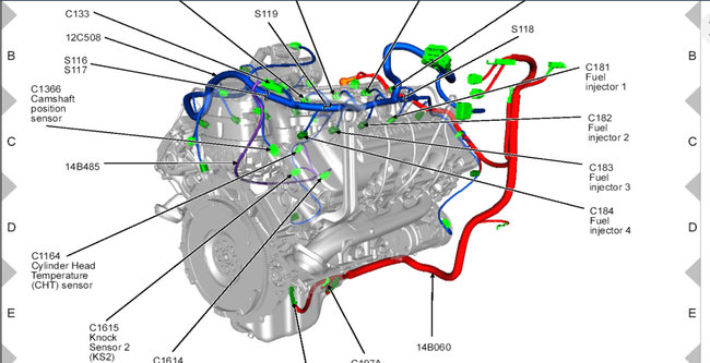

  • 52,797 POSTS
A cam sensor dropping out will cause this issue.
You need to go to the connector on each side and verify 5 volt reference and the signal voltage.
Monday, November 23rd, 2020 AT 1:48 PM
MRT1963
  • 28 POSTS
If I keep my foot on the gas pedal it will stay running it is only at idle the RPM's drop. It's like it was shut off. We will check the wiring. Thank you.
