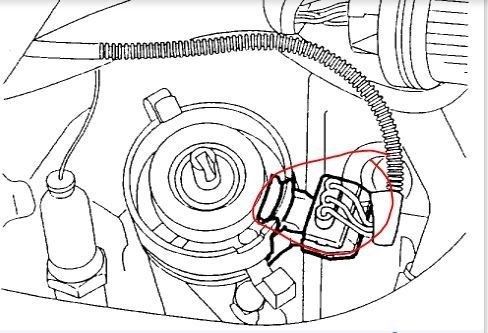

Shuts off after driving fifteen to twenty minutes

Will only come back on after it cools. No relative code.

What you described sounds like a bad camshaft position sensor. When the start going bad, heat causes them to short internally. The camshaft position sensor on this vehicle is located in the distributor. See picture 1
Now, before we can conclude what is happening, I need to know if spark is lost to the plugs when the engine stalls and won't start. Here is a link that shows how it's done:
If you find there is spark and the vehicle won't start, see if it will start for a couple seconds using starting fluid. If it does, then the problem is fuel related.
Let me know what you find.
