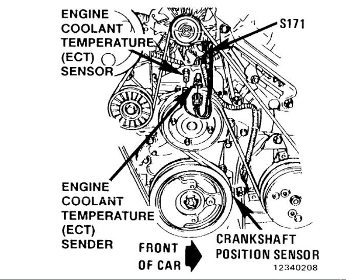

When I come to a stop, it constantly stalls, but will start right up. When I am driving it seems to sputter.

Good morning,
Here are a few guides that will help with this issue as I suspect we have an issue with fuel pressure.
If the fuel pressure checks out then here are some more general guides that will cover this issue.
https://www.2carpros.com/articles/engine-stalls
If it does, it could be the crank sensor signal dropping out at idle and while moving.
I attached a picture of the location of the sensor for you.
Let me know if you have any other questions.
