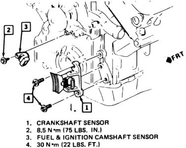

Oh yeah I do have spark, I used a screwdriver to test it. But I noticed that when I have the throttle wide open when I crank the engine the air intake tube right at the throttle body seems to expand like a balloon. I was told by my uncle that the timing could be screwed up. I found that you cant adjust timing on these cars and that its computer controlled. So now im thinking that it could be the crankshaft position sensor.

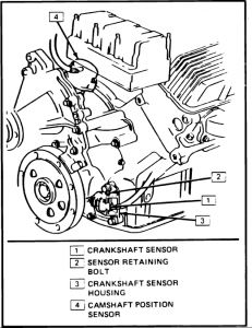

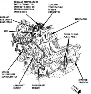

Hello
Here is the info on the Crank Sensor
http://www.2carpros.com/forum/automotive_pictures/248015_1_30.jpg
http://www.2carpros.com/forum/automotive_pictures/248015_2_22.jpg
http://www.2carpros.com/forum/automotive_pictures/248015_3_19.jpg
Disconnect battery ground cable, then remove sensor 3-way connector.
Raise and support vehicle.
Rotate harmonic balancer so slot in disc is aligned with sensor, Figs. 30 and 31.
Loosen sensor attaching bolt, then slide sensor outboard and remove through notch in sensor housing.
Reverse procedure to install. Adjust sensor so that an equal clearance exists on both sides of disc (approximately .030 inch), then tighten attaching bolt and re-check clearance. Readjust as necessary.
