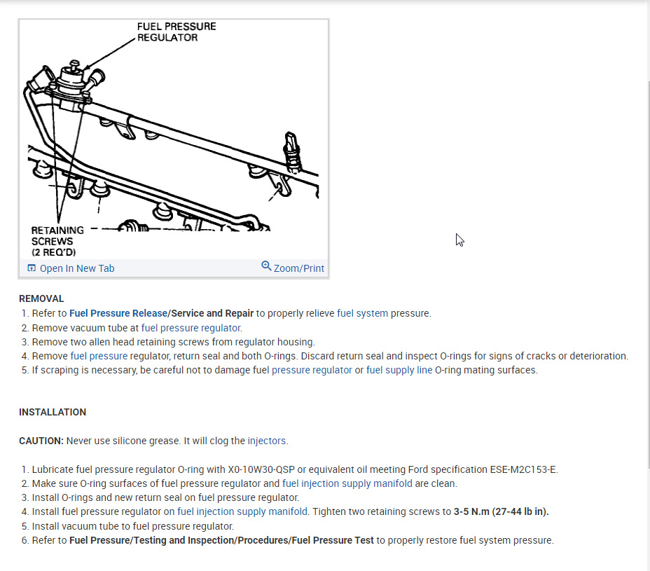

It is unlikely that this is an issue with the pressure regulator because that is on the fuel rail that is shared between tanks. So if the flow rate is changing between tanks then we could have an issue with the pump but we need to start with checking the pressure on both tanks. Here is a guide that will help with this:
Once we know what the pressure is, we can go from there but I suspect you will find the pressure is higher on the rear tank. You have an issue with the engine over fueling which is causing the stalling so if this is only on the rear tank then I suspect the pressure is high.

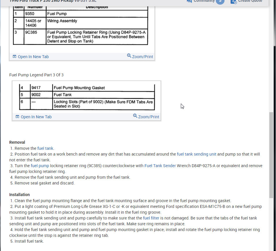

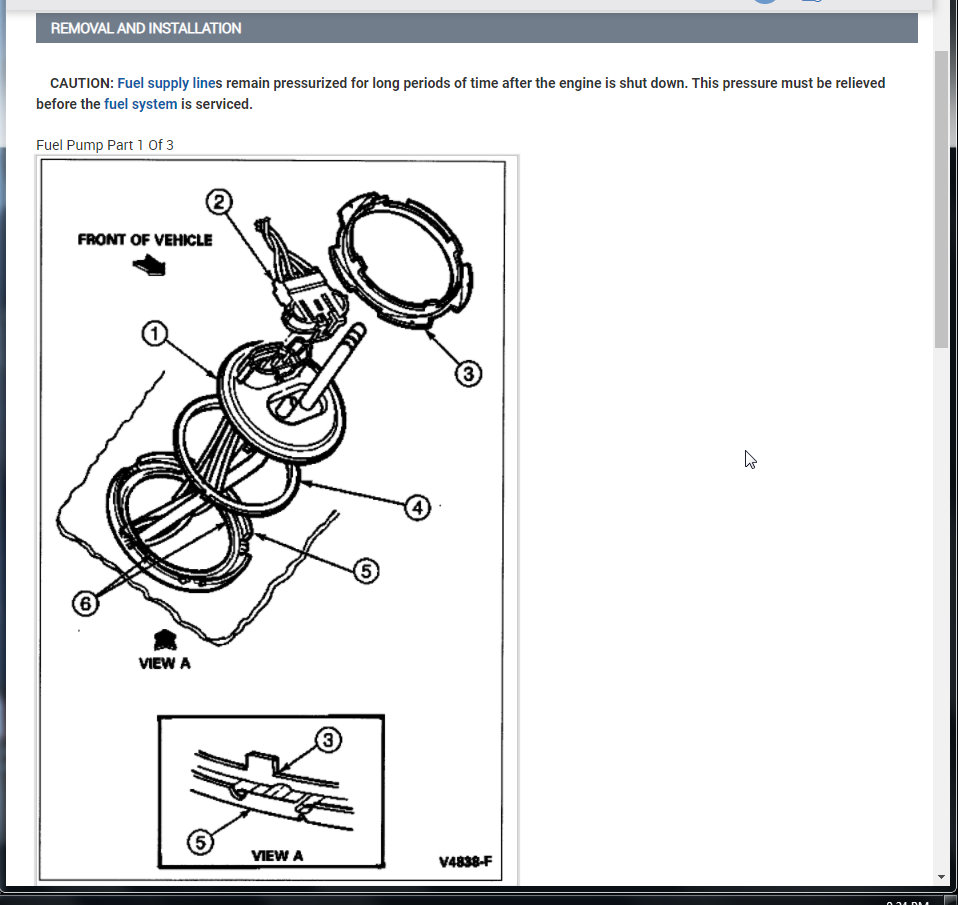

Also, I attached the process below on the pump replacement in case you need that as well. Thanks
