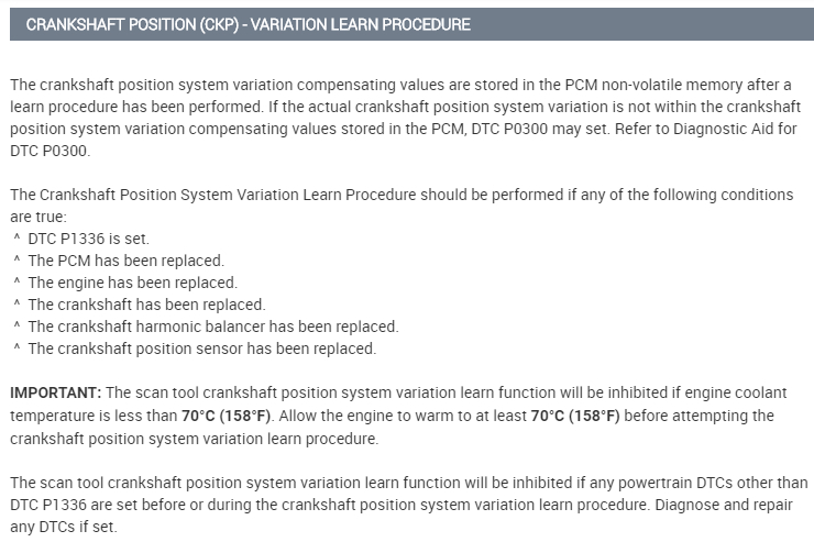

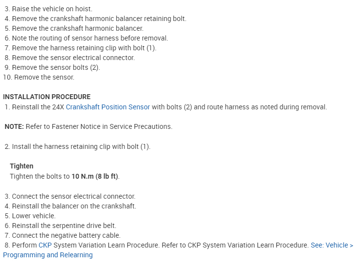

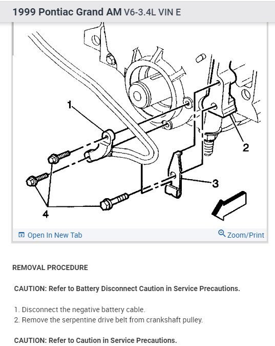

Engine runs great until gets warm then stalls while driving. I suspect crankshaft position sensor is bad or possibly really dirty, due to a previous water pump leak.
My main question is can this sensor be removed without pulling harmonic balancer?
Thanks
Sunday, March 29th, 2020 AT 6:58 PM
DANNY L
  • 5,648 POSTS
Hello, I'm Danny.
Unfortunately no. The balancer has to be removed. Here is a tutorial showing how to remove/replace:

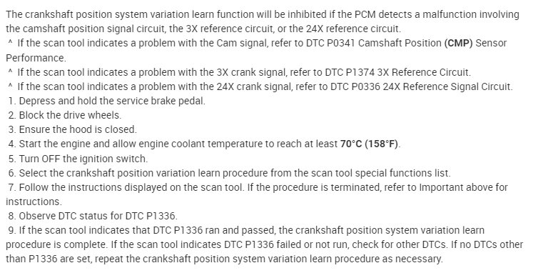

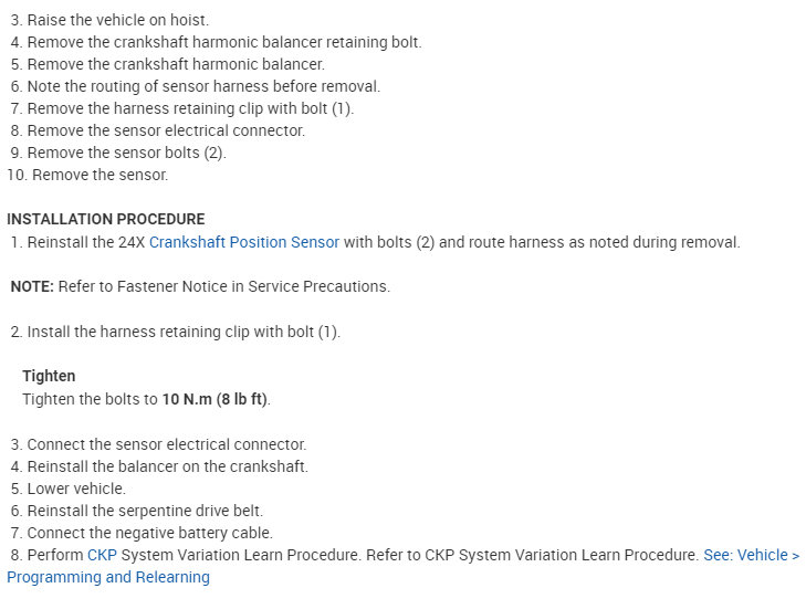

I've attached step-by-step replacement pictures below including the sensor relearn process for your Pontiac below.Hope this helps and thanks for using 2CarPros.
