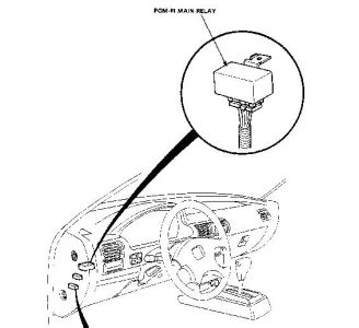

FRANCISCO84
  • 1990 HONDA ACCORD
  • 4 CYL
  • FWD
  • 170,000 MILES
When I let my sit for a period of time and I go to start it it wont start it turns like it wants to start but doesnt but when I spary start fuild in the intake it starts but dies my buddy was sparing it in while I turned the key and when it start spary until it kept running it started fine for two days and then I went to started it and it didnt start I changed the fuel filter but does same thing. Also I would be driving and it would die and I would let it sit for 10 to 15 mintues and then it would start again can you please help me figure out what the problem is thank you for your time
Wednesday, September 30th, 2020 AT 11:05 AM (Merged)
KHLOW2008
  • 41,814 POSTS
Hi francisco84,
Symptoms are consistnt with an intermittently failing PGM-FI main relay. When it fails, the fuel pump would not work.

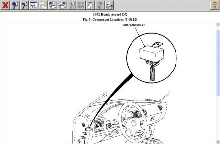

NEEDYDECATUR2
  • 1990 HONDA ACCORD
  • 4 CYL
  • 2WD
  • MANUAL
  • 20,000 MILES
Checked ignition seems to have spark(maybe not
enough?)
Is there anything else to check? I do not know if this car has a computer(it's my son's car) If it does, what
should I do to check it? Or is there anything I can do?
Please get back to me. When you can at;
ll1265@sbcglobal. Net
KHLOW2008
  • 41,814 POSTS
Hi needydecatur2,
When sparks are available, the next thing you should check is the fuel.
When ignition switch is turned on, listen for operations from the fuel pump. If none, you should check the PGM-FI main relay which is known to fail intermittently. Resolder the circuit board if you fins any cold solders.
