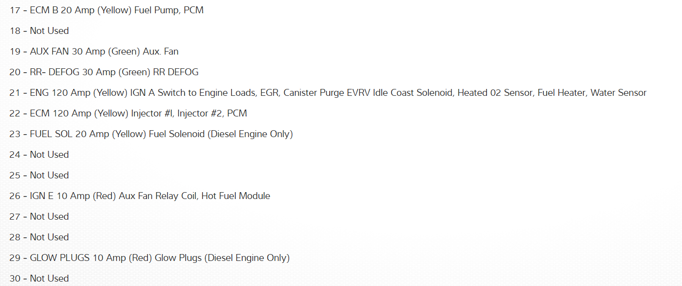

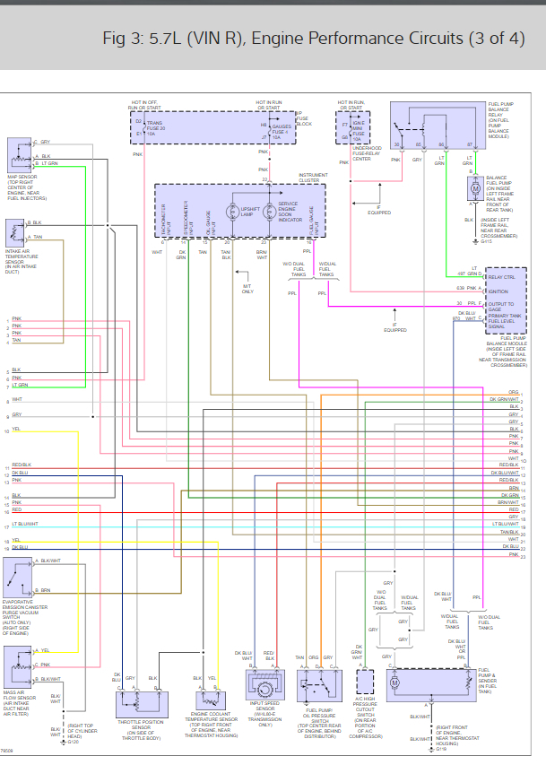

No speedometer, tachometer, or odometer but all other gauges working. Will not take off in first but can shift to first manually. Changed speed sensor on transfer case no change. Cluster looks fine when removed. Cannot find issue.

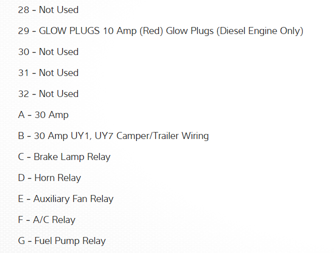

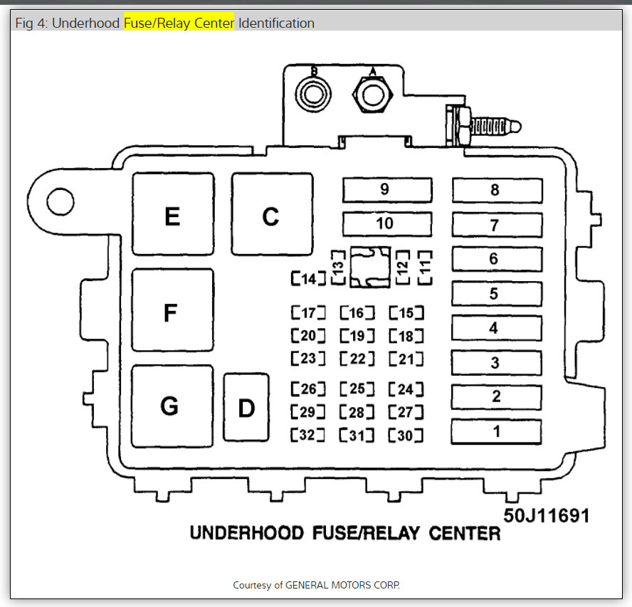

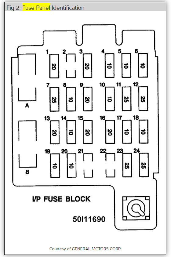

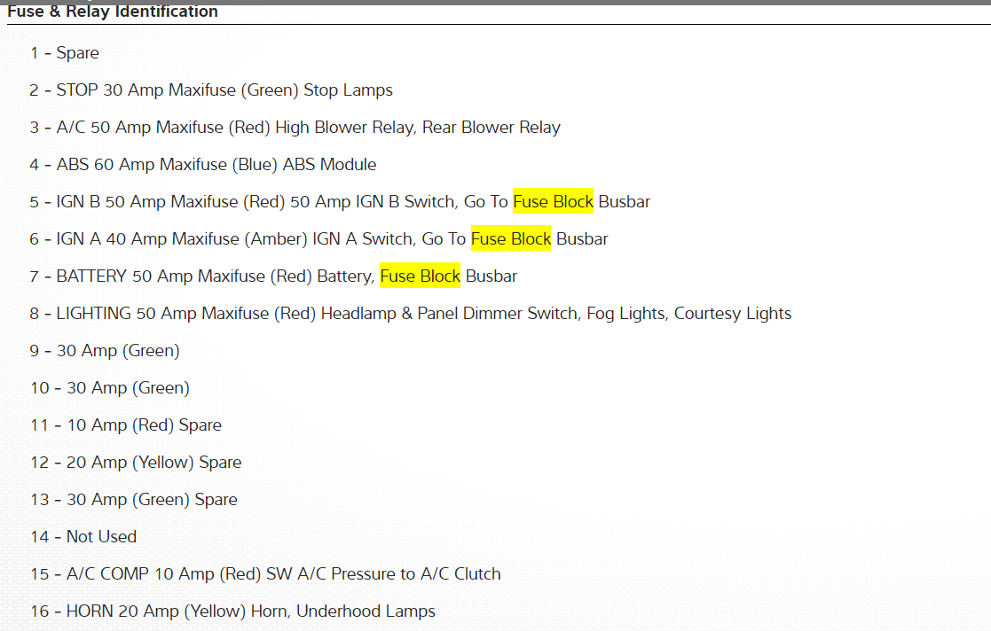

Can we run the codes to see what comes up? Here is a guide. Have you checked the fuses?

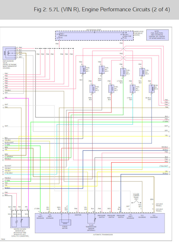

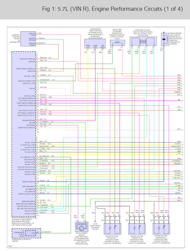

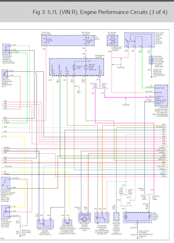

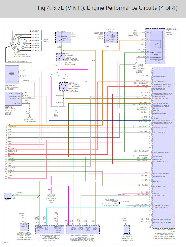

Checked all fuses and have already ran codes. Only codes throwing are o2 sensor, a misfire, and shift solenoid.
Apr 2, 2018 at 11:42 AM
  • 54,520 POSTS
Bad sign, it sounds like the PCM is no good or the cluster. but first lets do a wiring check before we change either out.
Check all power and grounds.
