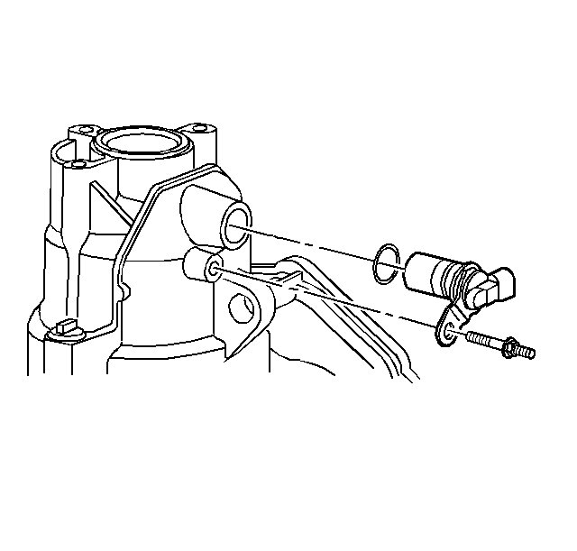

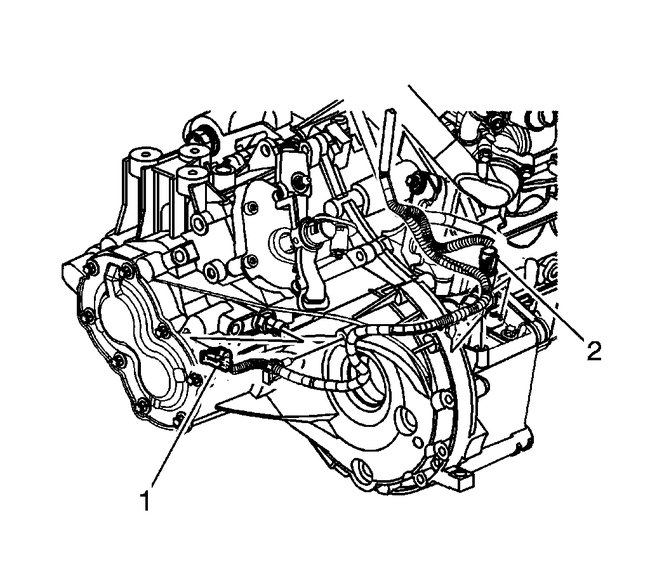

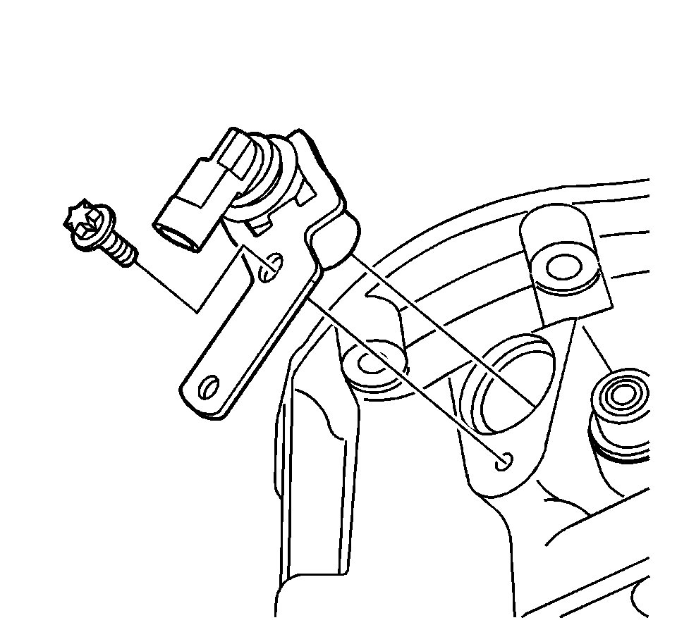

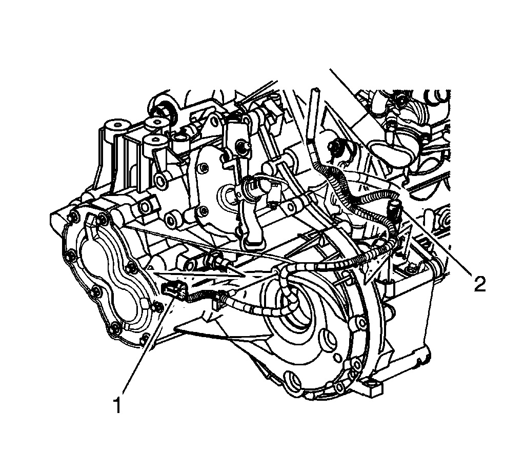

There are two different possible automatic transmissions used on this vehicle. I am going to provide the directions for replacing the VSS for both. You should be able to identify the transmission that matches yours by the pictures. All attached pictures correlate with the directions.
______________________
2005 Chevrolet Cobalt L4-2.2L VIN F
MU3
Procedures MU3
Vehicle Speed Sensor (VSS) Replacement
Removal Procedure
1. Remove the left front wheel.
Pic 1
2. Disconnect the vehicle speed sensor (VSS) electrical connector (2).
Pic 2

5. Remove the VSS.
6. Remove and discard the O-ring.
Installation Procedure
1. Lubricate a new O-ring with DEXRON III transmission fluid Saturn P/N 121019223.
2. Install the new O-ring.
Pic 3
3. Install the VSS retainer. Install the vehicle speed sensor (VSS) assembly.
4. Notice: Refer to Fastener Notice in Service Precautions.
Install the VSS retainer bolt.
Tighten the bolt to 9 Nm (80 inch lbs.).
Pic 4
5. Connect the VSS connector to the VSS (2).
6. Install the left front wheel.
