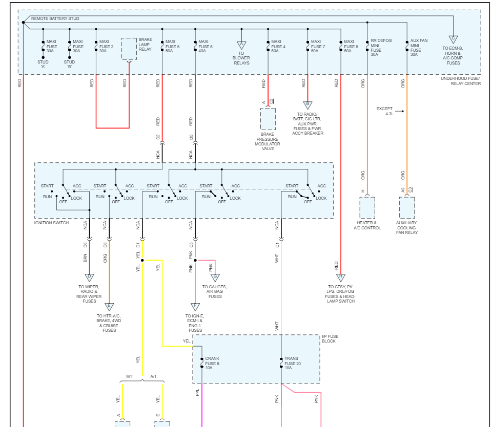

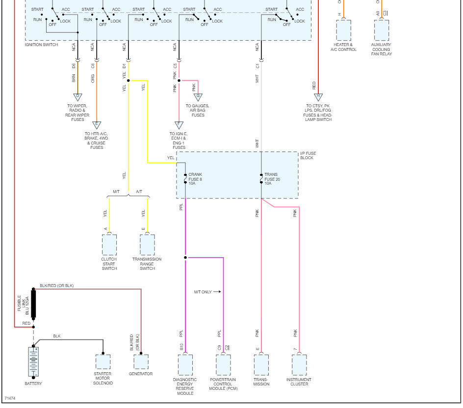

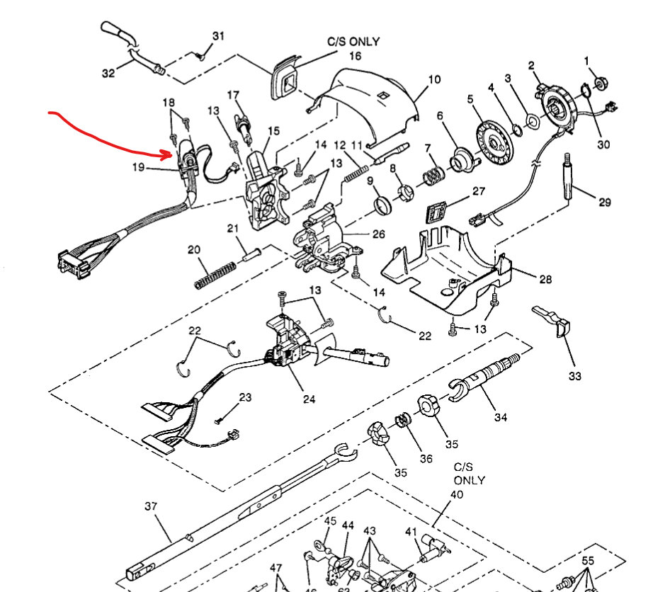

Was at a light pulling a trailer. A green light advanced into a left turn, truck shut off. Threw it into N tried rolling restart, cranked but no start. Rolled to a stop. Several more attempts to start, cranked like crazy but no start. Discovered blown fuse ign (I think) called rescue mom. Got chained out of there.
Upon much more invasive out checking found multiple fuses blown and one entire “bank”? With no power
Marked [fuel sol]. [ECM-1] [ENG-1] all connect by solid strip of copper under fuse box with pink wire attached that runs out of fuse box into the great unknown (wire harness)
I was doing pretty good chasing and learning to use the diagram when I noticed it was designated “VIN R”
My VIN has an S
Here we are.

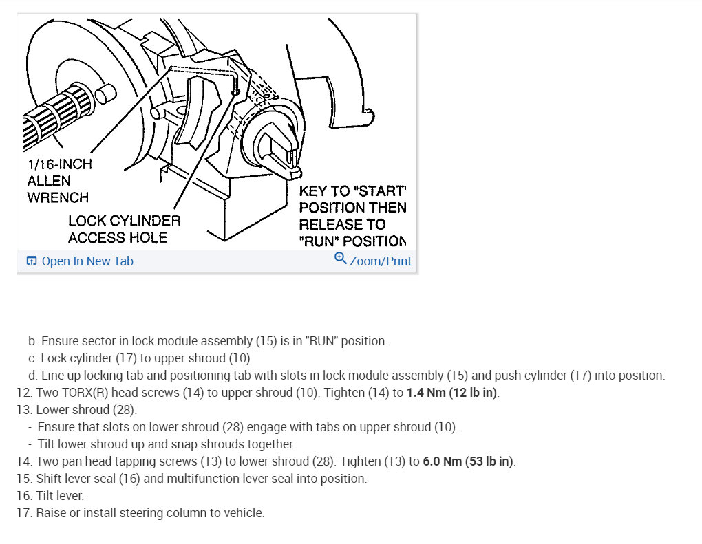

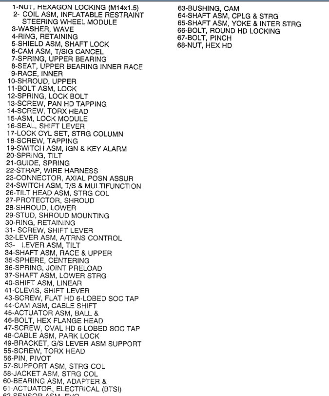

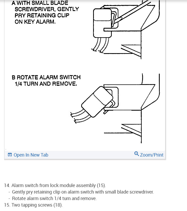

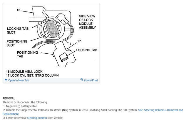

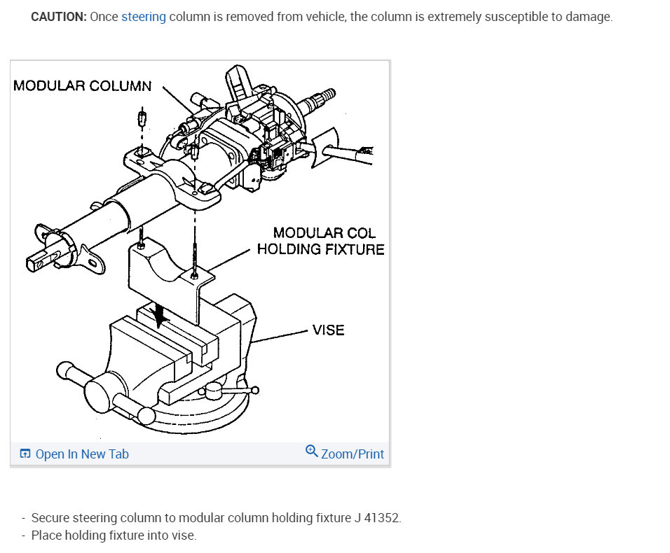

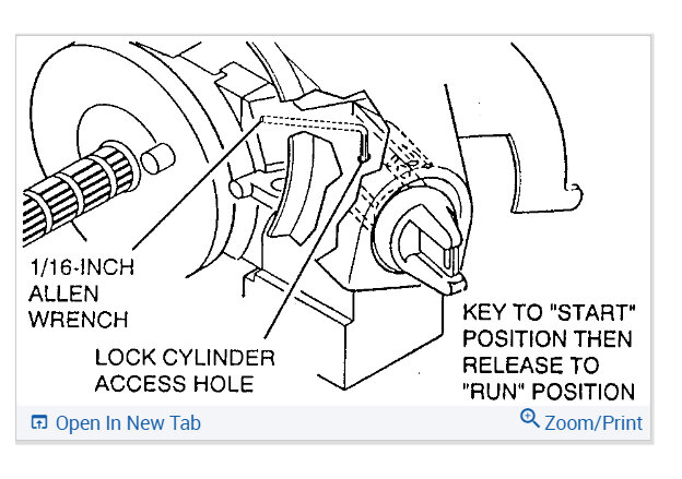

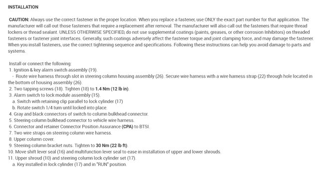

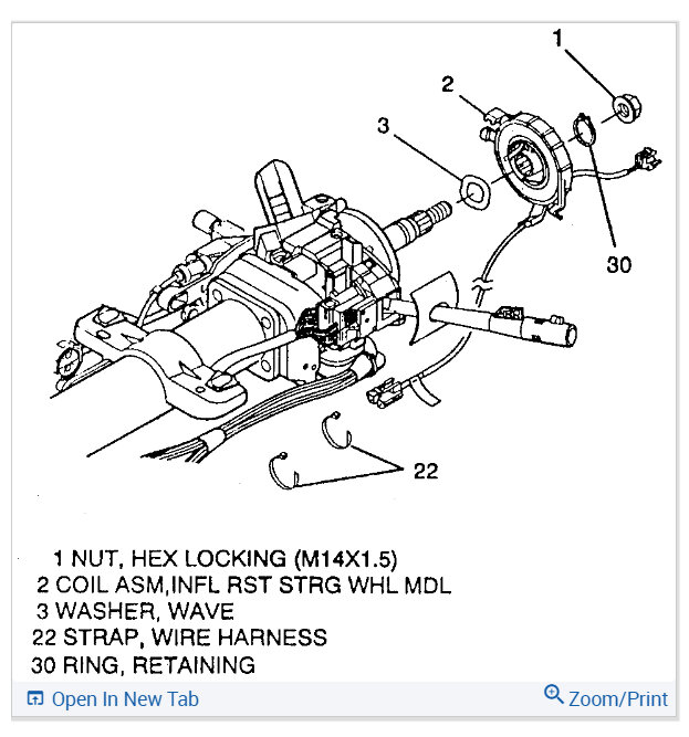

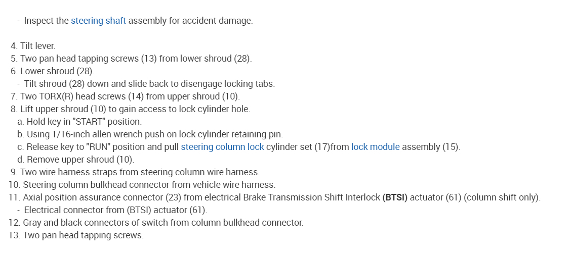

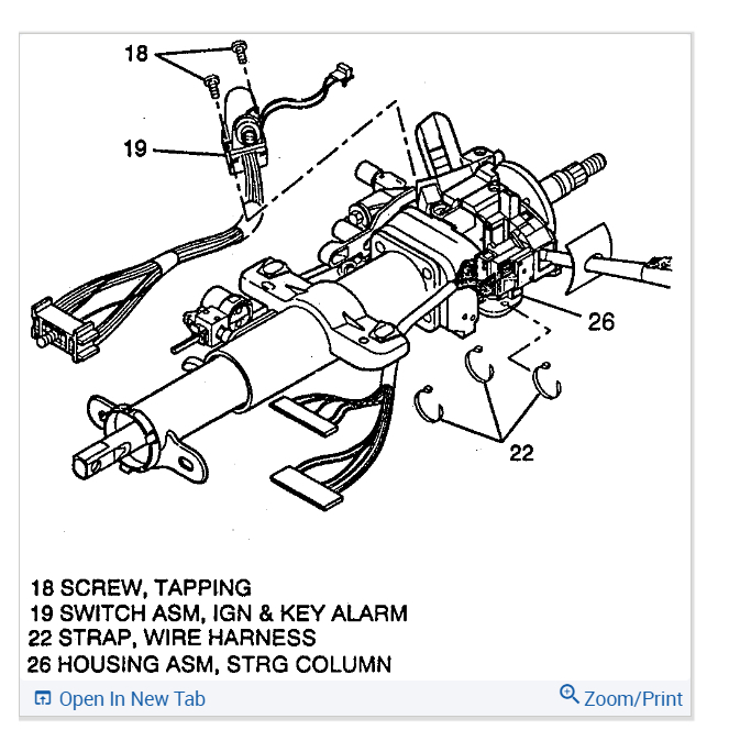

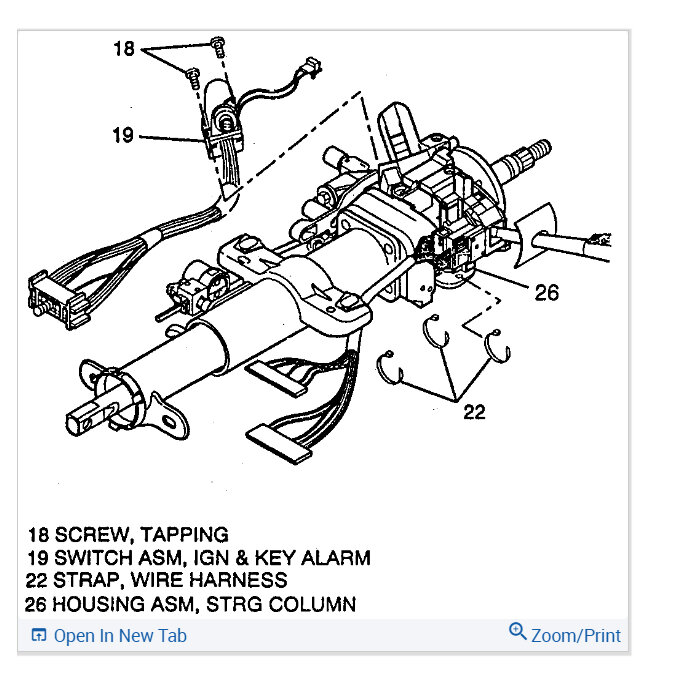

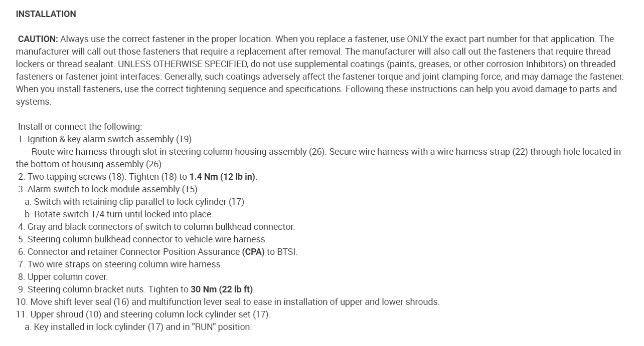

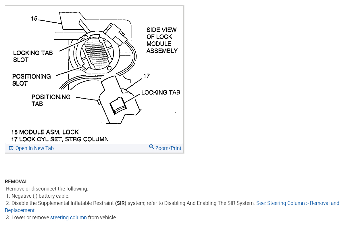

These are fed power by the ignition switch, good job finding out what fuses don't have power. To confirm the failure here is a guide to help and the ignitions witch wiring diagrams, test the switch with the ignition on:
Here is how to change out the ignition switch in case you need it. Check out the images (below). Let us know what happens and please upload pictures or videos of the problem so we can see what's going on.

I got the thing taken apart.
Realized I had it taken apart past what was necessary and tried to put it back a little bit. It was being uncooperative and I'm doing this in the dark mostly. So, I figured why not see what happens if I stick something in the ignition box thingy and turn it while it's not connected to the column under where the key goes. I rotated it a little and the radio came on and so did the fuel pump. Now the fuel pump wasn't coming on before with the radio before I had taken it apart so again, I thought "why not" so I twisted my stick a bit more and the damn thing started right up! So, it works. No idea why. The only thing I do know is that if I get pulled over, I am definitely going to jail for grand theft auto with the column looking like this.
