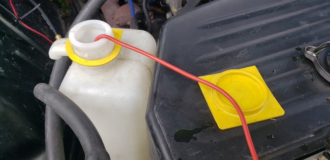

You put your voltmeter in the coolant. Red lead in the coolant and black to ground. Anything over.2 volts is too much.
This is a common voltage drop test on any electrical system. It has been done for years.

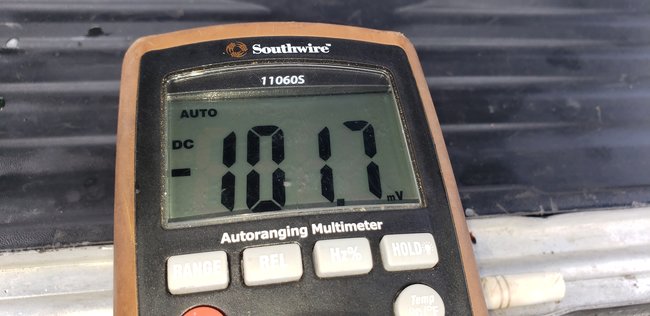

Hi, for some reason I couldn't find latest message about pulling motor taking engine to a mechanic. I'm amazed I got this far. I have a condition that shuts my brain down and it's all over. Anyway last you told me the voltage in coolant should be no more than.2 v.
Saturday, April 25th, 2020 AT 11:29 AM
PAUL KRAUSE2
  • 62 POSTS
Was over 120mv in tank.

How can this be be so high? Its mv does that matter?
Saturday, April 25th, 2020 AT 11:32 AM
  • 52,797 POSTS
That is a good reading.
