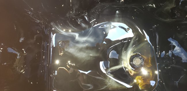

Doing pressure test with oil pan off, lost 1 pound in 35 minutes, saw a few drips. 15 to 14. Going to do it again, the drips were from all other. Very slow, 1 per minute maybe.

4 drops in 11 minutes. 2 sround 1 2 around 7, strangely I just seen three slow 1 second streams from oil pump screen. 1 second steam, stop 4 a few seconds and do it 2 more times. Gauge reading 14.5 lbs.
Friday, April 24th, 2020 AT 4:24 PM
  • 52,797 POSTS
Okay, then you have an internal leak in the motor itself.
You need a bright LED light and look up inside the motor and see where the source of the leak is located.
It could be a head gasket, intake manifold or a cracked block.
Friday, April 24th, 2020 AT 4:31 PM

40 minute, 14.5 lbs, wiped oil off bottom of pistons I could, 5, 7 and a couple others. Stayed dry, I think the oil is coming from up above, dripping off cam. 1 place in back, 1 place in front. I'm wiped out, will it hurt if I leave oil pan off tonight? That oil pan is after 4 hours or so of idling.
