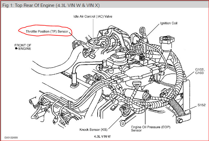

DANNY L
  • 5,648 POSTS
Hello again.
It sounds like you might be having a problem with the Throttle Position Sensor. I have attached a picture of its location. Hope this helps and thanks again for using 2CarPros.
Danny-
Wednesday, September 19th, 2018 AT 7:22 PM
SLW88
  • 6 POSTS
That is brand new. I thought it was the TPS too so I replaced it. Maybe the idle control valve?
