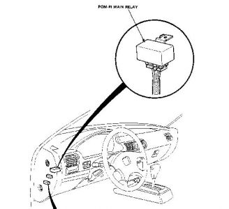

The car starts up just fine. After running for a short period of time it starts to misfire and sometimes stalls out. After waiting about 5 min. It will resart and run just fine with no misfire. After the initial start it runs pretty much great the rest of the day, even after turning off the engine and resarting?
Monday, January 11th, 2021 AT 6:16 PM (Merged)
KHLOW2008
  • 41,815 POSTS
Hi frank1235,
Thank you for the donation.
The symptoms are consistent with an intermittently failing PGM-FI main relay. I would suggest removing it and resoldering the circuit board, this is a known issue.
https://www.2carpros.com/forum/automotive_pictures/192750_PGMFIRelay90Accord_9.jpg
