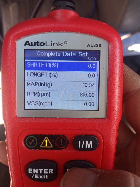

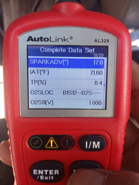

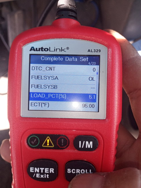

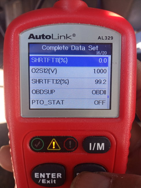

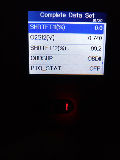

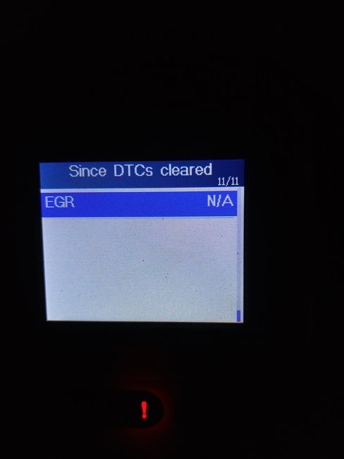

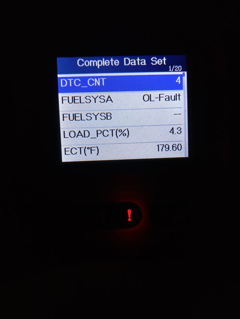

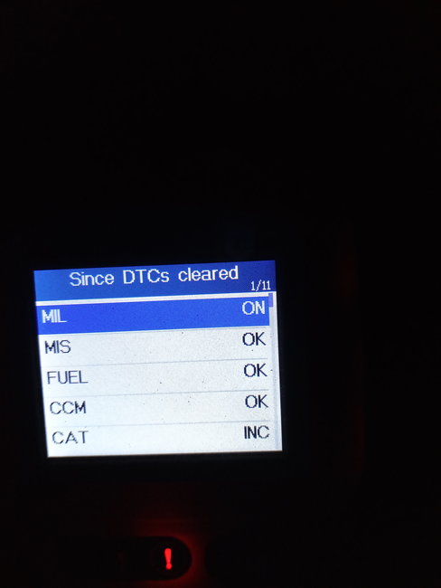

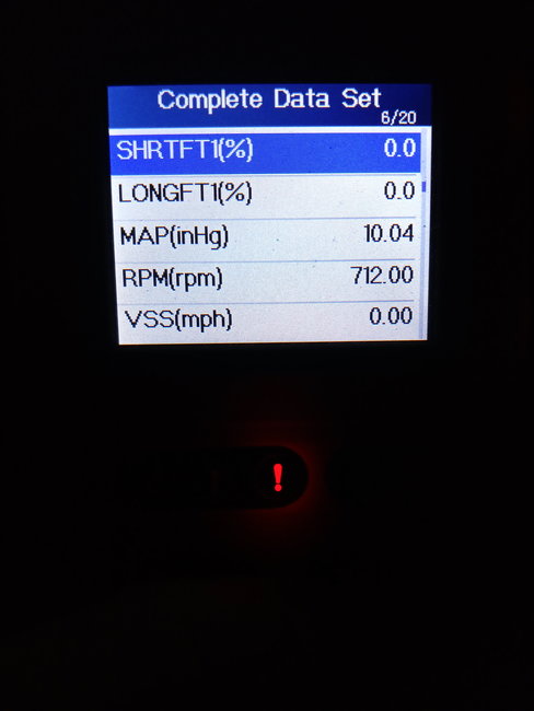

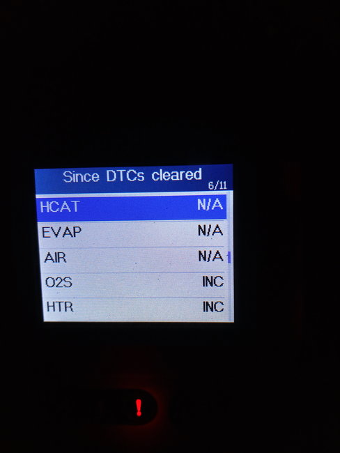

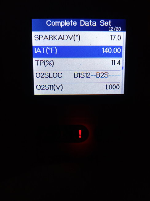

Here's the readings I got on my obd2:

I looked at your pics. The short-term fuel trims are indicating fuel being added. Have you checked for vacuum leaks or the fuel pressure? Also, the coolant temperature sensor says 95°F. Was this done as soon as the vehicle was started and still not at operating temperature?

Yes, it was it was hard to start so I hooked it up and then took the pictures like 5 after it was idling. I don't know how to check vacuum leaks and I need to get paid before I can get a fuel pressure gauge and then I can send that info.

If it was running for five minutes, the ECT should have been higher. I'm starting to question if that is the issue.
Do me a favor. Allow the engine to reach operating temperature. See what the ECT signal is at that point. It should be around 200°f.
Also, here is a link that explains how to check for a vacuum leak:
Let me know what you find.
