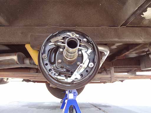

See photo: are the rear drum brake springs in the correct positions?
CARADIODOC
  • 34,489 POSTS
The only thing I see is the top metal bar needs to be pushed up a little. It should be centered on the large anchor pin, then it will pop back another 1/8" and the two return springs will sit deeper behind the head of the anchor.
I still don't have an answer about that extra spring on the bottom.

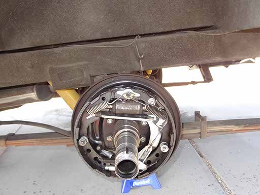

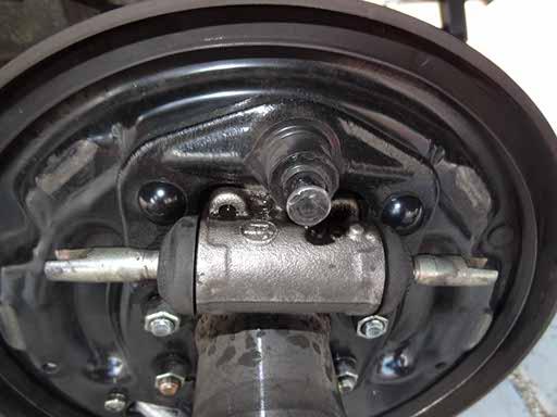

Here's a pic of the lip the metal bowtie you were telling me about. I was able to do this side myself. It's hot right now but I will put the hub on later this afternoon. I didn't see the guy tighten the outer bearing nut but I think he got it tight by putting two phillips screwdrivers in two opposite holes and wedging another tool to turn the nut. I will try this. Your help gives me confidence, thanks.

I forgot to ask in last post. Are the main return springs supposed to brush up against other parts? Here's two pics is this normal?
+1
Wednesday, June 12th, 2013 AT 9:46 AM
CARADIODOC
  • 34,489 POSTS
The two return springs appear to be correct. The only thing I can't see is the hook on the left end of the left spring. Judging from the gap between the spring and shoe frame it appears to be installed correctly. They could rub against the end of the parking brake strut.
If there is a pair of tapered wheel bearings in each drum you don't want to make the axle nut overly tight. Typically I crank them down as tight as possible with hand tools to be sure they're seated fully, then I loosen the nut, then tighten it again by hand. Over-tightening them causes the gear lube to squeeze out of the rollers resulting in metal-to-metal contact. You want just enough play to allow some lube to sneak in between the rollers and bearing races.
If the bearings use straight rollers the axle nut can be tightened more because it pushes on the inner race only. Nothing pushes on the rollers that will make the gear lube squeeze out.
