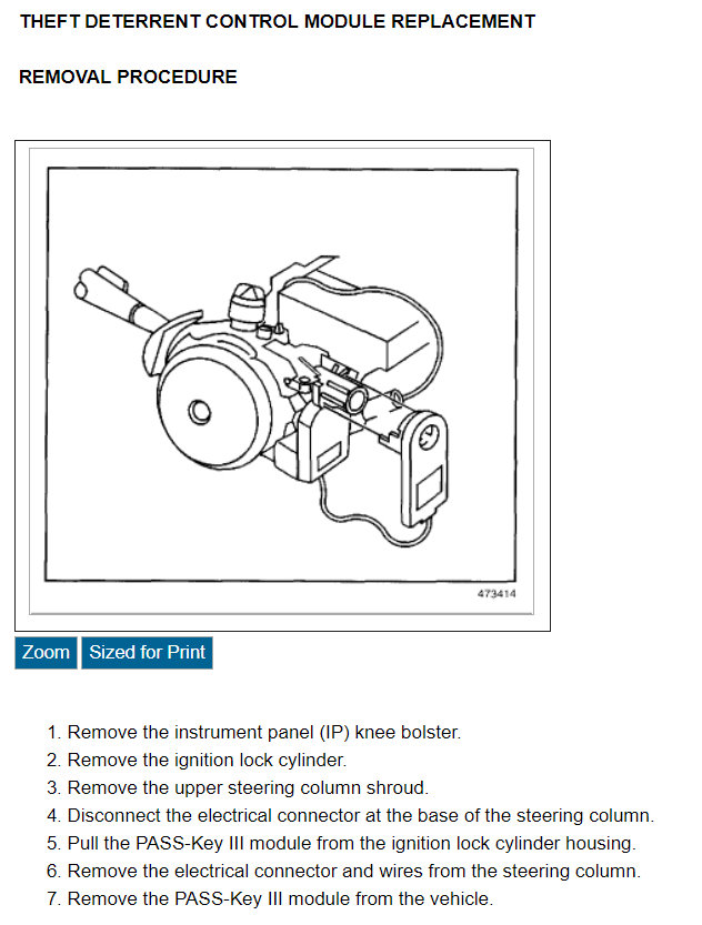

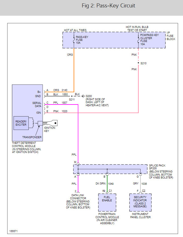

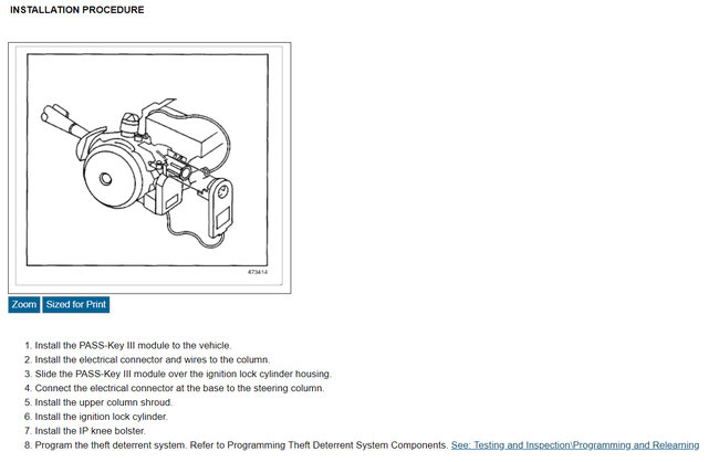

I know the security control module needs to be replaced, but I do not know where it is located. Do you know where it is located in my vehicle?

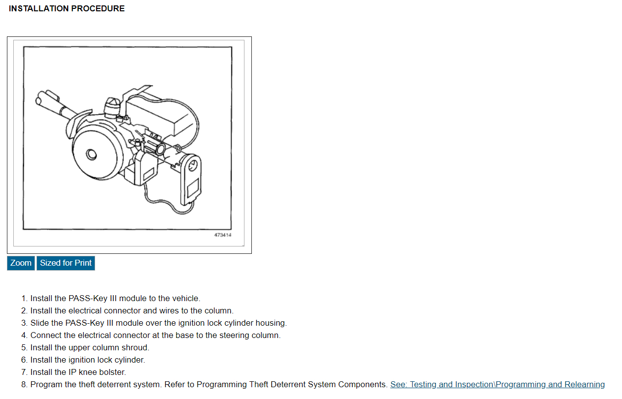

Here are instructions and diagrams showing the security module:

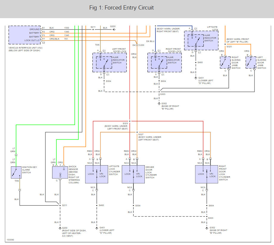

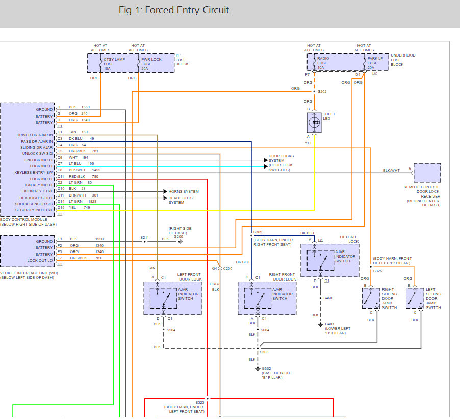

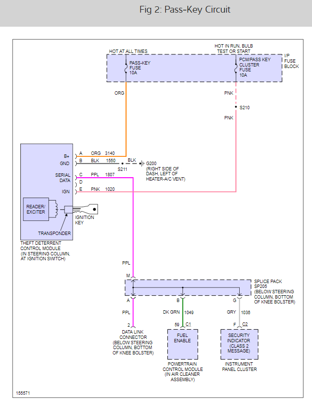

Some of the alarm system is in the BCM here are wiring diagrams for the system so you can see how it works

Is there another part to the security system other than the part by the key? Because I have already replaced that and the van still will not start. So I know it is not the pass-key III part that you are showing in the diagram. Is there anything else that could be making the van not start? I have tried everything I can think of.

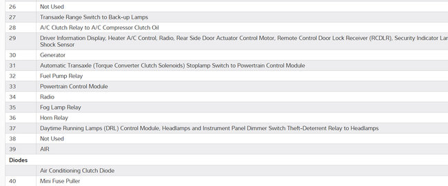

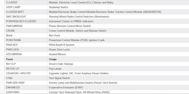

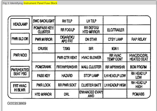

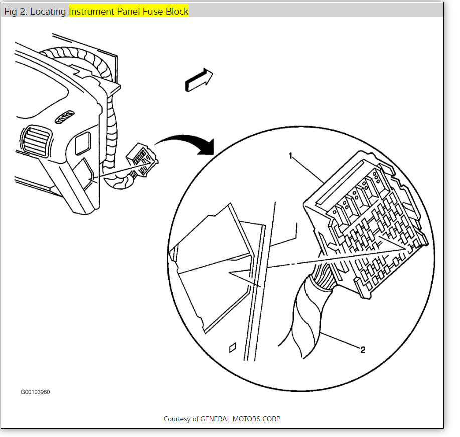

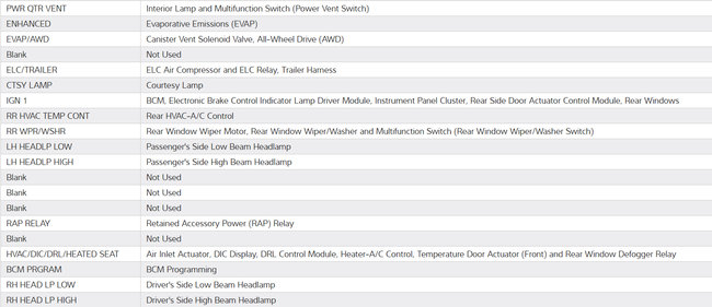

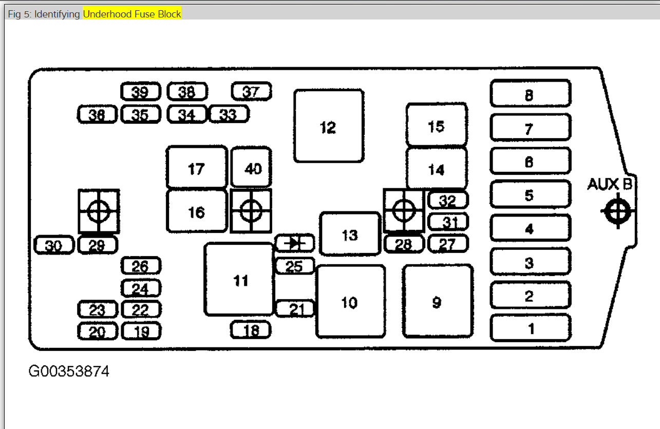

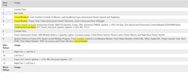

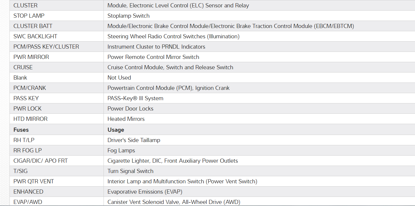

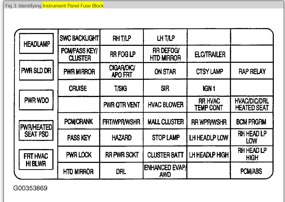

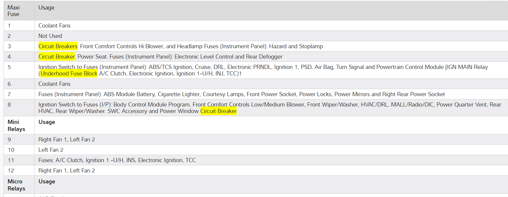

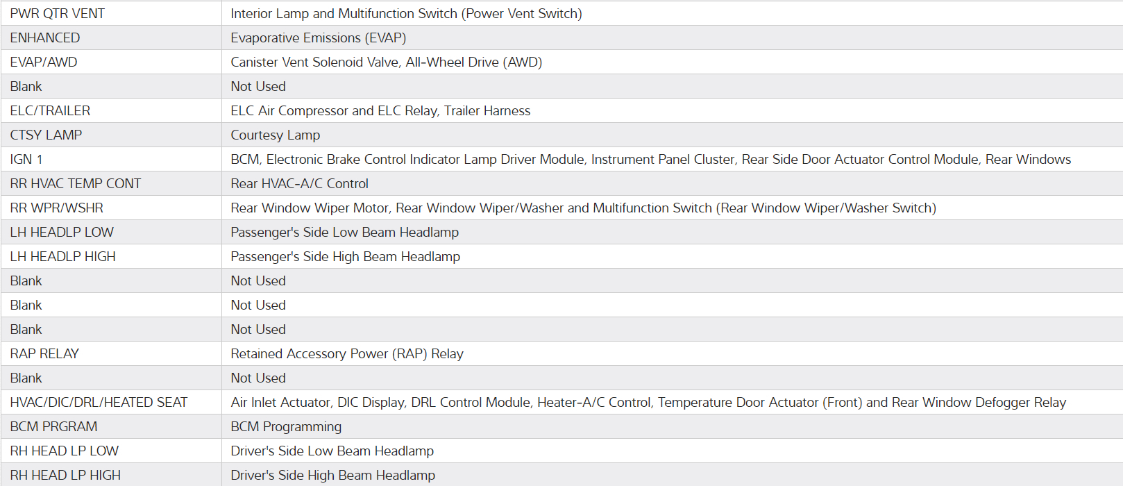

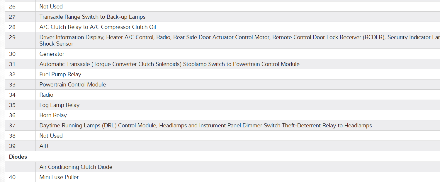

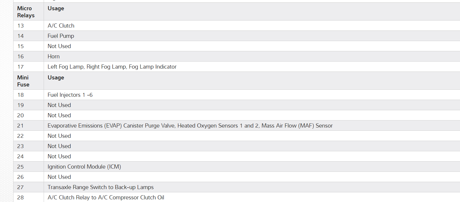

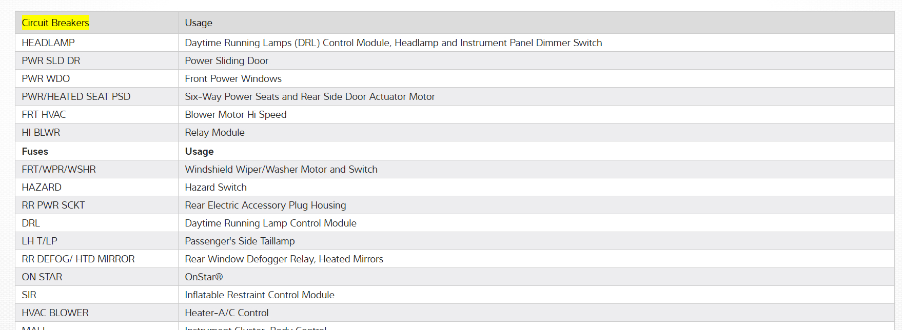

Does the security light flash when you are trying to start it? Have you checked the Passkey and Passkey PCM fuses?
Here is a guide: https://www.2carpros.com/articles/how-to-check-a-car-fuse
Here are the fuse locations. Check out the diagrams (below). Please let us know what you find. We are interested to see what it is.

I have checked all fuses, replaced the key cylinder, key switch, and passkey III. And sometimes the security light flashes and sometimes it does not, and there will be times that it starts just fine and other times it will not. It tries and it cranks but never fires. I can spray some started fluid to trick it to start but it will not always run. My last thought is it is just the computer as a whole, I have no idea what else it could be. And also there are no codes that come up so I have checked and done everything I could think of and nothing. I am at a complete loss and really hope you have an idea.

It sound like the BCM has gone bad or the system program has become corrupt. This mean you will need to take it to a shop that can reprogram the security portion of the BCM.
