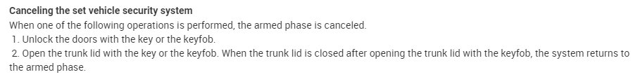

Battery died I installed new battery now car won't start. I was told I had to reset security.

Hi Mark,
I attached a document that shows how to disable the system. However, when you turn the key on does the theft light stay on? If so, we may need a scan tool to see if there are codes because there may be an issue with the key. There are times when the battery dies and it basically "forgets" the keys. If this is the case, there will be a code for invalid keys.
Lastly if you have another key, does that key work?
Monday, September 23rd, 2019 AT 6:40 PM
