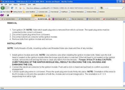

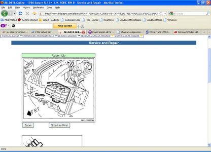

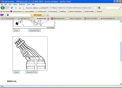

It's under the two coil's i posted instruction's on how to remove the coil's and module.
