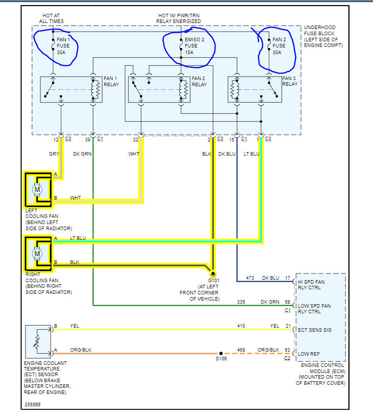

Just about a month ago, I was noticing my engine fan would be running after I shut the car off. Then I started noticing the temperature will rise at long stop lights but then the fan kicks on and the temperature would lower to normal. But it appears to do this even when it is cool outside. I do not see anything leaking and the fact that the temperature does go down tells me it is not the thermostat so what could it be? I see "head gasket" thrown out as the answer to a lot of people with similar issues but just wondering if there is possibly some other things to try before going down that expensive road.

I would also check the cooling fan motor to see if it is working. Check out the diagrams (Below). Please let us know what happens.
https://www.2carpros.com/articles/replace-electric-fan-motor
It should come on at 208 degrees and off at 190.
I attached a wiring diagram of the system for you to view.

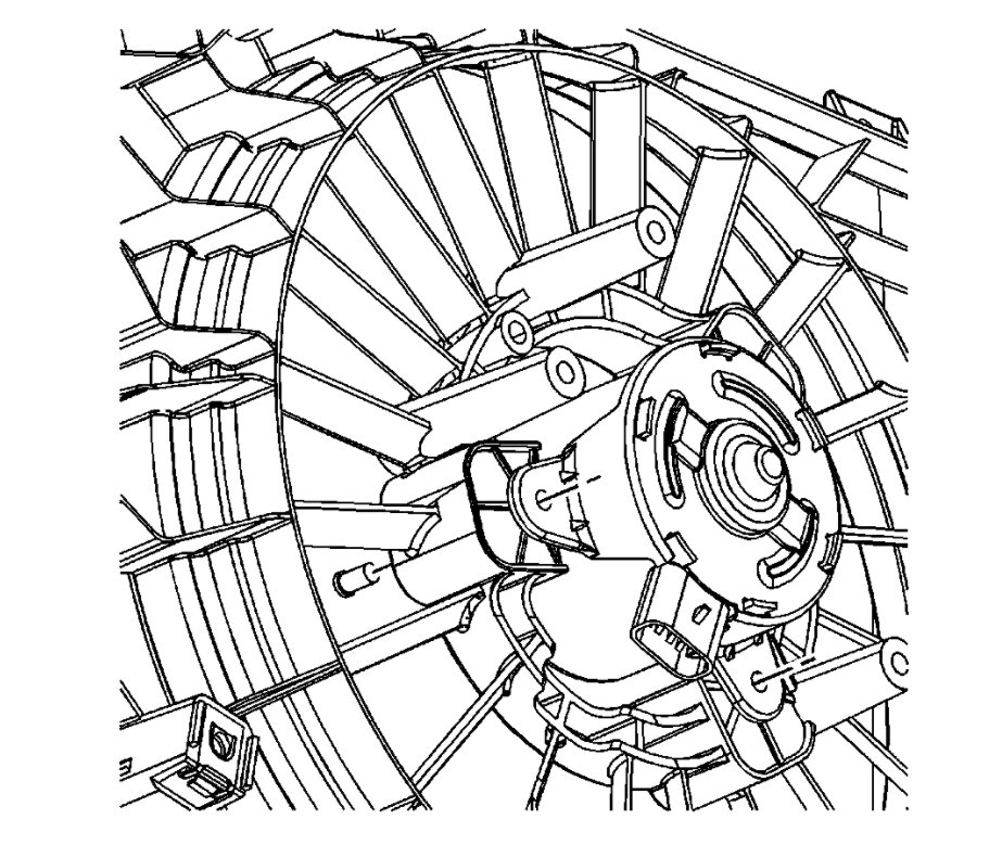

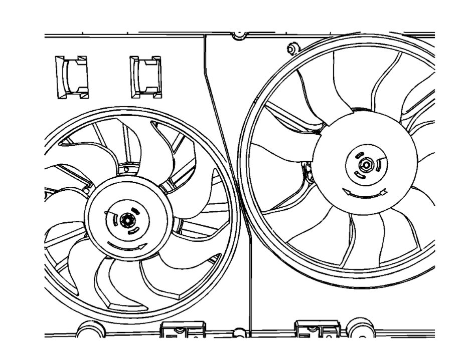

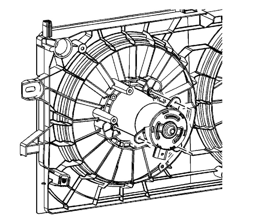

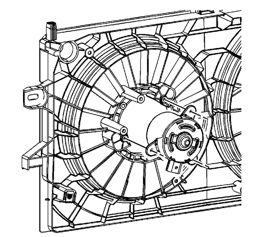

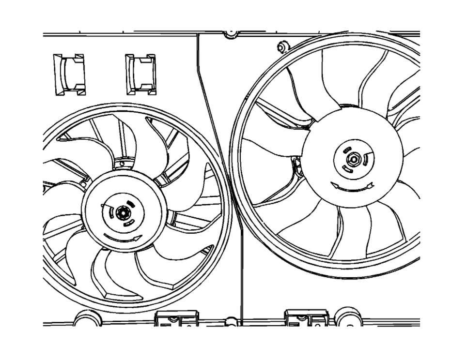

Engine Coolant Fan Motor Replacement
This vehicle is equipped with counter-rotating engine cooling fans. The right hand fan will require the use of GE-47827 for fan blade removal. The left hand fan blade can be removed using a normal six point socket.
Removal Procedure
Caution: An electric fan under the hood can start up even when the engine is not running and can injure you. Keep hands, clothing and tools away from any underhood electric fan.
Caution: To help avoid personal injury or damage to the vehicle, a bent, cracked, or damaged fan blade or housing should always be replaced.
Caution: Before servicing any electrical component, the ignition and start switch must be in the OFF or LOCK position and all electrical loads must be OFF, unless instructed otherwise in these procedures. If a tool or equipment could easily come in contact with a live exposed electrical terminal, also disconnect the negative battery cable. Failure to follow these precautions may cause personal injury and/or damage to the vehicle or its components.

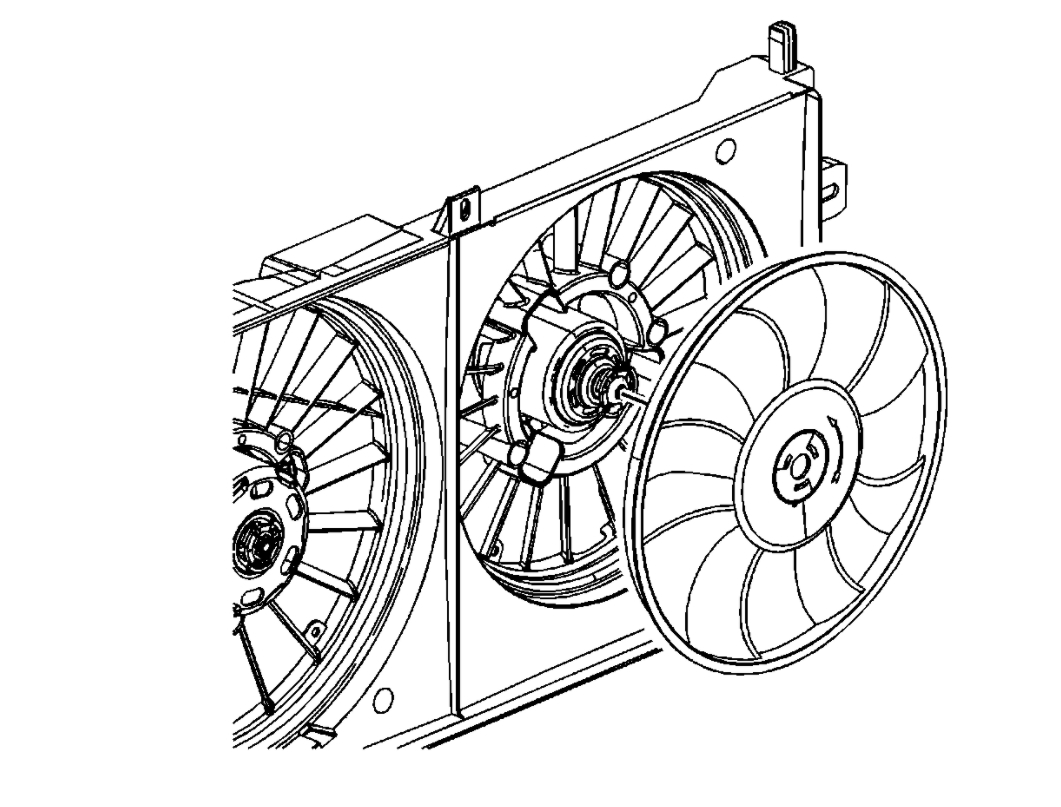

1. Remove the fan shroud assembly from the vehicle.
Important: Hold the fan blade to prevent rotation.
2. Using GE-47827 , or a six point socket, turn the fan motor drive plate in the opposite direction of the arrow stamped on the fan blade.
3. Remove and discard the fan blade.
Notice: Failure to tape off all of the entry points to the cooling fan motor will allow debris to enter and damage the motor.
Important: When reusing the fan motor tape off the front and rear entry points of the fan motor before drilling the rivets.

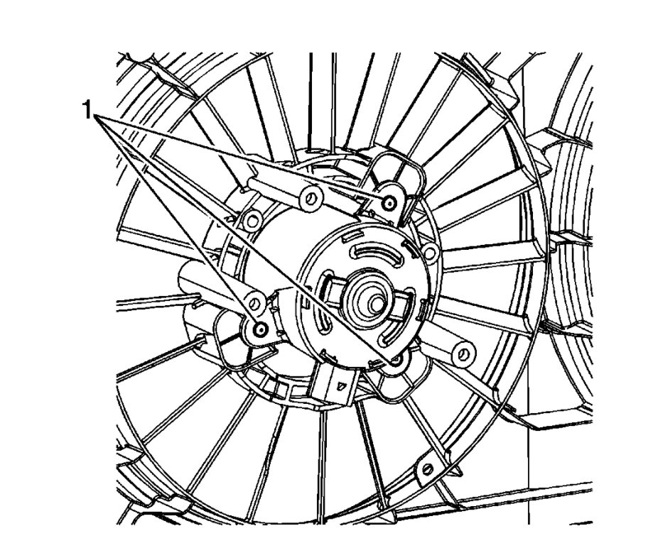

4. Center punch each of the rivets (1) from the rear of the motor.
5. Drill the head of the rivets (1) from the fan motor using a 6.35 mm (0.25 in) drill bit.
6. Tap the rivets out of the fan shroud.
7. Remove the fan motor from the fan shroud.
Important: Blow off any excess debris from the fan motor.
8. Remove the tape covering the entry points from the fan motor.
