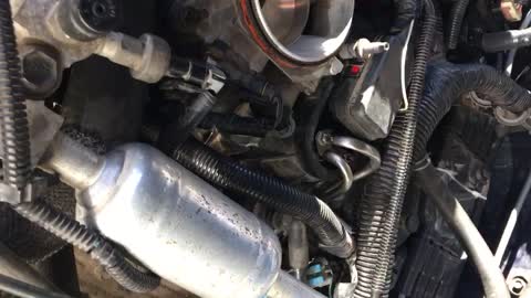

So, I assembled it all and my misfire is gone but now it sounds like the carb is whistling. Idles really rough. Carburetor gasket? I did spray carburetor cleaner around and nothing changed. But when I took the air cleaner off and sprayed around the carburetor. It idled high then shut off. I put the cleaner assembly back on and started it and it fired up but ran rough.
Saturday, September 25th, 2021 AT 5:51 PM
If you put your hand over the top of the carburetor with it running, does the whistle stop?
If it does, you need to either rebuild the carburetor or replace it.

I will have to check when I get home. I meant to say throttle body not carburetor.
Sunday, September 26th, 2021 AT 1:50 PM
Okay, check that and see.
Let me know how you make out.
Sunday, September 26th, 2021 AT 2:18 PM
JEREMY400
  • 27 POSTS
So, it did not shut off it sucked my hand onto it. It doesn’t sound like it’s whistling anymore. Here is a video of what it sounds like:

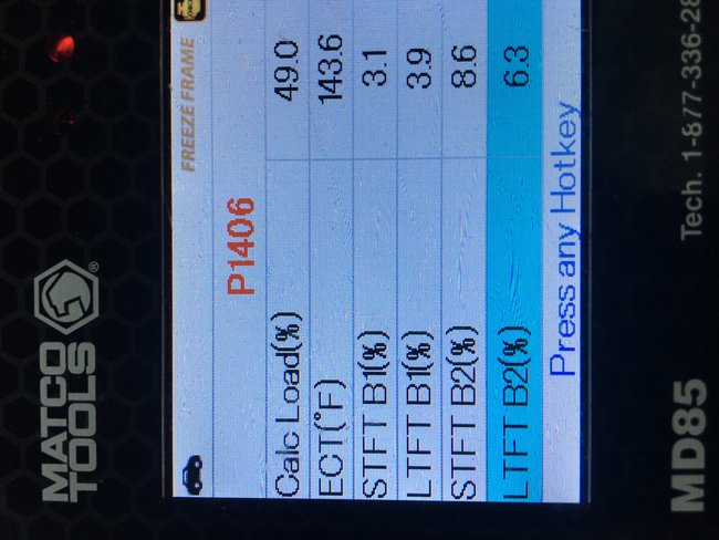

So, I borrowed a friend’s scanner. Here is a picture and a new code jump popped up. It’s on the screen. So, wouldn’t bank2 short term trims be a little high? Running lean? Thanks.
Thursday, October 7th, 2021 AT 4:01 PM
  • 110,192 POSTS

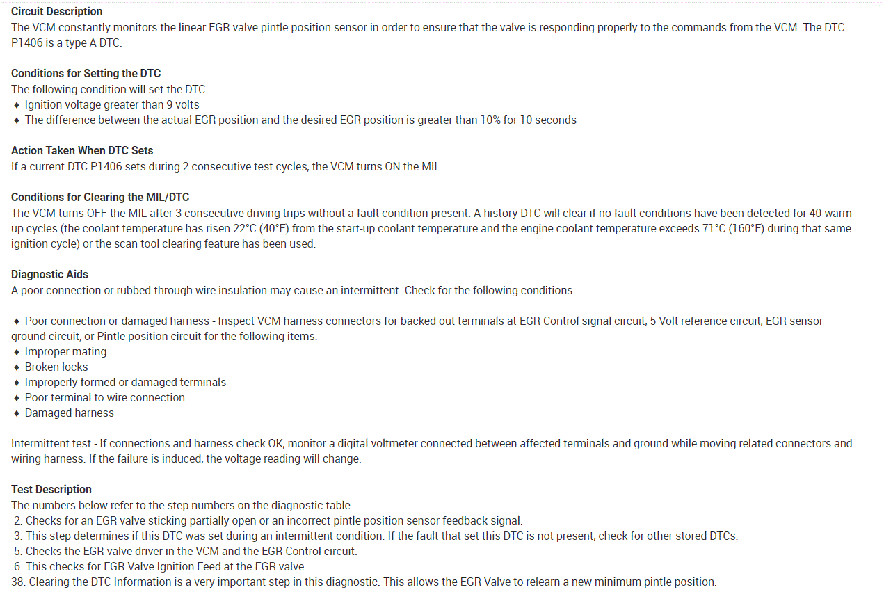

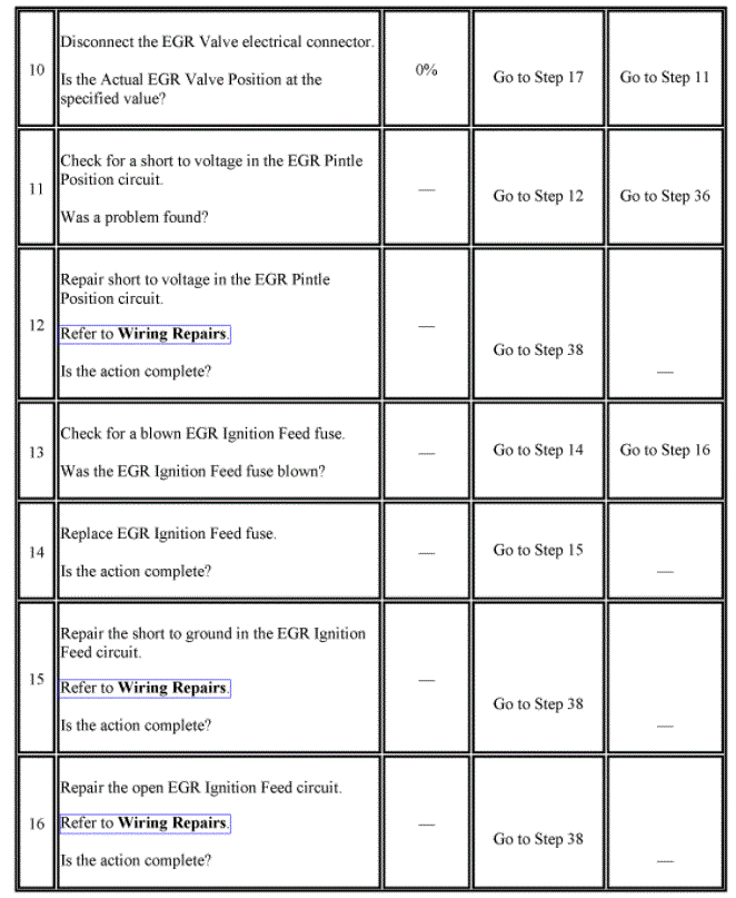

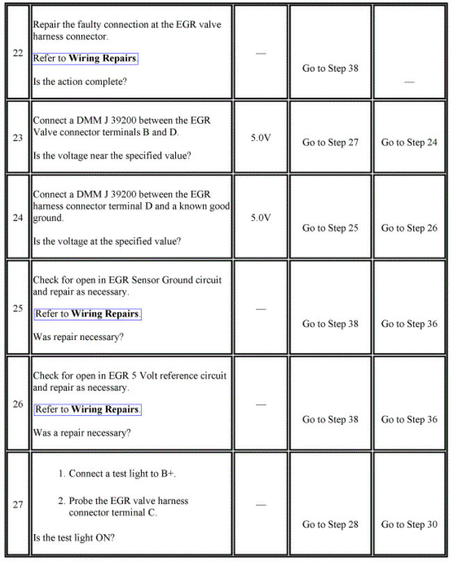

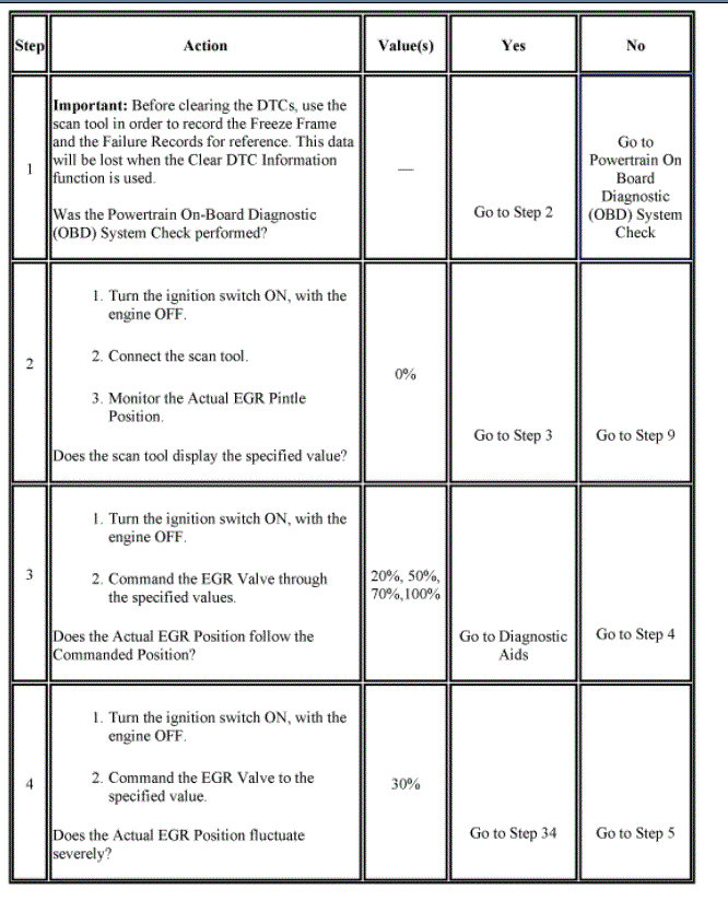

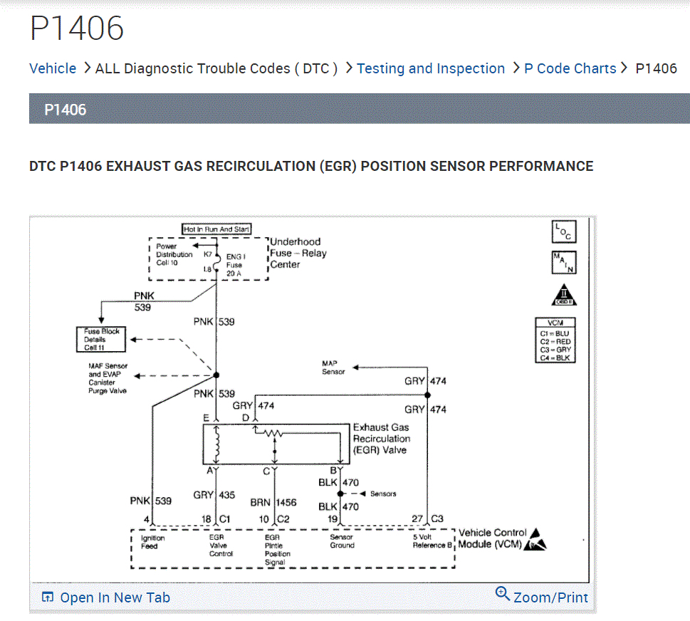

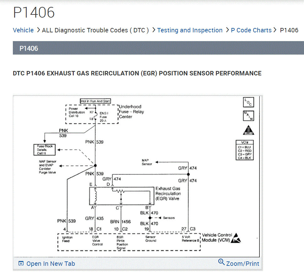

Bank 2 is a bit high. It isn't at operating temperature at this point. Check it at approximately 200F.

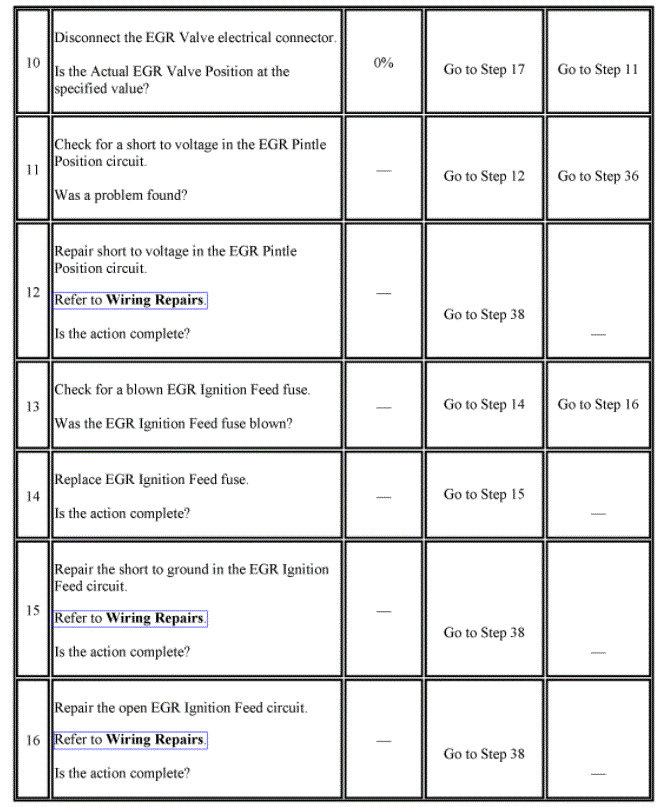

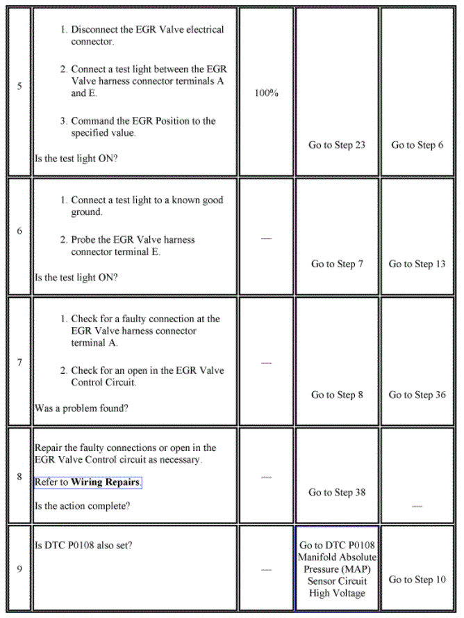

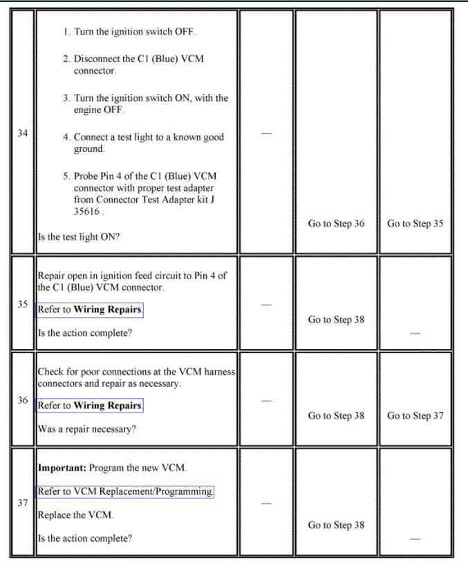

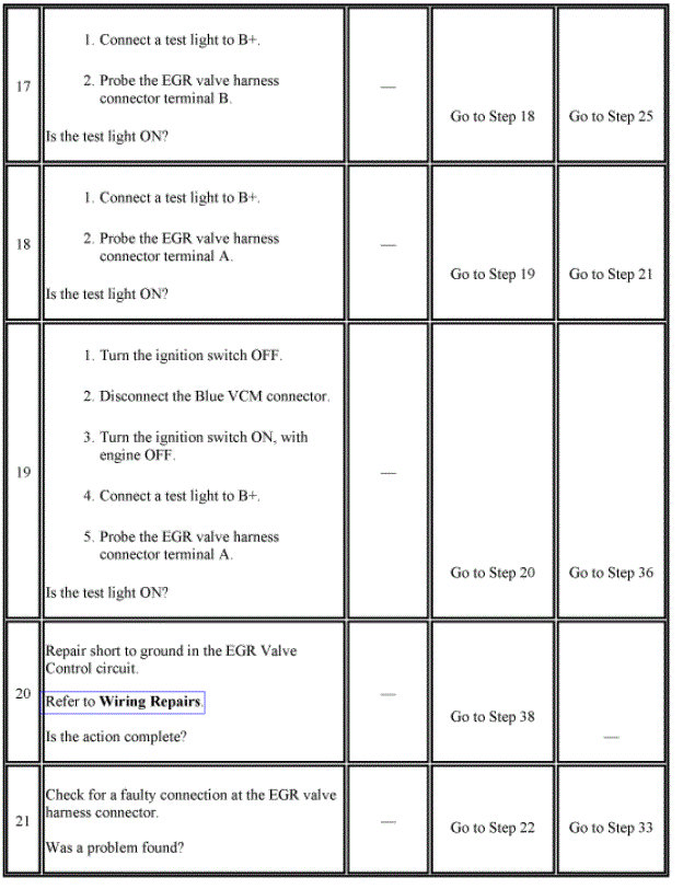

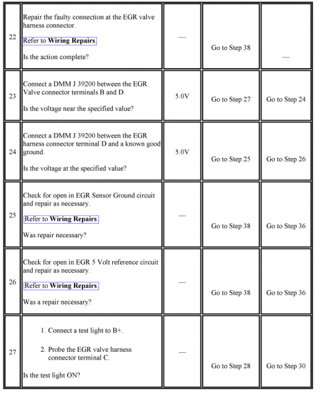

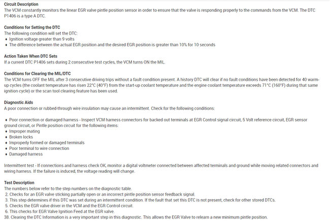

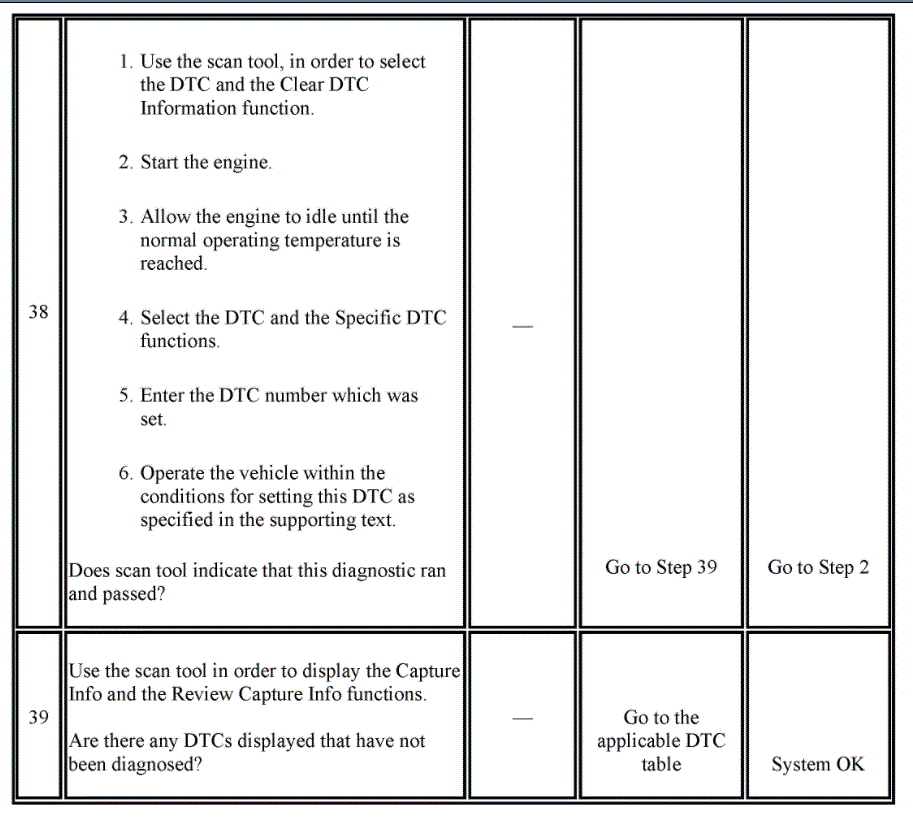

Now, the code indicates an issue with the EGR. That can be causing a lean mixture or even a vacuum issue. I attached the directions for the diagnostics below. Take a look through them and let me know if you are comfortable performing them.
See pics below. Don't be overwhelmed with the directions. Hopefully, you won't need to go through all of them. They are very detailed for every possible issue. Also, I think you found the issue. I suspect there is an issue with the EGR itself.
Thursday, October 7th, 2021 AT 5:48 PM
JEREMY400
  • 27 POSTS
Hey, so I did go down the list and there was power to the EGR so I changed it. P1406 is gone but the truck still runs rough. Bank 2 stft jumped up to +13. There is a gas smell. Someone told me to pull the intake and make sure none of the injectors popped out of the ports. With good fuel pressure could that have happened?
