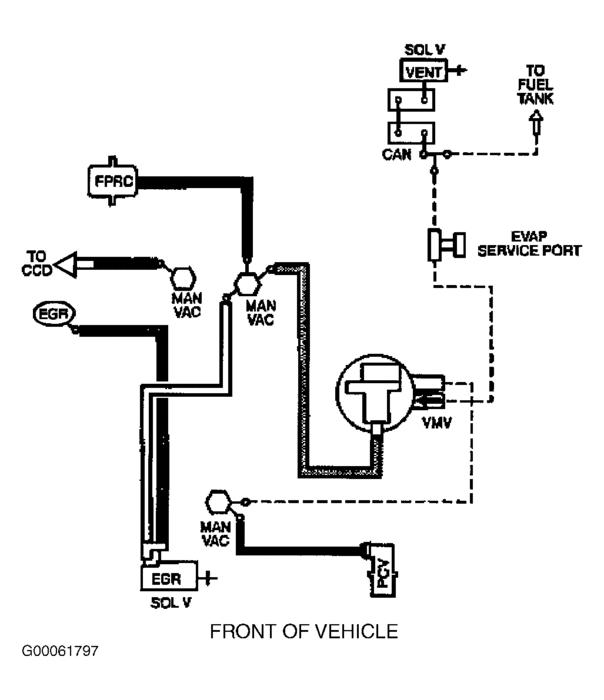

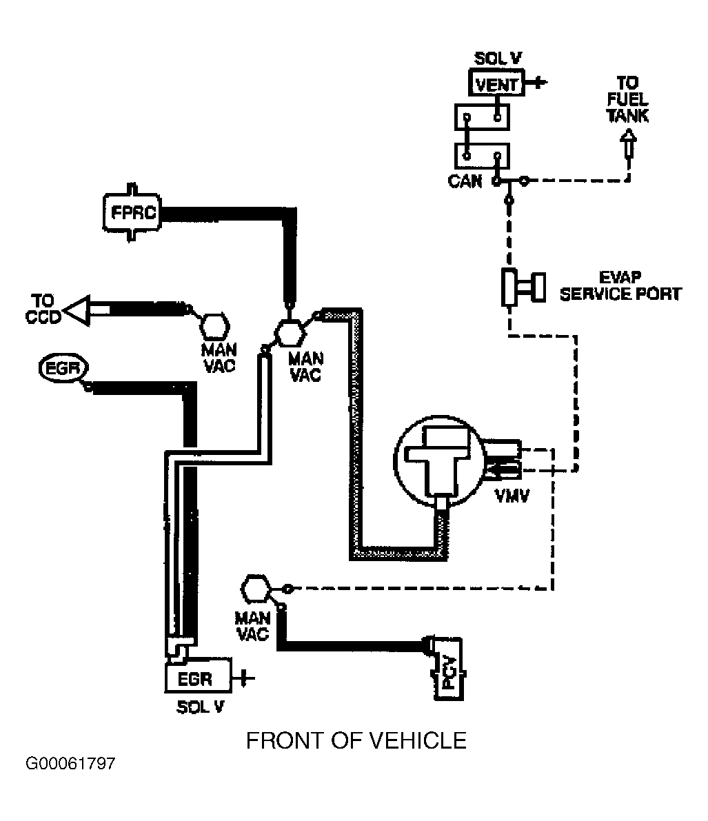

Look for a vacuum leak first here is a guide to show you how.
Also the MAF sensor can cause the engine to run rough, I would try cleaning it first and if that doesn't help replace it, here are some guides on that.
