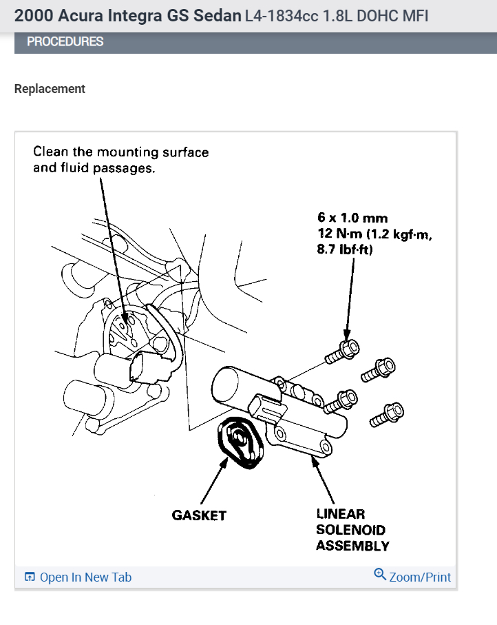

I've been having an idle issue with my car where it fluctuates between 800 and 600 RPMs when at a stop sign or when I'm reversing etc. It has been doing this for a while and I have changed the PCV and ICV and nothing really has changed. There aren't any codes being thrown either so I'm kind of stumped. Any ideas you might have as to what's causing this?
Sunday, July 10th, 2022 AT 8:50 PM
14 Replies
KEN L
  • MASTER CERTIFIED MECHANIC
  • 55,522 POSTS

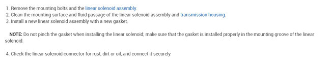

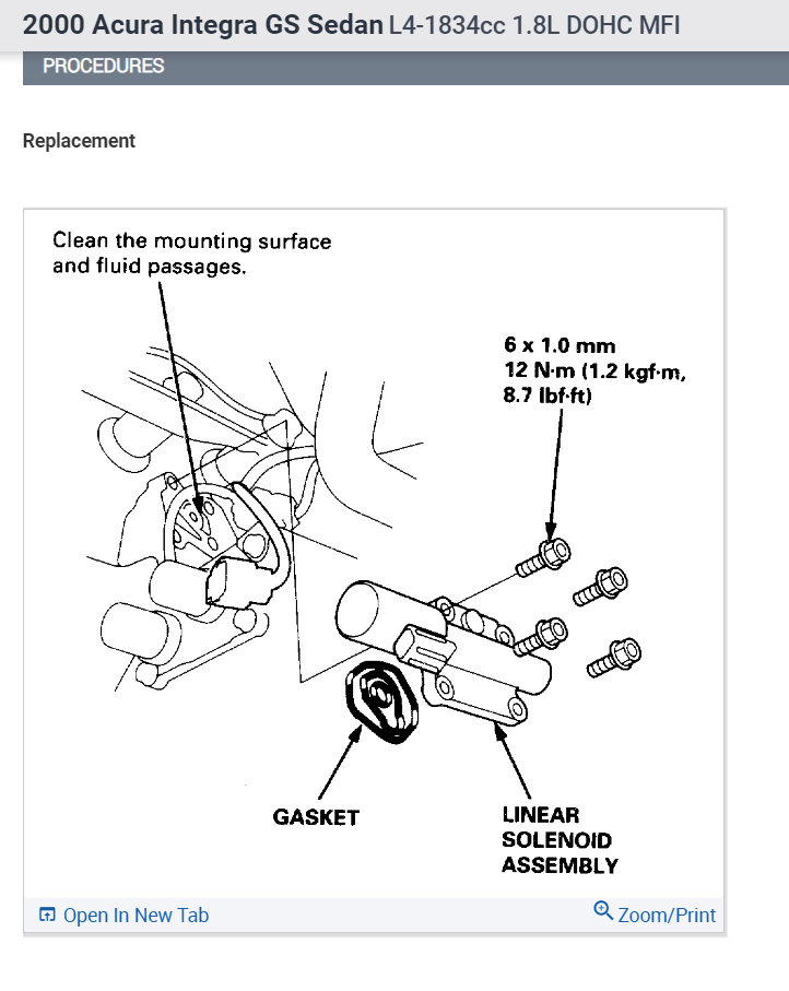

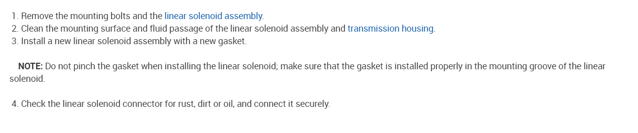

I have seen the linear control solenoid cause this issue, is this the one you changed out? Check the diagrams below. Check out the diagrams (below). Please report back.
Monday, July 11th, 2022 AT 3:06 PM
INTEGRA831
  • 9 POSTS
No, I haven't changed that out, would it cause idle to just jump up and down from 900ish RPMs down to like 600? Sometimes when I stop at a red light it feels like it's shutting off and sometimes it's stable.
Monday, July 11th, 2022 AT 3:51 PM
KEN L
  • 55,522 POSTS
Yes, that is what this part controls, let us know what happens.

I recently just changed the solenoid and it's still causing it to not shift down at high speeds and at one point it when into “limp” mode where even in drive it felt like I was not in neutral. Any ideas what else it could be? Maybe the other solenoid possibly?

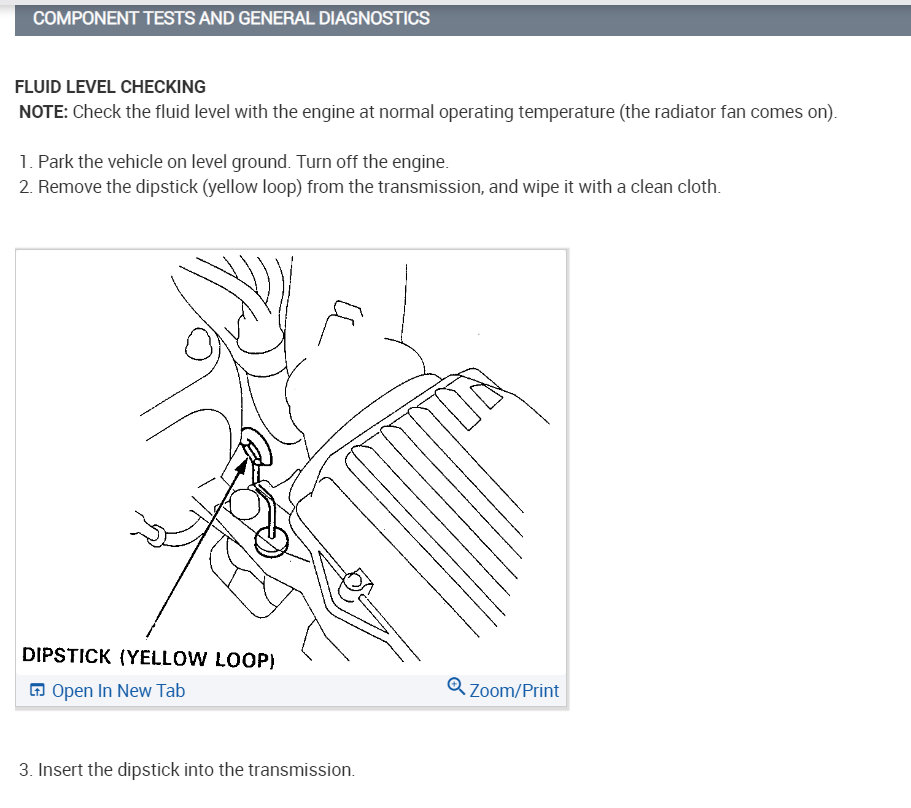

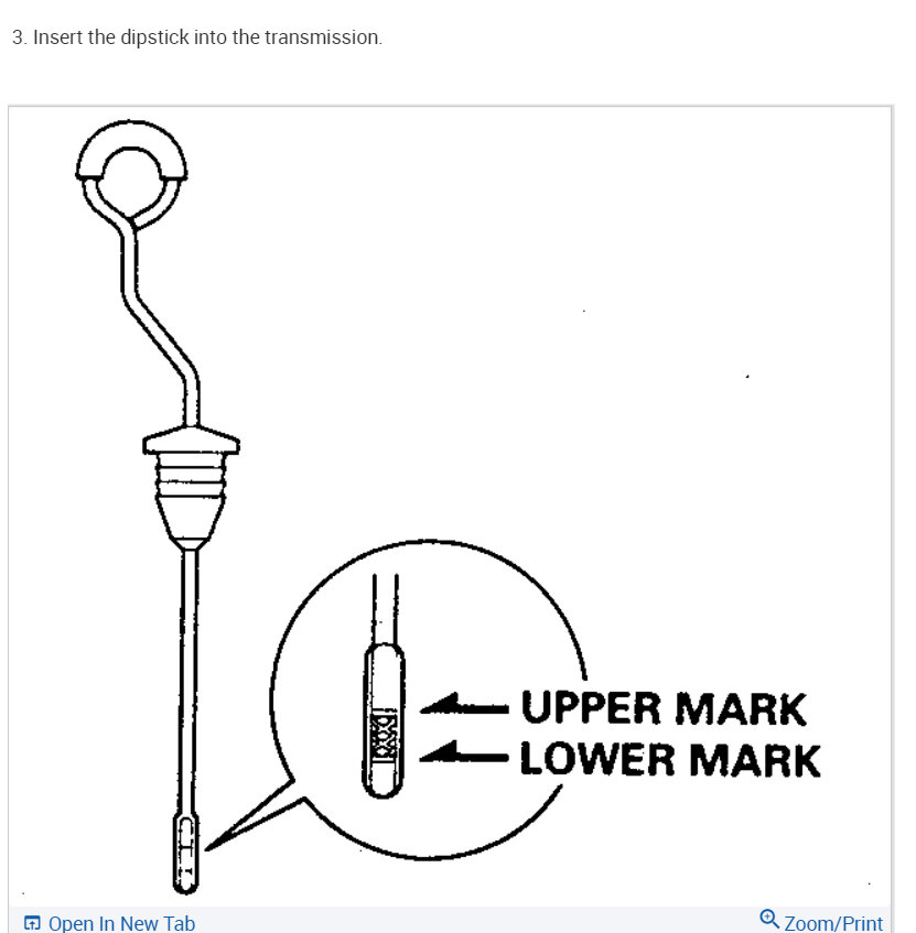

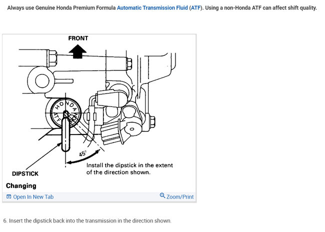

I could be the transmission itself engaging and disengaging, have you checked the transmission fluid level or condition? If not, it could need a transmission service. here is a generic guide to help with specific instructions for your car in the diagrams below:
A/T Fluid
Type .................... Honda Premium Formula ATF
Capacities
A/T Fluid
Change .................... 2.7L (2.9 Qt)
Total .................... 5.9L (6.2 Qt)
Thursday, July 21st, 2022 AT 10:38 AM

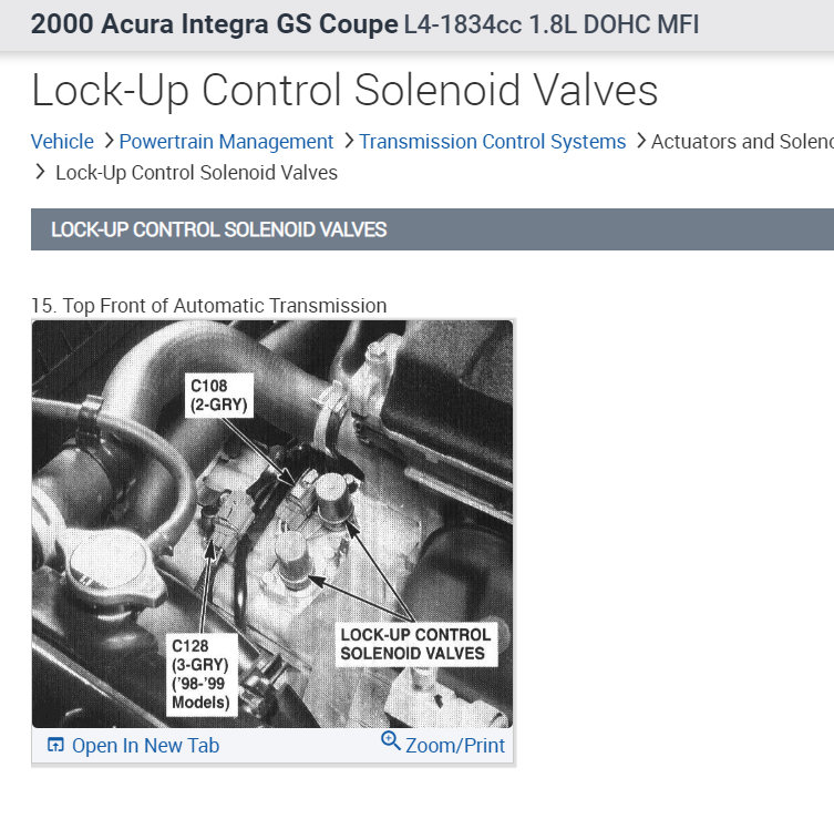

INTEGRA831
  • 9 POSTS
I recently got a check engine light with the code P0740.
Sunday, July 24th, 2022 AT 7:37 PM
INTEGRA831
  • 9 POSTS
Could it be the shift control solenoid on the transmission?
Sunday, July 24th, 2022 AT 7:38 PM
KEN L
  • 55,522 POSTS
Yep that can do it, or you have a bad torque converter. Can you try the engine idle problem in neutral and see if anything changes? Here is the converter clutch solenoid location in the diagrams below.
Monday, July 25th, 2022 AT 12:45 PM
INTEGRA831
  • 9 POSTS
I know for certain its not the torque converter going bad since I recently changed it about a month ago, I just bought the clutch solenoid and will change it when possible.
