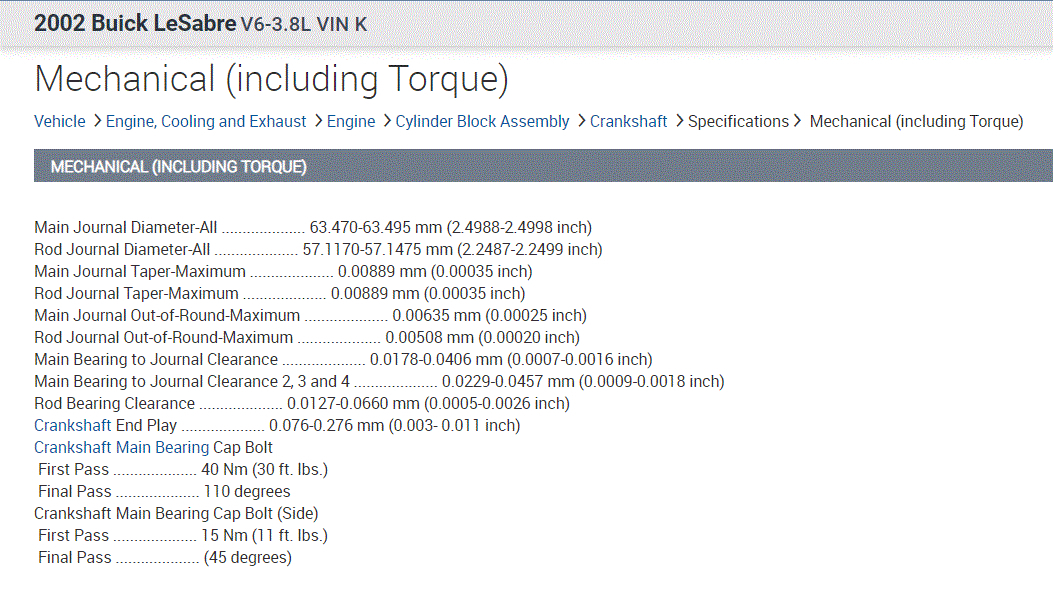

Spun rod bearing: Bearing was scored thin (almost all from rod and cap outside surface) but bearing still whole and in tack and not burnt etc.
Rod and cap scored but did not 'eyeball' as oversize or warped? (cap is exact same as good caps and bearings seemed to fit the caps the same with the same crush factor etc. Hard to tell about rod with engine in)
Crank rod journal was scored some but noticed that it miked exactly .030 less than the other crank rod journals?? It doesn't seem that the softer bearing condition was severe enough to eat that much into crank that quick to an exact .030 undersize??

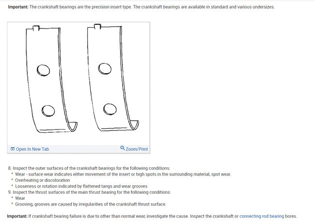

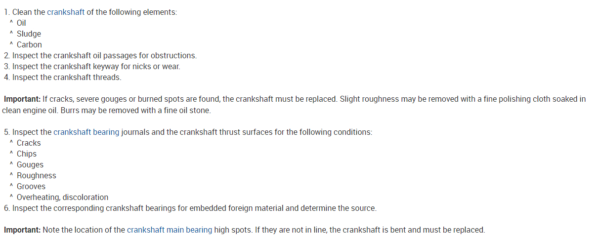

As far as the crank, if the scores can damage a new bearing, that is a problem. As far as removing them, you have to remove metal to do it which changes things as well.

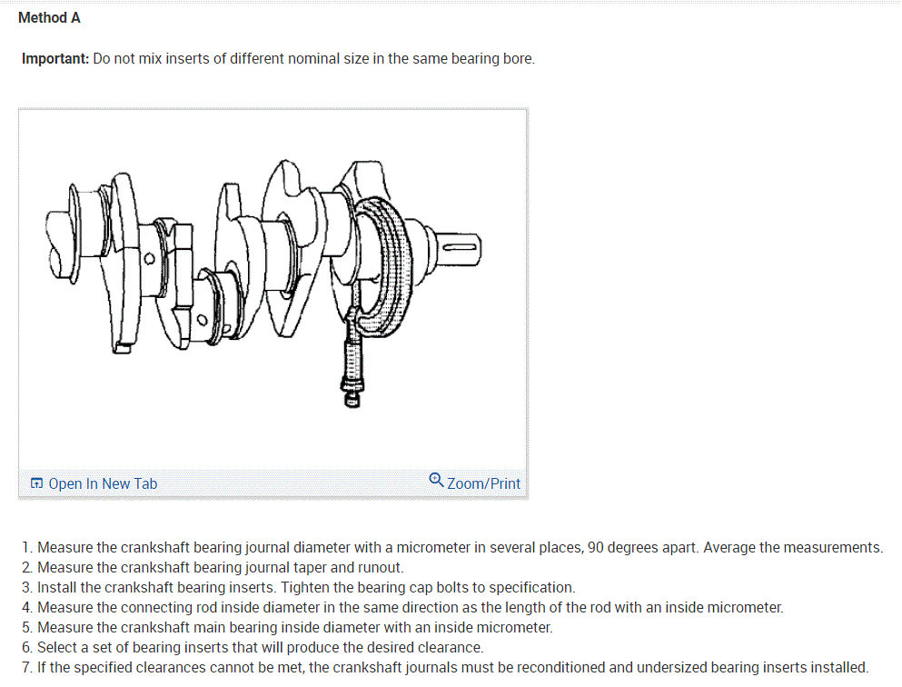

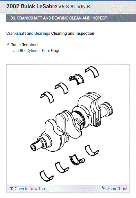

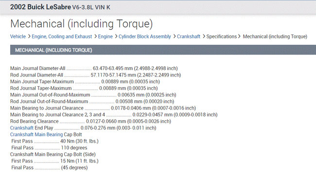

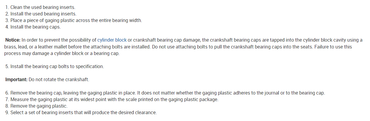

Here is what I can offer. First, I attached a pic below (pic 1) providing all the crankshaft specifications. Compare what you have to the specs.

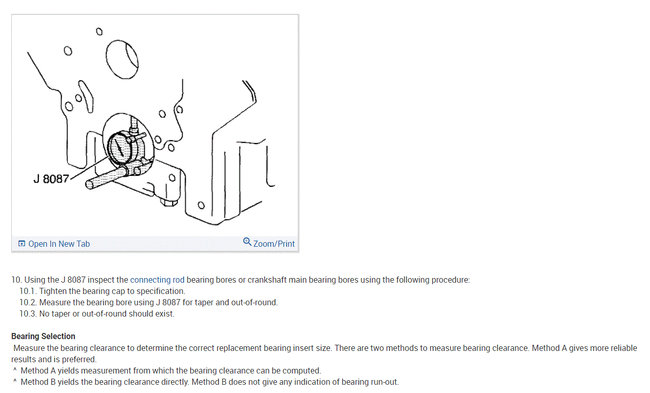

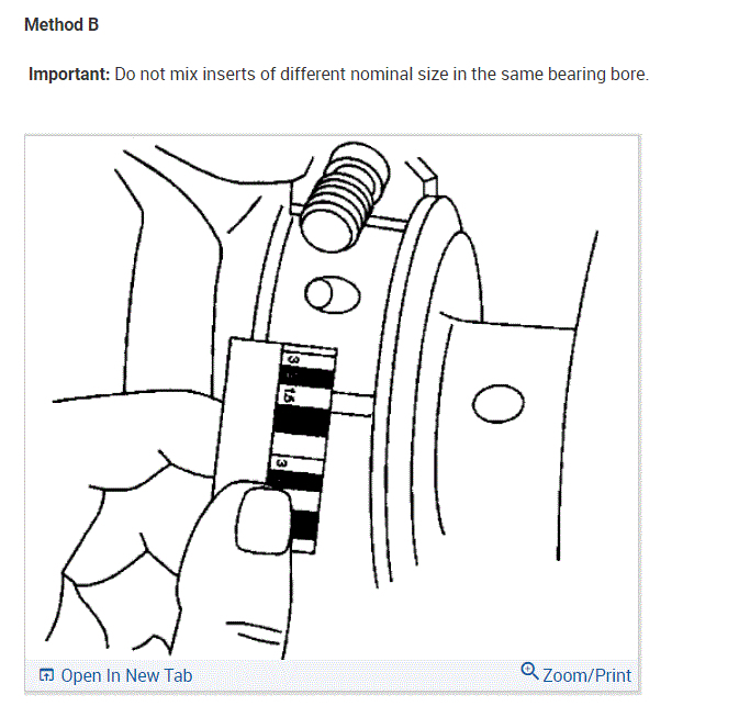

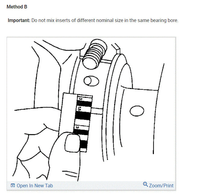

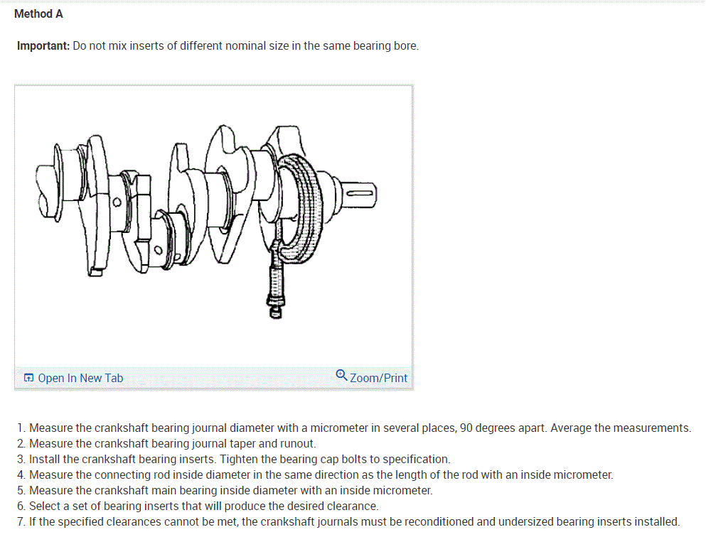

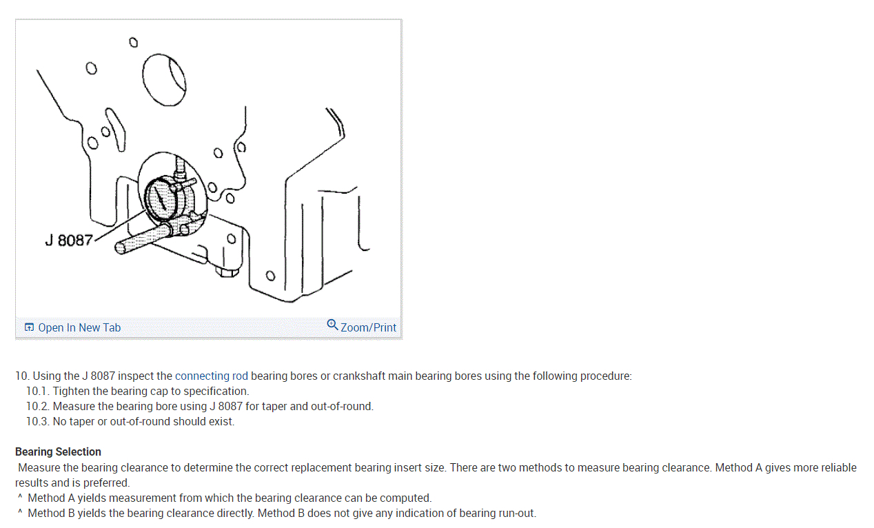

Second, I would check the crankshaft and bearing clearance. You will need a product called plastic gauge to perform this. However, it will let you know if there is too much clearance.

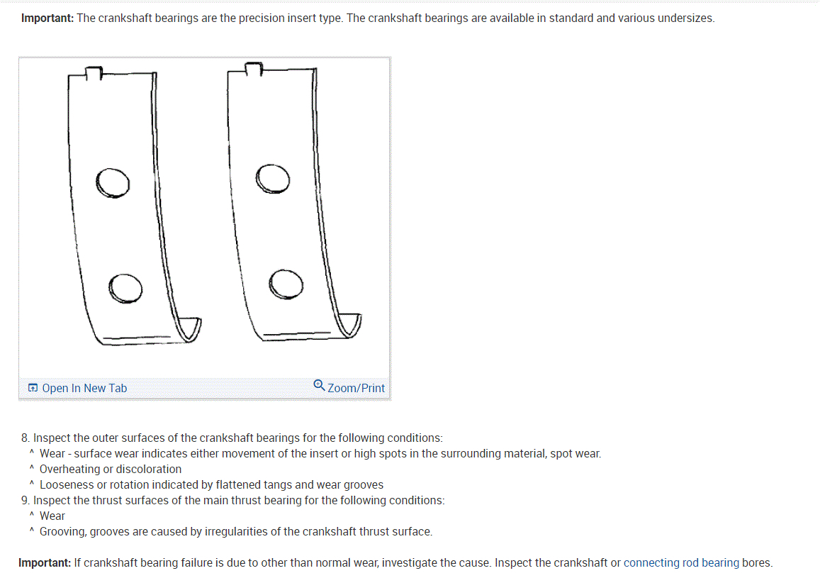

The remaining pics explain how to test. Also, if one of the bearings is oversized, that's fine (odd but fine) as long as the clearance is within spec.

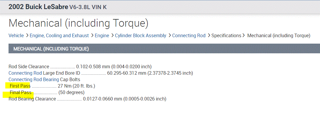

I see only main bearing cap bolt torques. Would you happen to have the rod cap bolt torque handy? Thanks

As far as the connecting rod torque, I attached that info below. Note that it is done in two steps. First, evenly torque them to 20 ft/lbs. The second step is to tighten the nut an additional 50 degrees.
