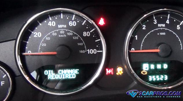

The engine oil life reminder light is designed to keep up on the maintenance of your vehicle. After an engine oil and filter change the light must be reset, we have gathered many popular procedures for turning off the service light for most vehicles which are listed below.
What Goes Wrong?
Some people forget to reset the oil life reminder after an oil change which results in an inaccurate oil life indicator for the next oil change. Resetting the oil life is free and easy to do.

Jeep Vehicles
  1. Turn the ignition switch to the ON position (Do not start the engine).
  2. Fully depress the accelerator pedal, slowly, three times within 10 seconds.
  3. Turn the ignition switch to the OFF/LOCK position.
