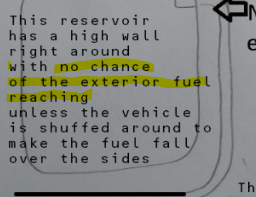

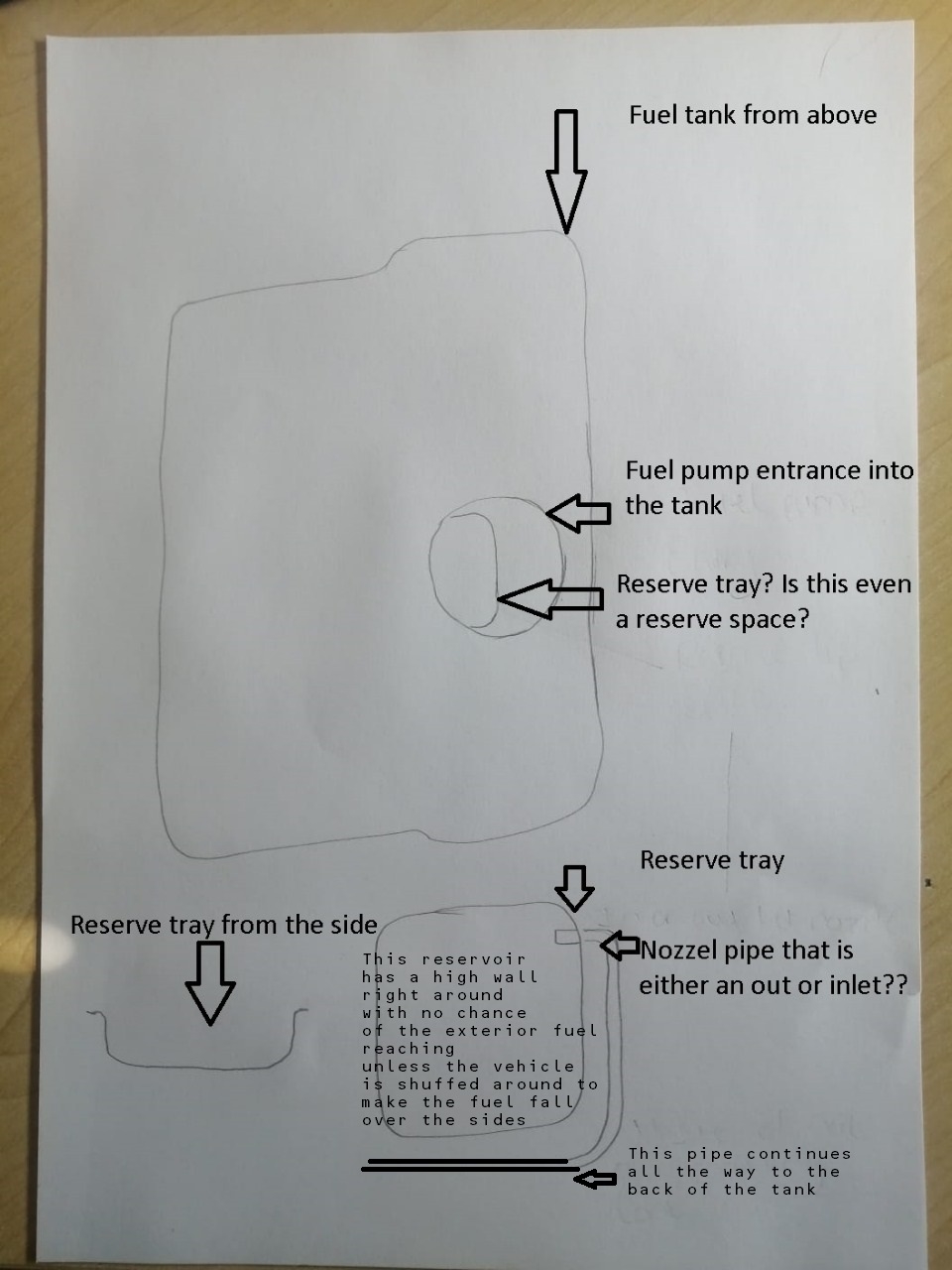

Tried to flush out the fuel line pipe that follows to the reserve thank - such a bad design. See diagram of how it works.
Fitted a secondhand sensor and floater unit and filter let's see how it goes. I'll have to on a monthly basis pull out the pump and see what the tank is doing.

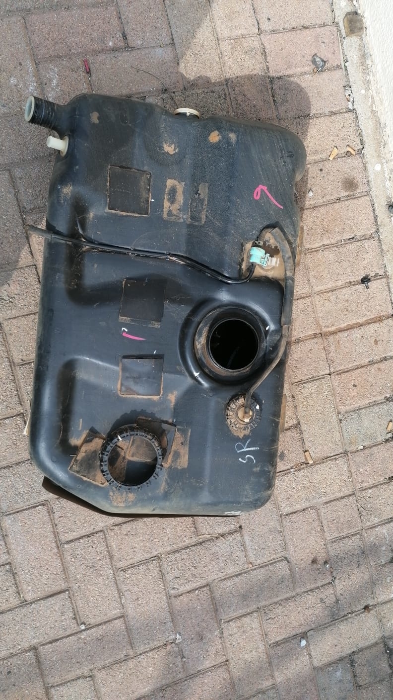

I have no idea the purpose of the "reserve". What is indicated is no fuel from the outside can enter it. Could it be some type of baffle that prevents the fuel from sloshing around?
Also, the tank in the pic appears to be plastic, or am I seeing it wrong?

It's literally a bowl that the pump sits in and then sucks the fuel through that stupid pipe in the picture. So, if the fuel isn't shaken around in the car regardless, I will always run out of fuel because we weren't able to manage blowing it open. Or rather I didn't get the help I needed to get it done.
It is what it is.
Yes, that tank is plastic.
Tuesday, August 9th, 2022 AT 1:08 AM
  • 110,194 POSTS
That is an interesting design. One that really makes no sense to me, but I'm not a design engineer. LOL What is interesting to me is they call it a reserve tank.
