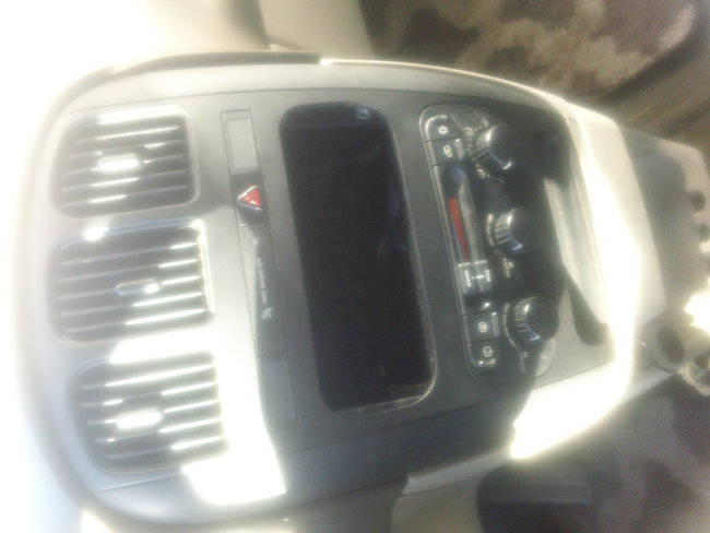

This is the best I could get. Where the gap is, if you put your hand in there, you can actually fit half your arm all the way in, which explains what I was meaning when I said there is nothing there. You may have to rotate the pic and enlarge it.

That is the factory surround just missing the radio. It can be gently pulled out to remove it, then look in there and see if you find any disconnected plugs, There will be one multi-pin connector that could be tucked just about anywhere because it isn't very large. As for a replacement, you can get a kit that lets you install an aftermarket unit right in that opening. The trim gets pulled out and the kit has brackets and clips to install the replacement unit.
