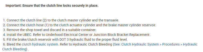

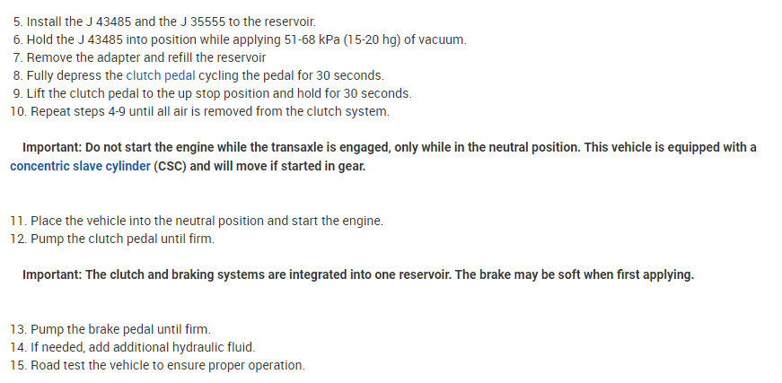

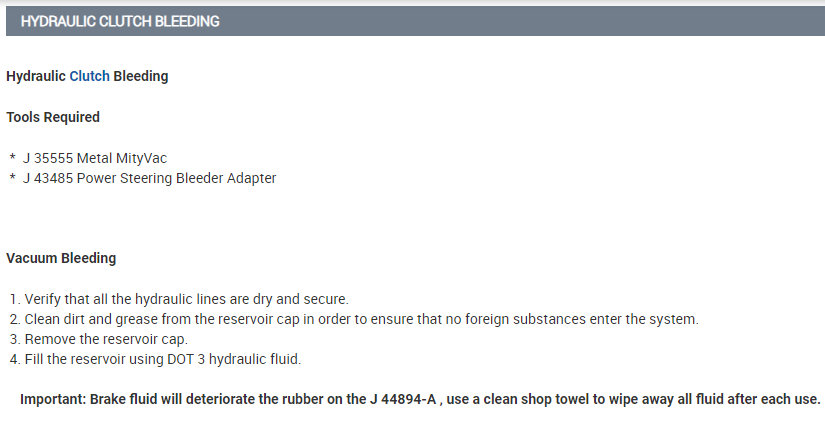

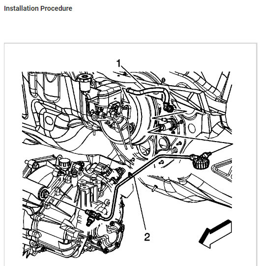

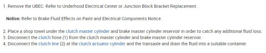

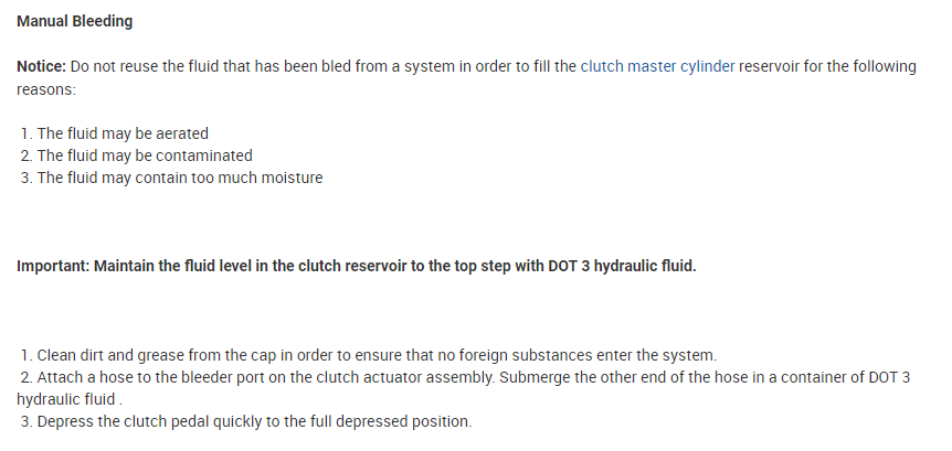

So I can get to the hydraulic line that's connected to the Master Clutch Cylinder. I asked earlier but if there was more images or videos available to show. As they say easier to show then to say. If you can provide further data on the process? Greatly appreciated, thank you.
