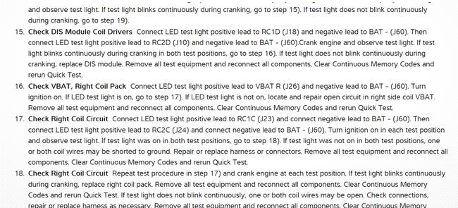

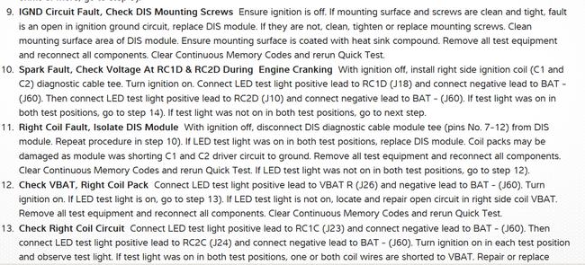

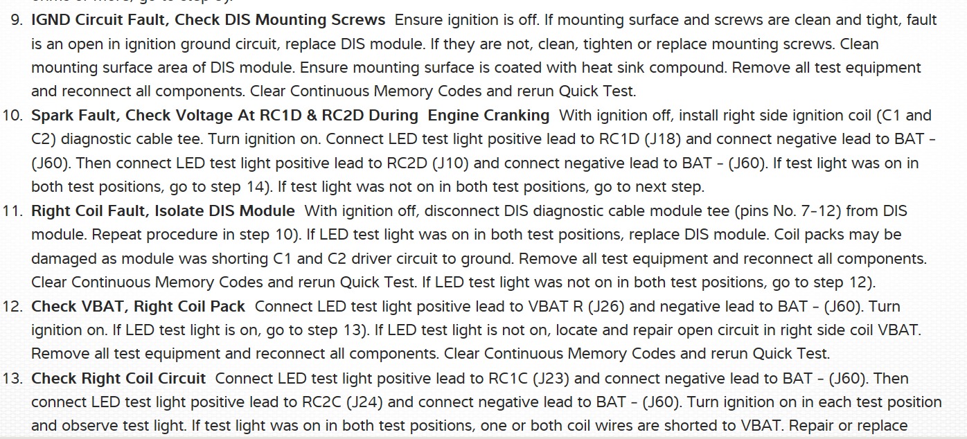

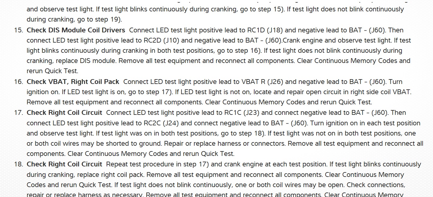

I don't have fire to some of the spark plugs brand new coil pack was put on one coil pack has fire the other don't will turn over just wont start

When you turn the key to the on position without cranking the engine over can you hear the fuel pump run in the tank for 5 seconds?
Please run down this guide and report back. scan for codes first see pics for diagnosing
Tuesday, March 2nd, 2021 AT 7:00 PM (Merged)
DANIELLE35
We did it didn't have any
HMAC300
  • 48,601 POSTS
Then do the testing which I sent in last reply

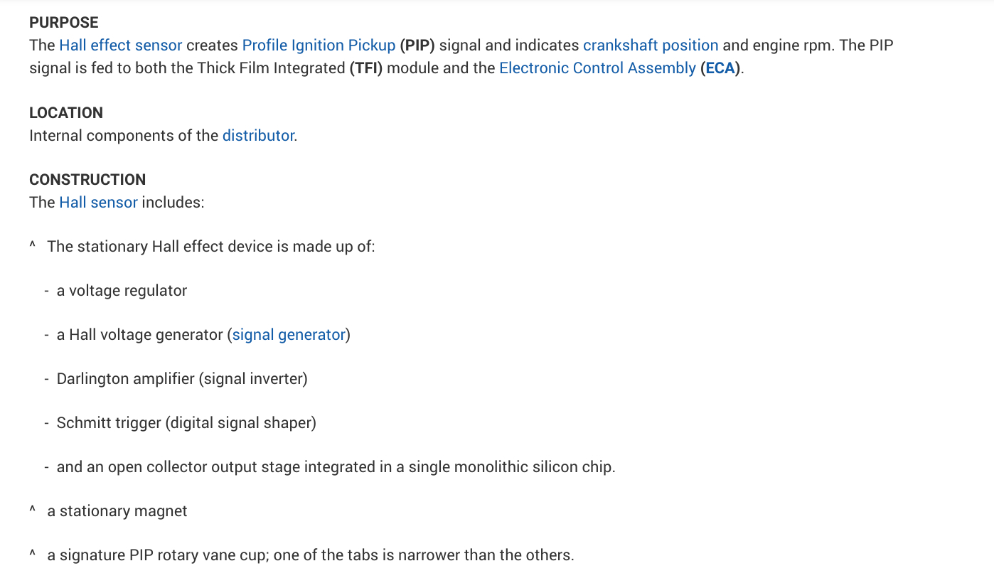

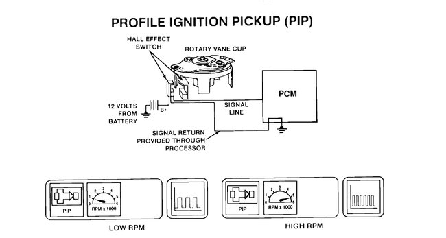

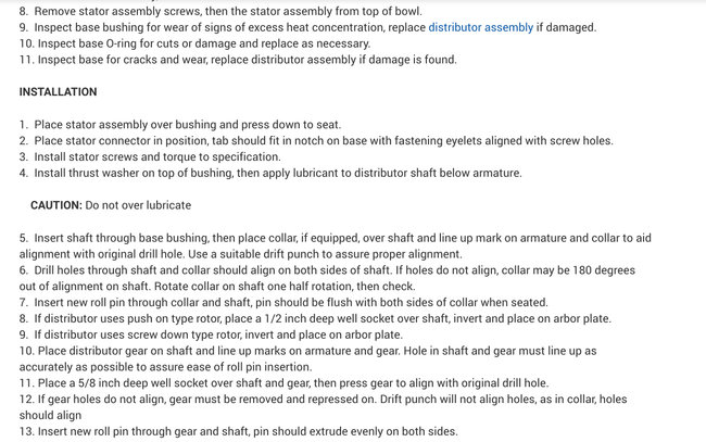

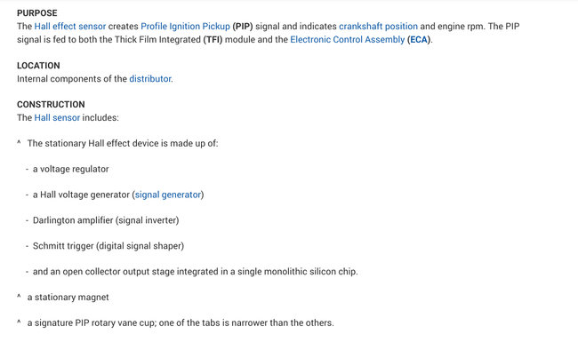

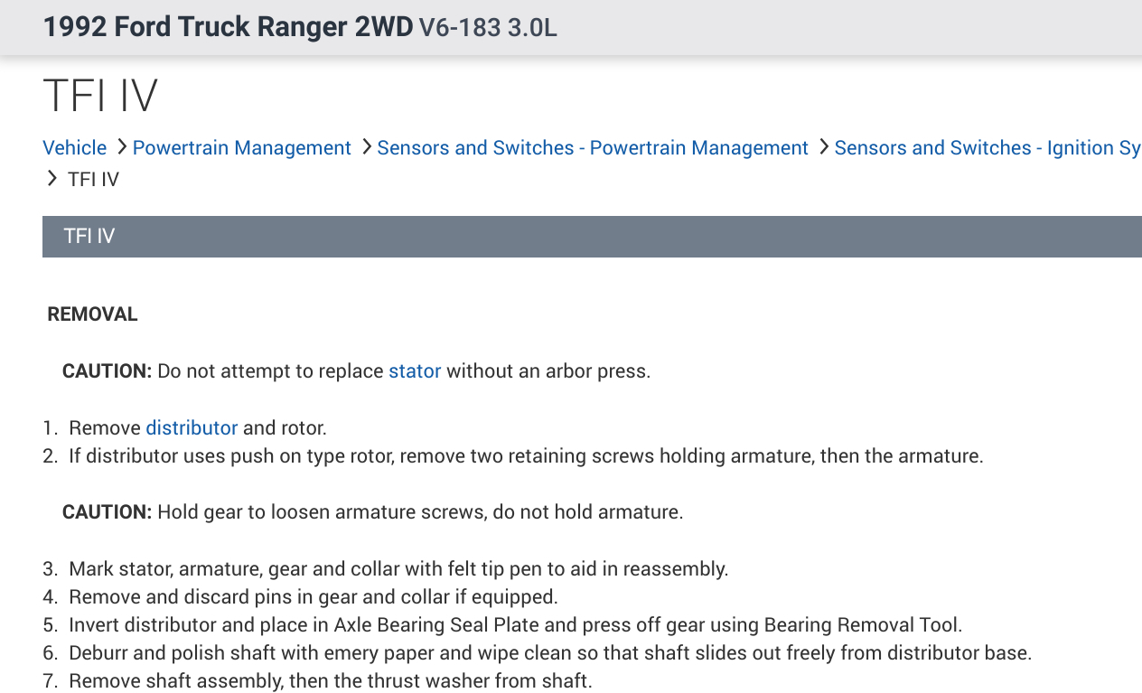

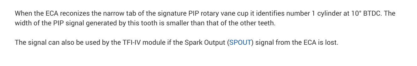

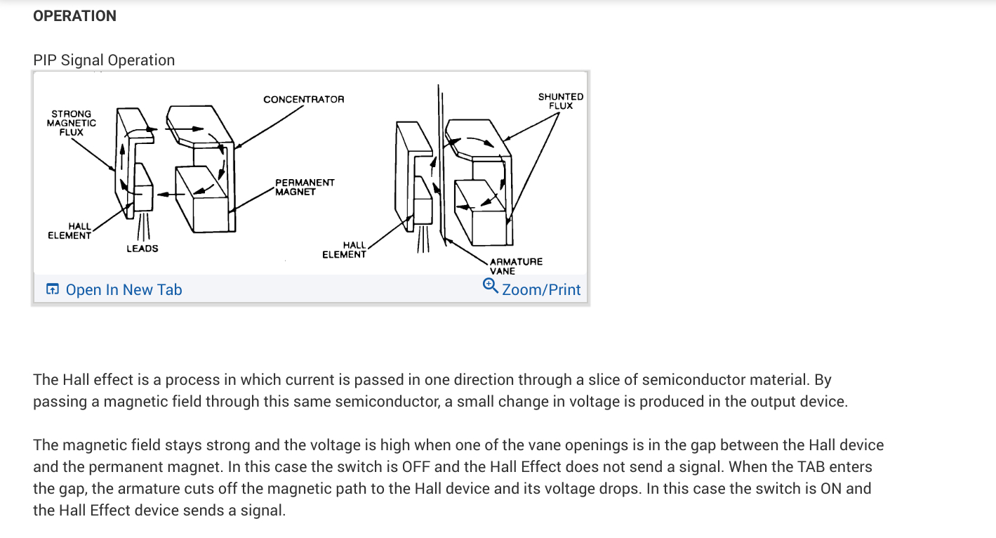

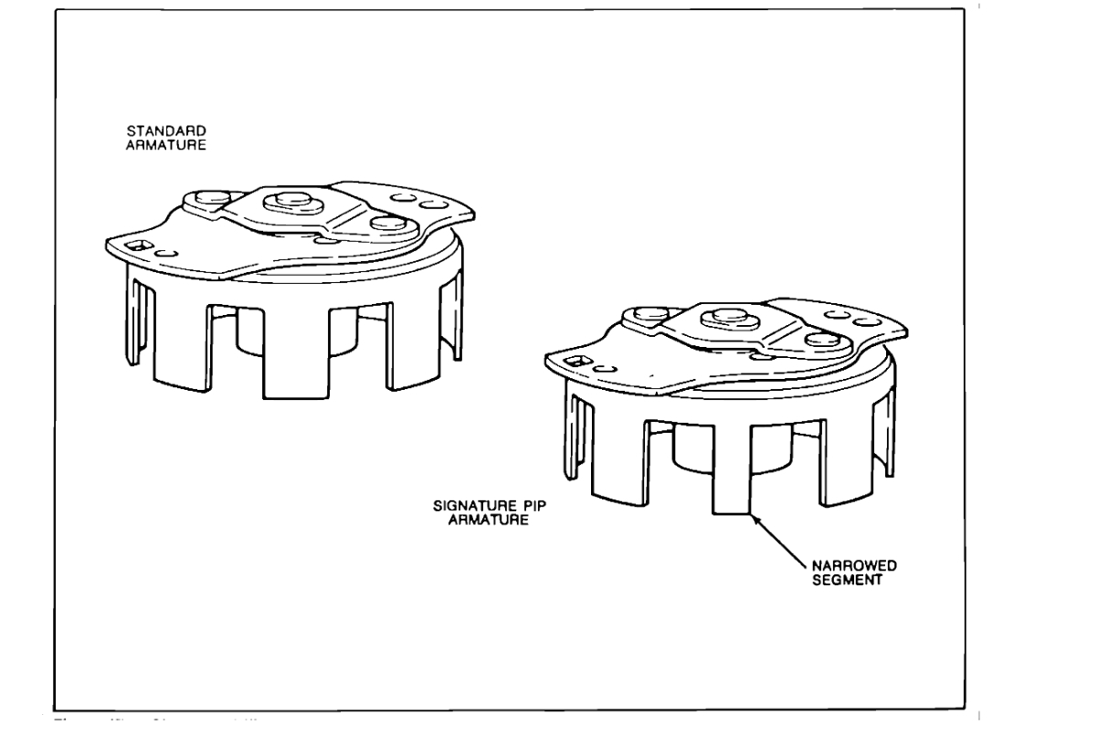

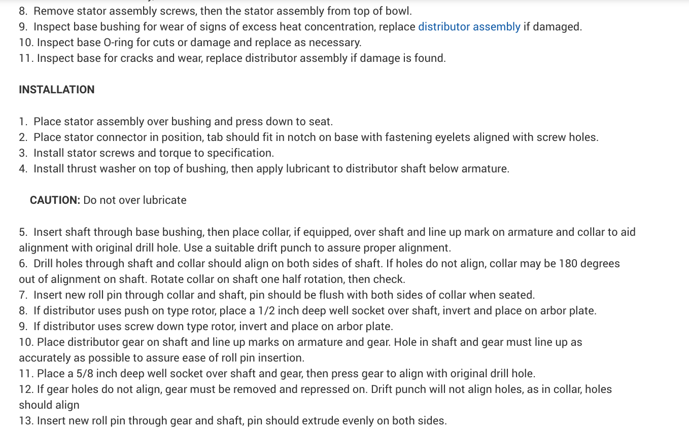

SCGRANTURISMO
  • 4,897 POSTS
This could be from a couple of different things, your vehicle's Profile Ignition Pickup[PIP] or the Idle Air Control valve [IAC]. First let's start with the PIP which the Power-train Control Module [PCM] uses for ignition timing through the SPOUT. In the diagrams down below I have included the description and instructions on how to replace the PIP in your vehicle. Please go through these guides and get back to us with how everything turns out. We can go from there if necessary.

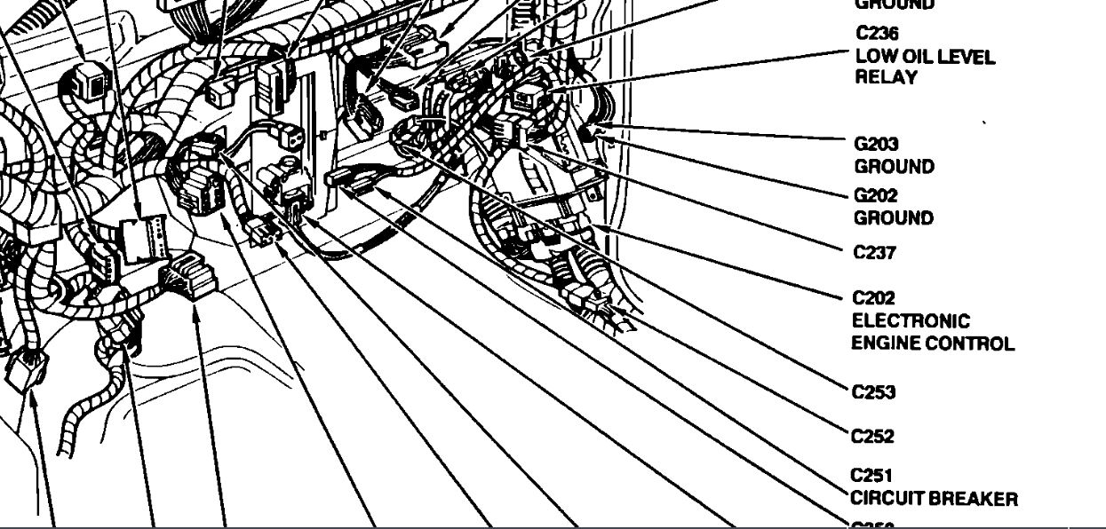

Engine will crank but not start sometimes like it’s not getting fuel. Fuel pressure is good, pump is new, new fuel pressure regulator, new coil, plugs and wires also new battery. If the fuel pump continues to run with key on it will not start. If fuel pump primed then shuts off will start on its own and run fine. It’s sort of a quirky thing where if it doesn’t run right check engine is on, surges, then eventually high jump in rpms and then runs fine And check engine light goes out.I usually only have to use starting fluid when it does this and engine is cold, otherwise when it’s warm and I shut it off it will turn back on. If check engine is on and running rough when I turn it off if I start it right back up it will start but check and is still on and runs rough until it does the RPM jump I think it may be the computer whatever it is it’s making me crazy Any help is appreciated thanks.
Tuesday, March 2nd, 2021 AT 7:01 PM (Merged)
Good morning.
The fuel pump should only run 2 seconds for priming.
It sounds like you have an issue with the ECM. The scan tools for the old systems did not give a lot of information for diagnostics.
Based on these results, it sounds like you need an ECM.
It is located in the right lower kick panel. I attached a picture for you.
The Electronic Control Assembly (ECA) stores information about vehicle operating conditions and uses this information to compensate for component tolerances. When an emission related component is replaced, Keep Alive Memory (KAM) should be cleared to erase the information stored by the processor from the original component.
To clear the KAM, disconnect the battery negative terminal for five minutes or more. Drive the the vehicle for at least ten miles to allow the ECA to relearn the values for optimum performance.
NOTE: During the ten mile relearn drive, the vehicle may exhibit some driveability symptoms. These should be eliminated when the KAM has relearned the operating values.
