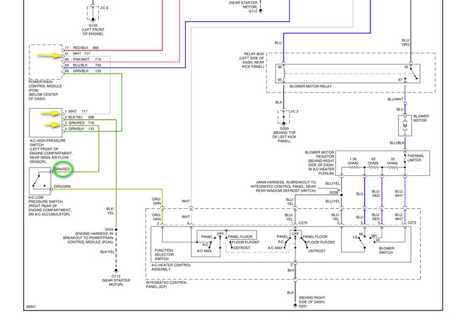

I replaced the coolant temperature sensor because I thought it wasn't turning on my fan when the temperature was reached. Actually, my old one was still good which I found out later. After I replaced it (plug and play job), it was very hard to start the engine so I hard to put the old one back. After that, my radiator fan (low speed) won't turn on again even when the temperature was reached. And I tried to turn on the A/C and I could see my A/C clutch did not engage nor the high-speed fan will turn on. I have removed the fan and tested the low and high speed with a 12V battery and they both work. I also tried to short out the 2 pins to the coolant sensor, but the low speed won't turn on. I have replaced the CCRM (Z refurbed by Cardone)) 2 times and nothing changed. I'm totally lost in troubleshooting this problem now. Could this be the PCM/ECM problem, or should I try with a genuine Z CCRM from a junk yard/eBay? If I replace the PCM, do I need to re-program it?
Mar 13, 2024 at 5:36 PM
BORIS K
  • CAR REPAIR CONTRIBUTOR
  • 836 POSTS

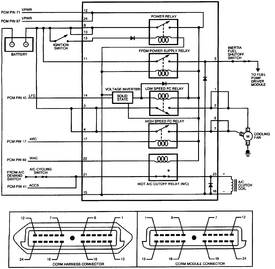

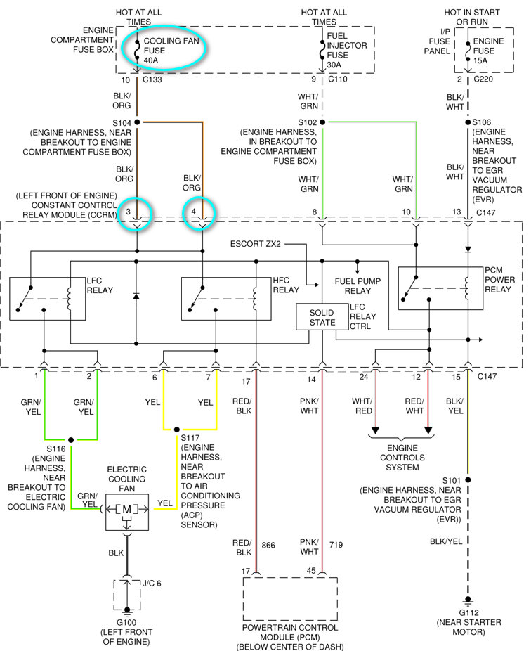

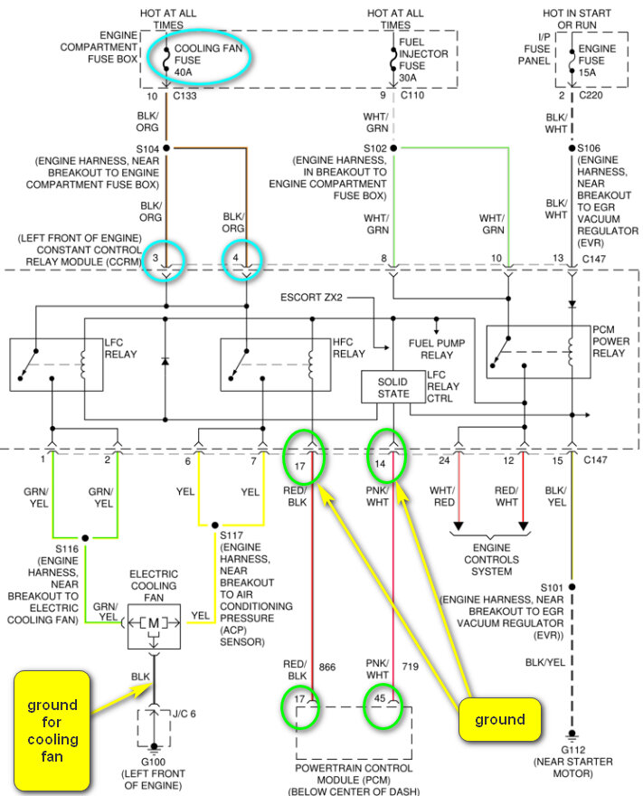

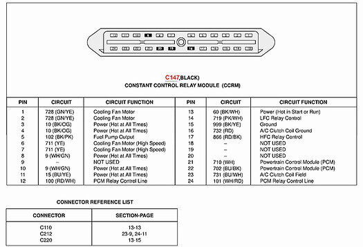

I would suggest first checking the cooling fan fuse, 40A, in the engine compartment fuse block.
This fuse supplies constant 12V to pins 3+4, black/orange wire, at the CCRM.
Check that the fuse is good and that you have 12V at both pins of the CCRM.
See image 1 below.

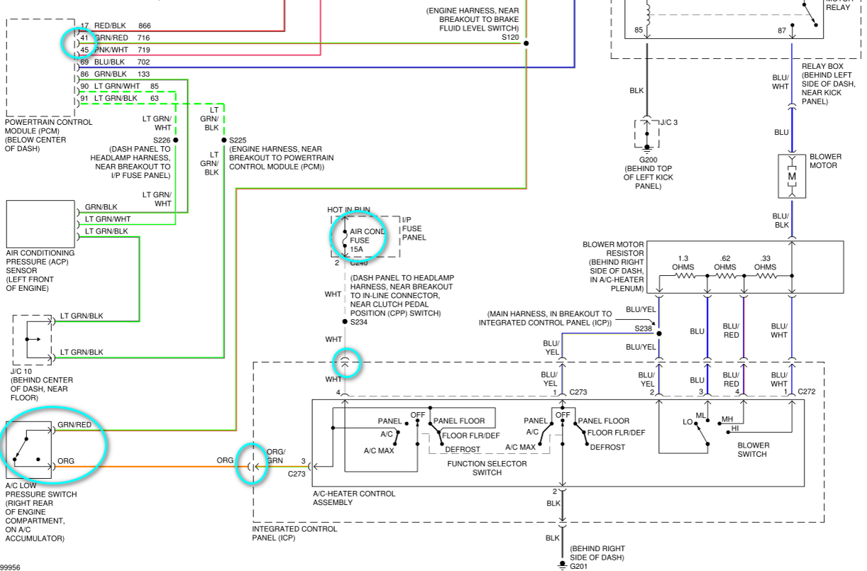

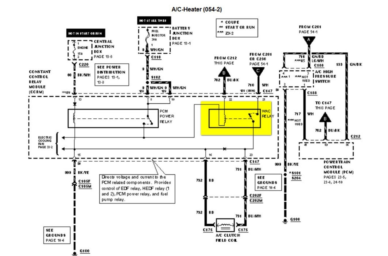

Regarding A/C compressor not kicking in I suggest to first check air con fuse (15A) in instrument panel fuse block.
This fuse supplies ignition 12V on white wire to the A/C control panel
The A/C control panel supplies 12V out at orange wire to the A/C low pressure switch.
If there is sufficient refrigerant in the A/C system this switch will output the 12V on green/red wire to the PCM pin 41 and to the WAC relay in the CCRM module.
I suggest checking that there is 12V at the A/C control panel when the AC is switched on that there is 12V at the orange wire at the A/C low pressure switch.
check that there is 12V outgoing at the A/C low pressure switch on the green/red wire.
See image 2.

I checked the 40A cooling fan fuse and the 15A AC fuse and both are good. I also got my 12V at pins 3,4,10 and 11at the CCRM (hot at all times). My main concern now is to get the low-speed fan to turn on when the temperature is reached. I'll work on the A/C (high speed) fan after the low speed is fixed. Since my low-speed fan doesn't turn on, does that mean the PCM is not sending the fan control signal to the CCRM (pin 14)? Please give me guidance on how to troubleshoot. I have not touched any of the existing wiring in my car except the connector at the CCRM for testing. I doubt that this is a Ground issue either. It all started after I tried to replace my coolant temperature sensor.

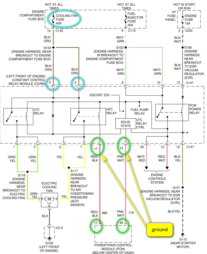

I would suggest checking the pink/white and red/black wires from the PCM to CCRM.
See image below.
How to test wire:
Also check if you apply a separate ground to pin 14 at CCRM if the low speed fan, then turns on. For this test the ignition needs to be on.
If it does and the wiring between the PCM and CCRM is intact, then this would point to a possible PCM issue.

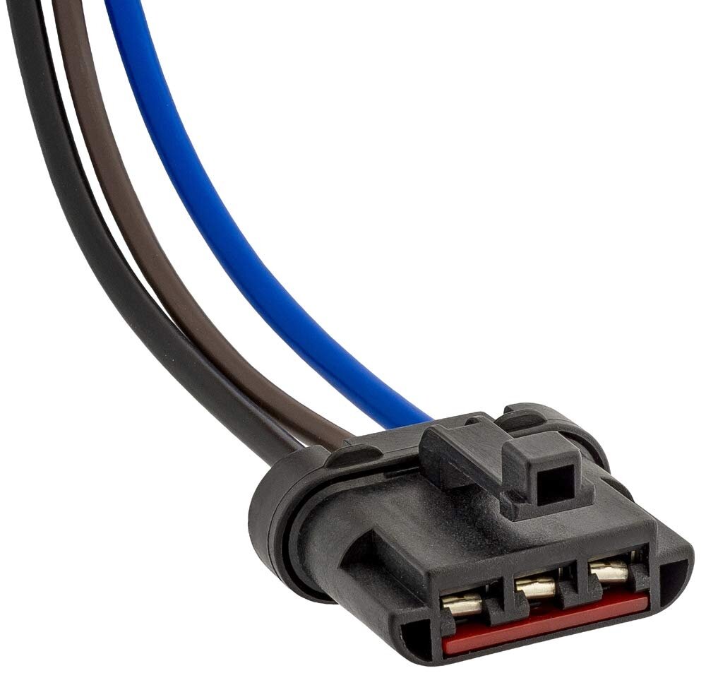

I opened up the radiator fan and checked for Ground at the connector terminals and I could find no Ground on any of the pins. I've found a picture of the connector online (attached). Is the black wire the Ground? My connector was all wrapped up and in a very tight space. According to the first picture you sent, it's BK and connects to J/C6, G100 on the left front of the engine. This is a very crowded area in my car, do you know where exactly/approximately it's at and what to look for?If I can't find it, can I just run a separate Ground wire straight to the connector? I hope this is my actual problem, if not, I'll have to start all over again.
Mar 17, 2024 at 4:37 PM
BORIS K
  • 836 POSTS
Yes, the black wire at the cooling fan connector is the ground, see image below.

I applied a ground to pin 14 of the CCRM (with ignition in ON position) and the low-speed fan still doesn't turn on. I have constant 12V at pin 3. If the CCRM is good, shouldn't the low-speed fan turn on? Because we're not using the ground from the PCM. A little confused here. Or with the ground applied at pin 14 and ignition on,I should get 12V at pin 1 and 2?
Mar 21, 2024 at 5:46 PM
BORIS K
  • 836 POSTS
The theory is with ignition on engine fuse (15A) in instrument panel fuse block provides 12V to pin 13, black/white wire, at CCRM.
This will trigger the PCM power relay which in turn supplies 12V to fuel pump relay, control inside CCRM (solid state relay), HFC relay and LFC relay.
The low-speed fan (LFC) control is via a commanded ground from the internal CCRM (Solid State) LFC control. This is applied externally from the PCM at pin 14 of the CCRM. The LFC relay is then switched on and supplies 12V out at pins 1+2, green/yellow wire.
The high-speed fan (HFC) relay is triggered directly by the PCM at pin 17 at the CCRM.
This then triggers the HFC relay and 12V is output at pins 6+7, yellow wire.

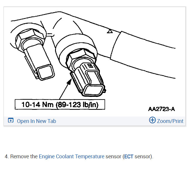

I need to check my coolant temperature sensor again.I searched online but found different values.Can you give me the correct resistance from 32 degrees F to room temp and 212 degrees F?
Apr 4, 2024 at 4:03 PM
ALOHA168
  • 52 POSTS
Also this sensor senses various voltages from the PCM. What is the proper procedure for this test?
Apr 4, 2024 at 4:14 PM
  • 54,436 POSTS
They don't give us those tests in Alldata, but I do know that if you over tighten the sensor, it can break internally. I would get a new sensor and compare the two. Check out the images (below). Let us know how it goes.

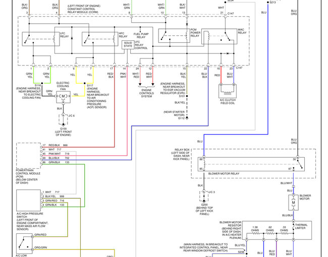

I searched the technical information system again and found a slightly different wiring diagram. This one shows a white wire at pin 41originating from the AC high pressure switch pin 1.
See images below.
Hope this helps.

The green/red wire between the AC Low and High switch was tested good in continuity. The White wire between the PCM and AC High pressure switch was good as well. I also have Ground at the Black/Yellow wire at the AC High pressure switch. The green/black wire between the PCM and AC High pressure switch was good too. I also used an electrical contact cleaner to clean the connectors before I plugged them back. The rest of the wiring between PCM and CCRM I've already tested 2 to 3 times already. After testing, I reconnected the battery and started the car and my fans are still not working. I'm pretty sure this is not a wiring problem anymore. The PCM and CCRM are the OEM units I bought at eBay which are supposed to be good, and they both behave like my original units. Could this be the CCRM 'solid state relay? I read online that a Ford mechanic mentioned that the ECT sensor is a Sensor, not a switch. If we short the 2 pins to turn on the radiator fan, it will damage the PCM. But I've already replaced the PCM and it's still the same. I've used boiling water to test my original sensor and it was within Ford specs and I installed it back on my car. Any new ideas?

On applying Ground to pin 14 and 17 with ignition ON,I tried that on all the CCRM's I bought and none worked.I don't think ALL of them can be bad(same symptom).I don't know what else I should try.Do you know how to test the ECT sensor voltages on the car with engine running?
Apr 23, 2024 at 10:19 AM
ALOHA168
  • 52 POSTS
If I use image1, connecting a Ground to pin 17 of CCRM with ignition ON,I should be able to turn on the High-speed fan because it doesn't go through the solid state anyway, but I can't. This is strange and all 3 CCRM's behave the same.

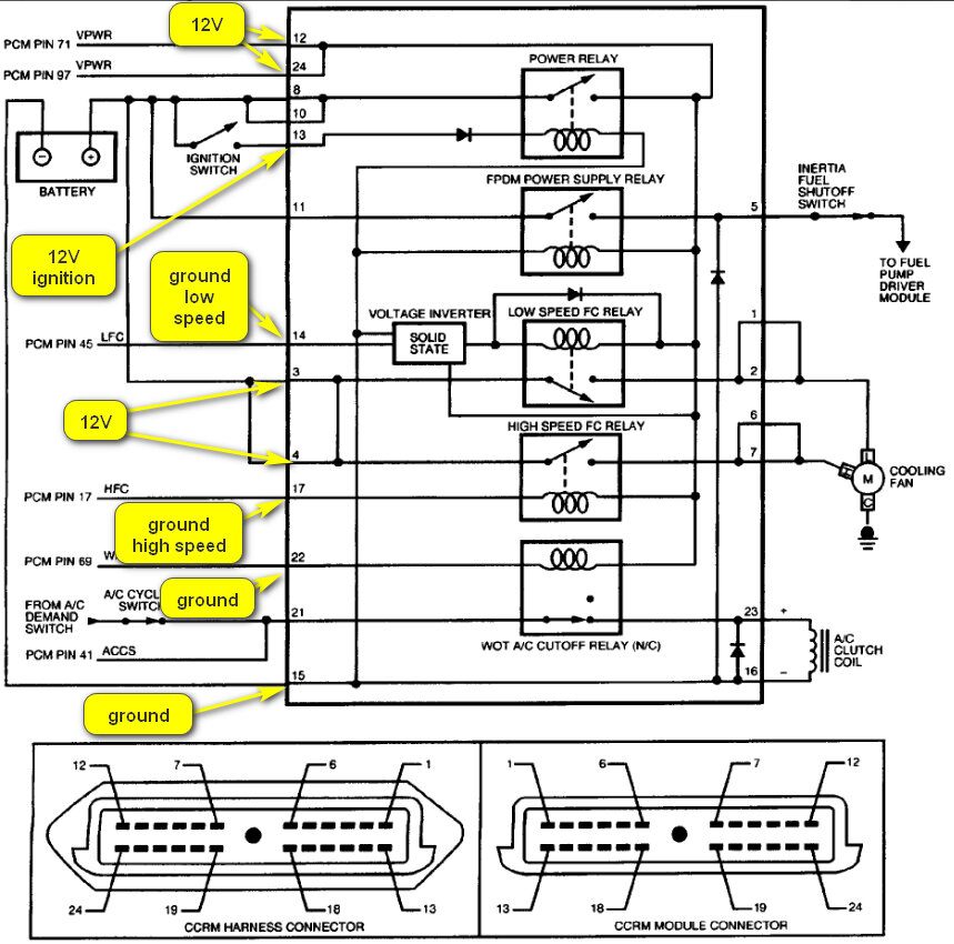

I have read back on all the information given.
I have consulted the diagram you have supplied and marked the pins I believe are responsible for the cooling fan activation.
On CCRM pins 8, 10, 11 should also have constant 12V.
Pin 21 would be a 12V switched from PCM.
Please see below.
