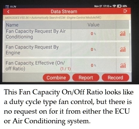

Also, I believe there is something wrong with the on/off ratio. I believe that the on/off ratio should be 10% for the fan to be off. Anything less than 5% would trigger the fan to stay on. Not sure why my on/off ratio for the fan is at 0%.
I got this information from this video: https://www.youtube.com/watch?v=1pfIXvp-2DE&ab_channel=jroncallo
He uses a fan from a Mercedes of the same year/generation, which all shared the same type of PWM signal.

AL514
  • 5,568 POSTS
It may not be reading anything from the ECM side if its ignoring the fan or due to a communications fault. If the ECM is not able to communicate with part of the AC system or the other way around, many fans will default to high because of that. Other manufacturers do the same thing. If theres a loss of comms with the ECM and the vehicle still runs for whatever reason they default the fan to high to prevent over heating to the engine, when engine temperature cannot be monitored correctly. From what Ive seen that seems to be the case and its a logical answer, its better to have an engine run a little cooler than over heat so they just blast the fan on high all the time. But yes a computer for this Im sure is expensive. I would try a used fan first and see theres any difference. 100K to ground might be ok, considering its a signal wire. I dont think that wire is meant to carry current, it seems more like how a fuel pump module receives commands with a 12v duty cycle signal. Have you scoped the network to see if theres any distorted looking waveforms, everything should be pretty square with that Can bus, dont dismiss the network fault codes, what if you replace the ECM and still have the same issue, most places wont take a used module back.

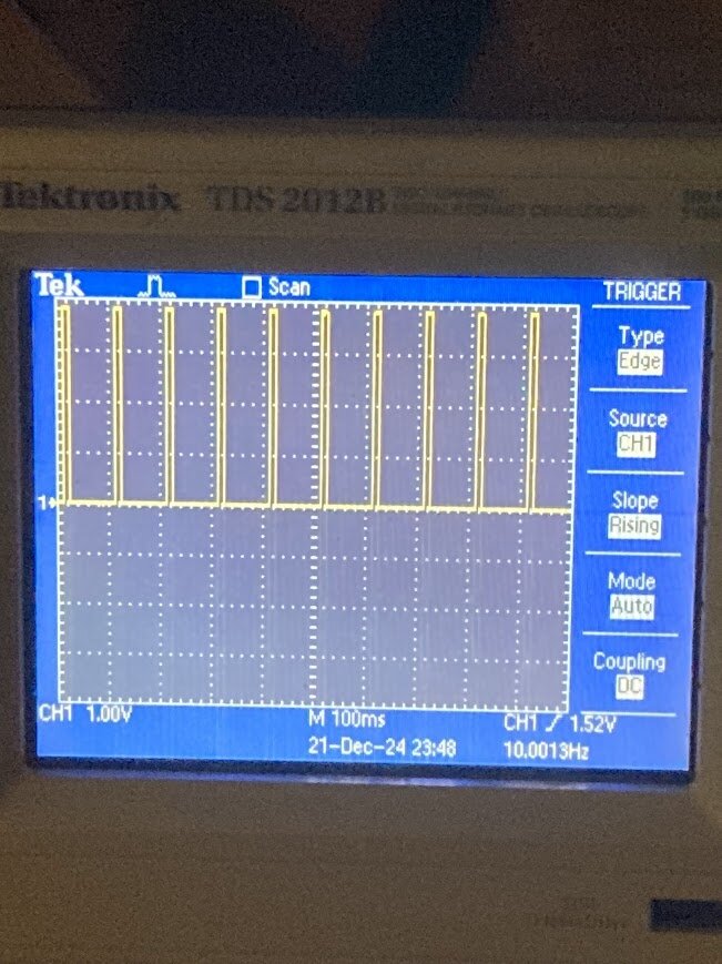

  • 70 POSTS
Here's what I did to test if everything is working. I disconnected the temperature sensor and kept the car in ignition. The PWM signal remained the same (the 3.5V-3.8V) peak-to-peak at 10hz with a 10% duty cycle. No changes there, even though it should be requesting the fans to be at full blast. Perhaps I can rule it as being the ECU here, as the ECU is not doing anything to change the radiator fan signal. It just seems fixed.

SOMEONE12132
  • 70 POSTS
Hey, so it seems that I have resolved the problem. It indeed was the ECU!
There is a Bosch 30344 chip that this radiator fan signal comes from on the ECU, and this chip seemed to be shorted/broken, which caused this corrupt PWM signal. I took a chip from another Mercedes with a ME 2.8 board, and swapped it onto my car, and it worked.
The PWM signal looks proper now, and the radiator fan doesn't go on full blast as soon as the car is put into ignition.

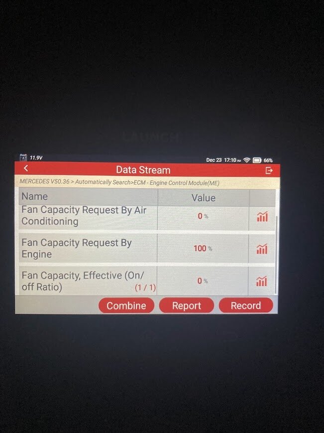

I'm currently suffering with a problem with my CLK where the radiator fan will not come on when the engine requests for the radiator fan.
I was able to determine this by disconnecting my temperature sensor, which forces the ECU to request the radiator fan to run at 100% as a safety measure.
I ran an actuation test of my radiator fan, and I was able to turn on the radiator fan this way. This means my radiator fan is probably fine, and perhaps my ECU as well.
I am more concerned about my radiator fan not running when my engine is requesting it to be on. It is causing my car to overheat in traffic. I'm not sure what it could be.

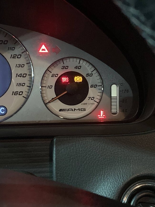

I'm not sure if this is the proper temperature for stop-and-go traffic, or if it is overheating. This is the max temperature it goes to in stop-and-go traffic, but it does go down once on the highway.

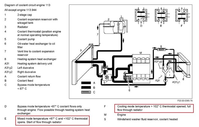

AL514
  • 5,568 POSTS
I assume you've cleared out all the codes after the last repair, what's the ECT getting to in the stop and go traffic (we'll call it city driving). It looks like 100c on the Cluster, so roughly 212f? Is that accurate to scan data? And are codes setting after 2 drive cycles?
Tuesday, March 4th, 2025 AT 1:58 PM (Merged)

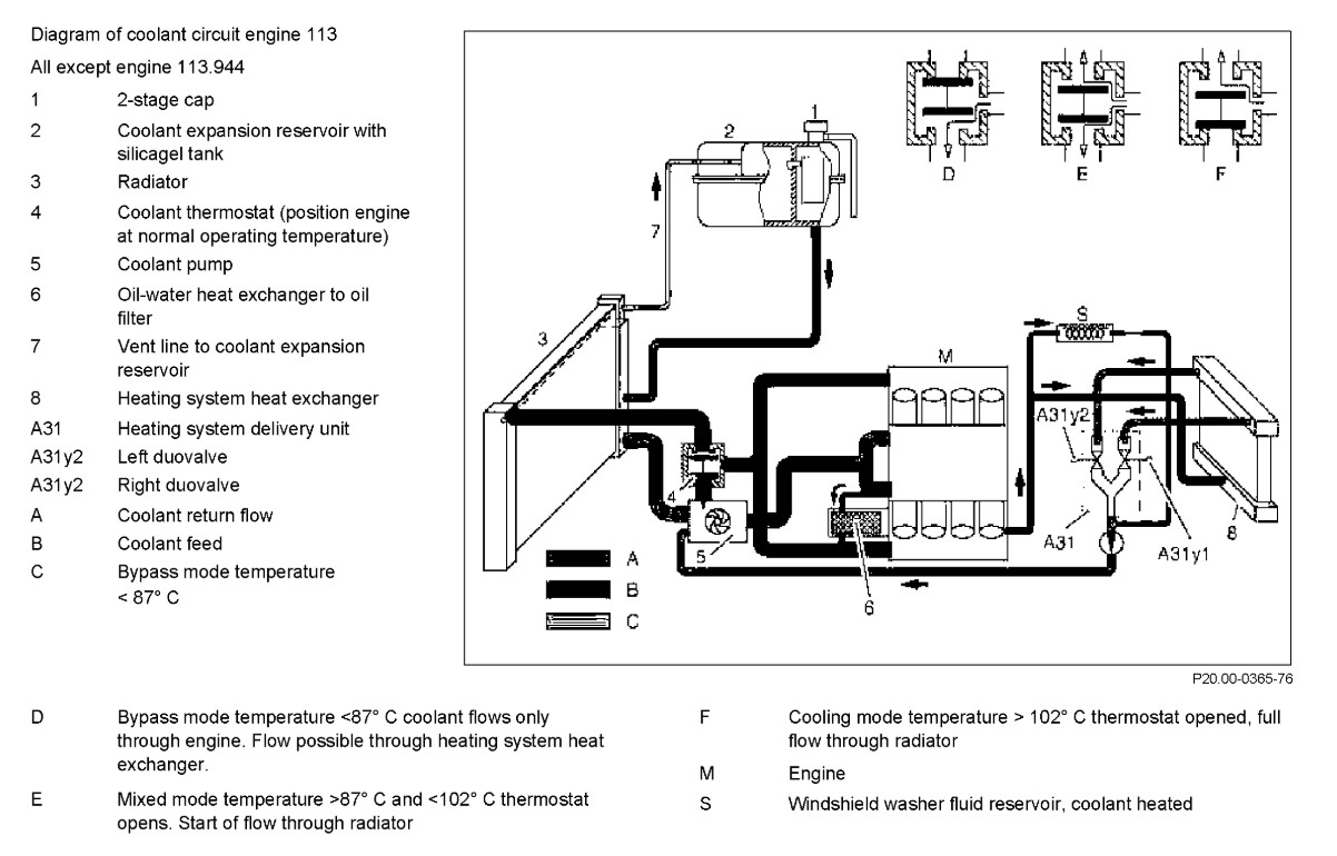

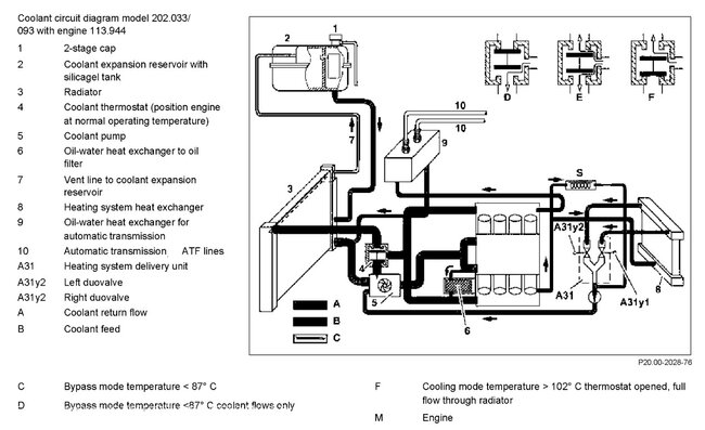

AL514
  • 5,568 POSTS

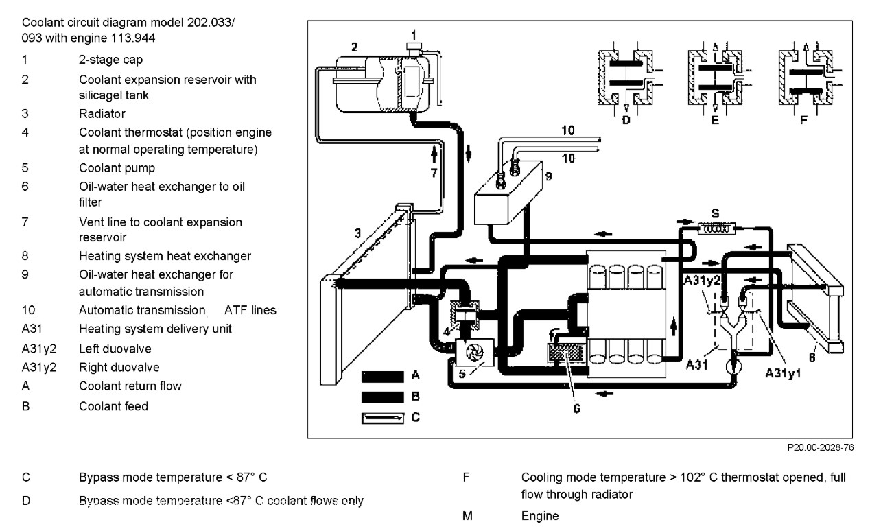

These are the two coolant system diagrams, pretty complicated thermostat setup, Mode F shows coolant temp greater than 102c, thermostat fully opens to flow through the radiator. So that would be its max temperature unless I can find a different spec.

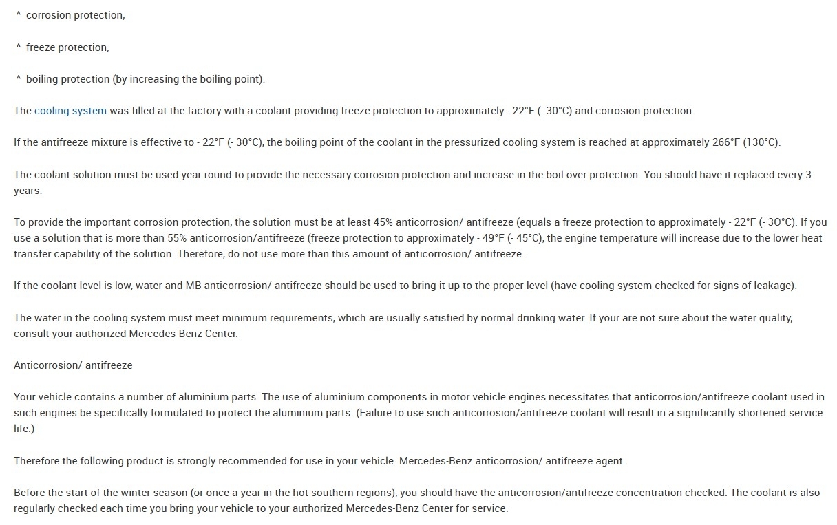

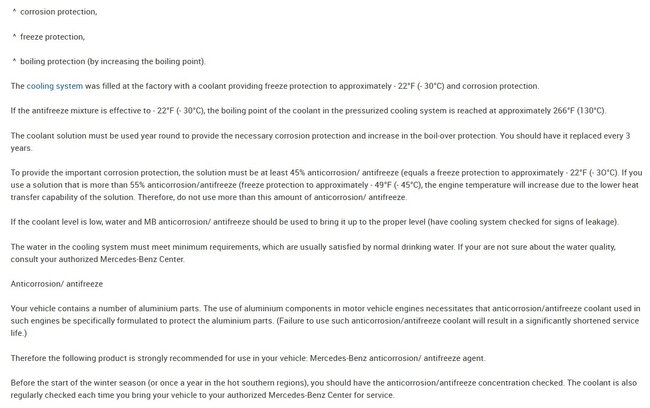

There are some pretty interesting info, along with the ton of other information on the cooling system, but I'm not sure what the water to antifreeze ratio is right now in the vehicle, but they have a very specific ratio spec and some reasoning behind it, if its 55% or more antifreeze, apparently this increases the boiling point of the mixture due to lower heat transfer of the coolant itself. So really it should be a 45% antifreeze ratio that will bring it to -22f freeze protection, But if there is a much higher ratio of antifreeze, which is difficult to tell unless its checked, who knows if the customer has just been dumping straight antifreeze in it over the years and the percentage is much higher now, you could check the concentration with one of those floating ball gauges, but it says to only use MB antifreeze as well. Not something that's well known I'll bet, about the boiling point changing according to the mixture. Regular people usually just dump in whatever is in their garage.

I'm not sure what color the MB coolant is, the green coolant is most likely just regular old antifreeze, but is the 100c temperature the highest it's getting on the gauge?
SOMEONE12132
  • 70 POSTS
Yes, 100C is the highest it gets on the gauge.

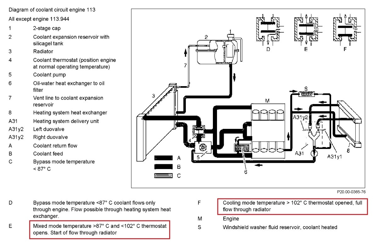

AL514
  • 5,568 POSTS
Well, 92c is only 197.6f, 97c is 206.6f, and on either coolant system diagram 102c is when the thermostat is fully opened and coolant is directed through the radiator, the 206f is okay with me, I know that a Subaru kicks on the cooling fan at exactly 204f because I used to work for them at a dealership. But remember that you did have a communications code from the Cluster to the ECM at one point, I'm not sure how much of the harness you have messed with since then, what's been unplugged and plugged back in, but I'm sure you would get a warning light on if the coolant temperature went too high. I know the temperature in Celsius can look foreign to us techs in the US, I usually just google a Celsius temperature to Fahrenheit, and it will bring up a conversion chart, it's just easier for me to see it that way as well.
Tuesday, March 4th, 2025 AT 1:59 PM (Merged)
