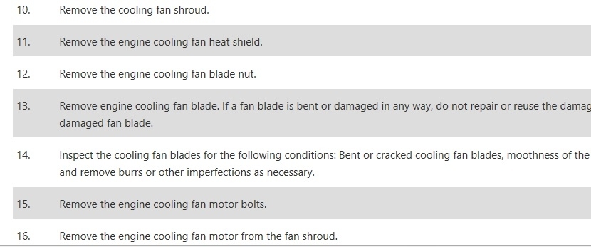

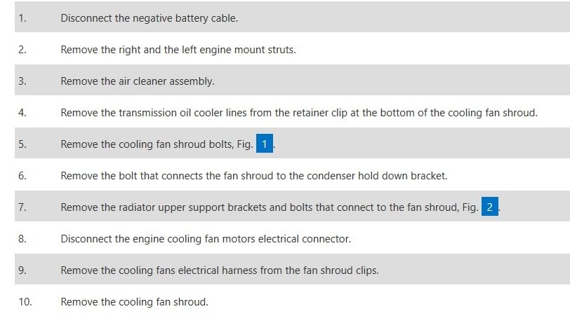

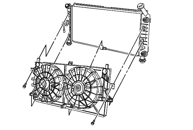

How do I remove the dual radiator fan?
Friday, March 1st, 2019 AT 7:49 AM
5 Replies
JDL
MECHANIC
16,098 POSTS
Hope this helps.
Images (Click to make bigger)
Friday, March 1st, 2019 AT 1:11 PM
GARRY FITCH
MEMBER
3 POSTS
Thank you so much for your reply, very informative. I will proceed with caution, and if I get stuck after those instructions I will holler! :)

Thank you, JDL. I have done it! And it only took three hours. :) The new fan unit is installed, and both fans are working.
