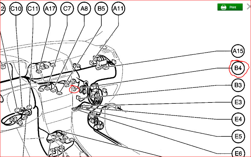

Hello, I'm Danny,
You might want to check the blower motor resistor. I've attached a picture of its location B4 on the picture and circled it in red. Check to see if the connection isn't frayed/burnt/loose/corroded. Here is a few tutorials for you to view as well:
https://www.2carpros.com/articles/blower-fan-motor-works-on-high-speed-only
Hope this helps and thanks for using 2CarPros.

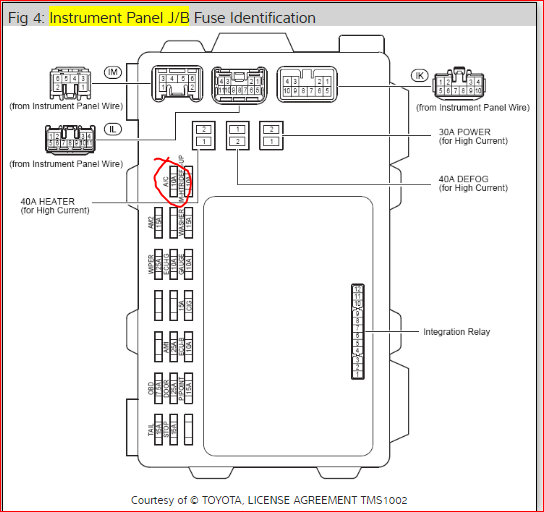

I notice the light doesn't come on the air condition dash board but all the others do? Is that a fuse problem?
Wednesday, December 19th, 2018 AT 12:23 PM
DANNY L
  • 5,648 POSTS
Hello again,
Did you check the Instrument panel I/B fuse location? Here is a tutorial for you on how to check:
I've attached a picture of the I/B box and its location. It's a 10 amp fuse. Hope this helps and thanks again for using 2CarPros.
Danny-
Thursday, December 20th, 2018 AT 1:28 AM

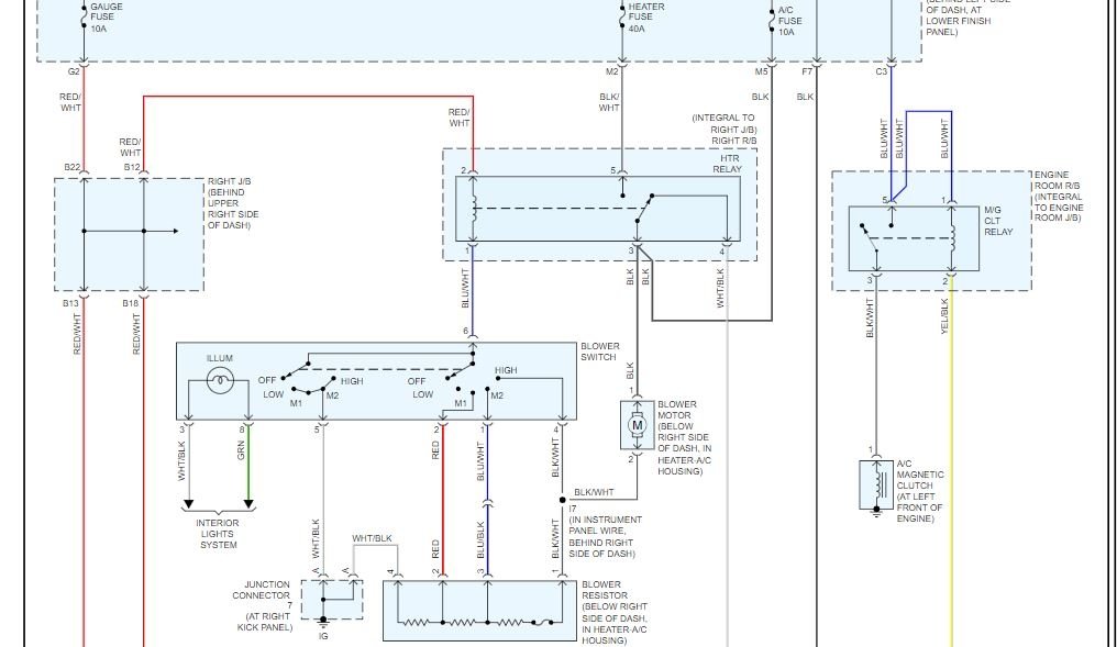

I put in a new blower it worked then the next day it didn't. I just put in a new resister. Still doesn't work at all. I notice the air condition light doesn't come on but all the other lights on the board work. I am wondering is this a heating and cold fuse problem? Thank you again.
Thursday, December 20th, 2018 AT 5:25 PM (Merged)
Good afternoon,

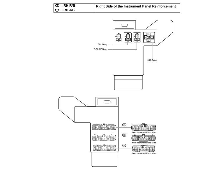

I attached a wiring diagram for you to view. there are three fuses at the top. check those fuses for power on both sides with the key on.
beyond that you will need to go to the blower relay to verify power at the relay itself.
