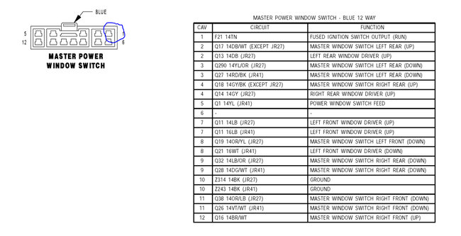

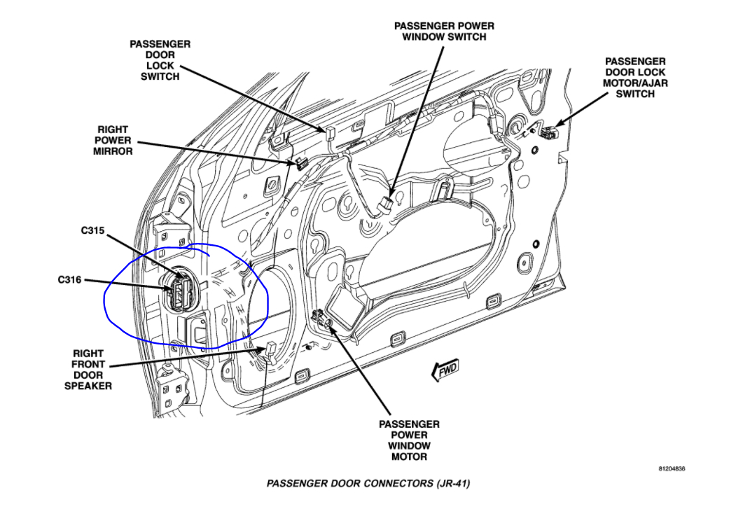

I've changed the fuses in the power window circuits both under the hood and the interior fuse panel, but none of the windows or door lock switches will work still. Is there another fuse somewhere else in that circuit? Or if the driver door window motor burned up would that cut power to all of the other window motors?
Mar 16, 2021 at 2:01 AM
  • CAR REPAIR CONTRIBUTOR

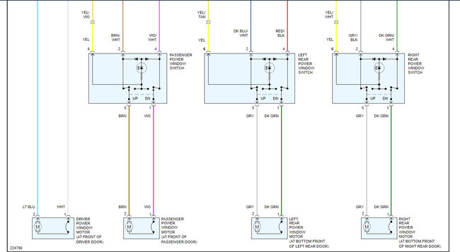

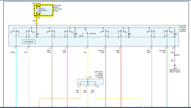

Good morning,
I attached the diagram of the window circuit for you to view. Verify power on both sides of the circuit breaker with the key on.
If you have power, go to the switch and check for power at the tan wire on the connector. That is the main feed for all the window operations.
