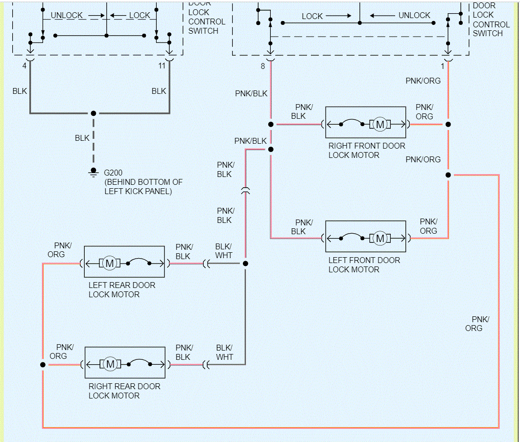

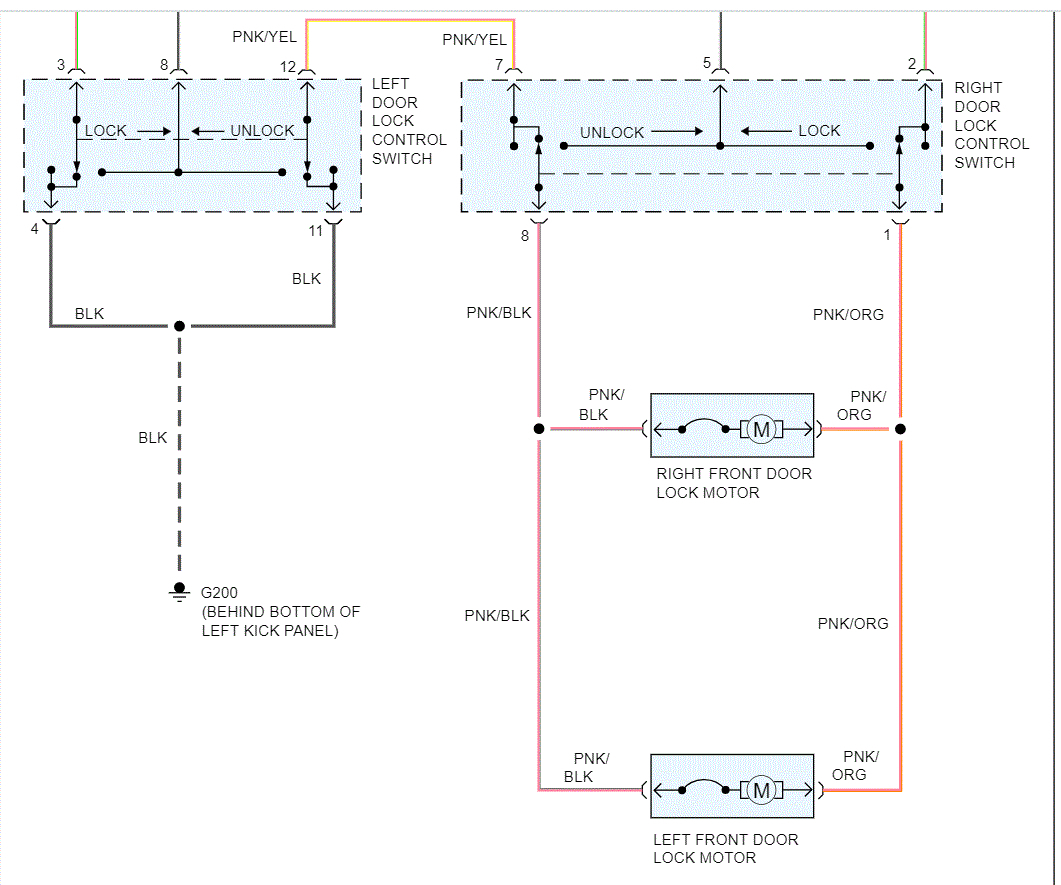

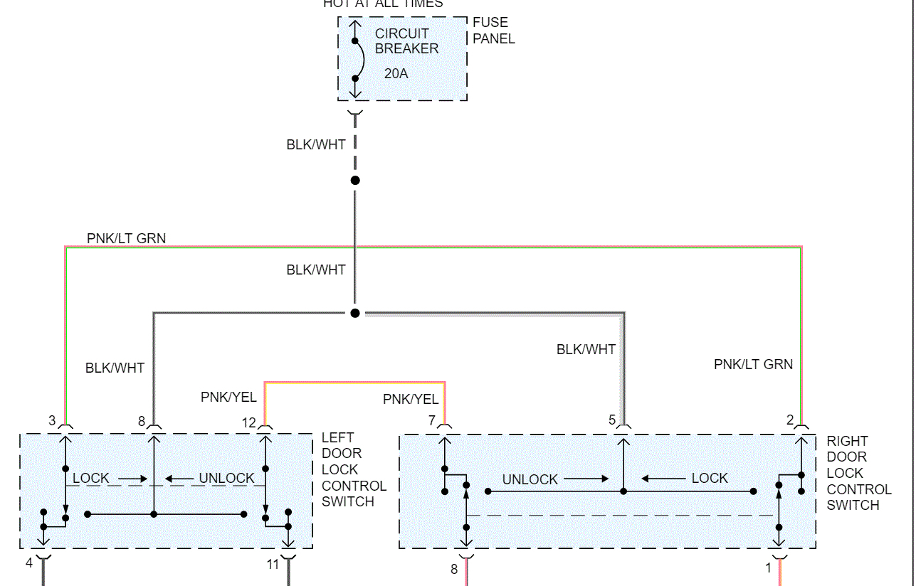

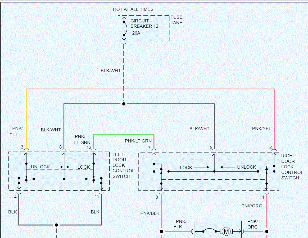

What I am providing are wiring schematics for the door lock system. Not being there with you, I can't see what has been done. However, look through these pics and see if they help.
Now, I don't know if you have a regular cab or crew cab, so I will provide schematics for both. The first two are for a regular cab. Pics 3 and 4 are for a crew cab.
It really isn't a complex system. However, when someone cut things up, that can make it difficult. Here are a few links you may find helpful when testing:

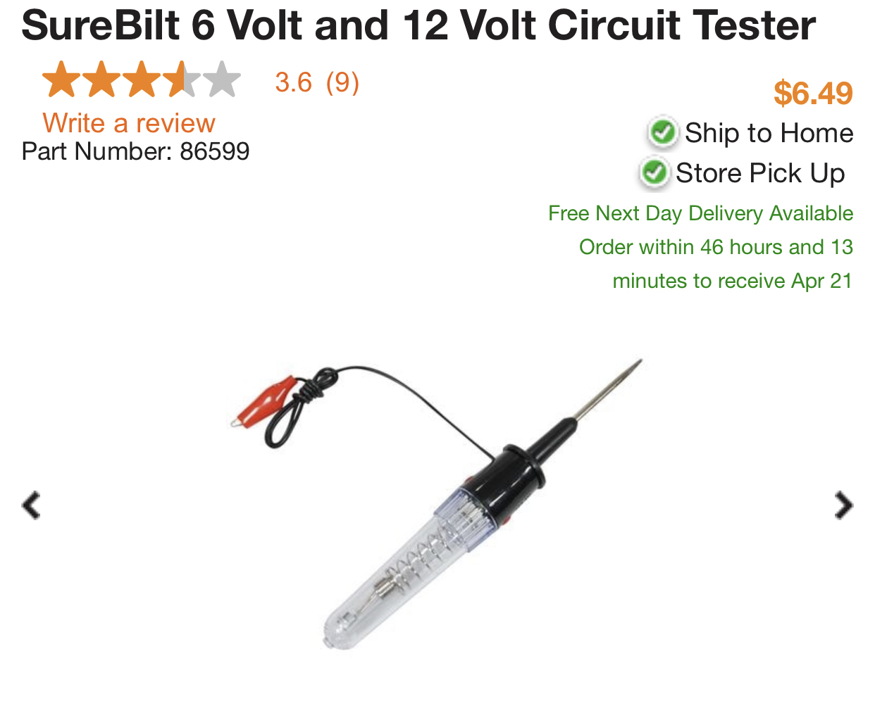

The only thing I have is a bulb circuit tester. I have checked at the fuse and it is good. Anywhere else I can check and test with the bulb tester? I don’t own a volt meter and would like to avoid buying one if possible especially since it’s so hard to get out with the coronavirus situation.
Is there anyway to test wires with my little circuit bulb tester?

I will upload a picture of my dinky circuit tester.
Saturday, April 18th, 2020 AT 8:47 PM
  • 110,194 POSTS
There is nothing wrong with the test light. It will work perfect.
