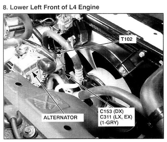

I was on my way to work today and all of a sudden the radio started to turn on and off it was then that I noticed my gauge for the idle was stopped on 0 and my car shut off. I have jumped it then as soon as I turn the headlights on the car shuts off. Please help. Thank you. Sincerely in advance.

It sounds like the battery went dead. This could be the result of a failed battery or alternator. First, make sure the battery terminals are clean and tight. Next, recharge the battery. If you don't have a charger, most parts stores will do it for you free of charge.
https://www.2carpros.com/articles/how-to-charge-your-car-battery
Once the battery is recharged and you can start the vehicle, follow the directions in this link to test the alternator.
If the alternator is working as it should, take the vehicle to a parts store and have them load test the battery or perform this test. If it fails, replace the battery.
Here is a link to help if it is determined the battery is bad:
https://www.2carpros.com/articles/how-to-replace-a-car-battery
Now, if the alternator fails and it isn't the battery, here is a link that shows in general how an alternator is replaced:
https://www.2carpros.com/articles/how-to-replace-an-alternator
Also, and this just popped into my mind, make sure the belt is tight to the alternator.
I attached a pic below showing the alternator location. If you plan to remove it, make sure the battery is disconnected before working on it.
Let me know if you have questions. If you find the problem and have a chance, let me know what it was.

It is the alternator a friend told me to jump the car and with it running disconnect the positive battery terminal and if it dies then it probably will be the alternator. You learn something new everyday I guess thanks again.
