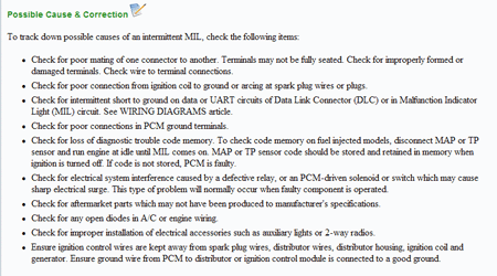

Typically the engine will stall after 10 mins of driving or the engine running. The engine just stops, no sputtering, the tach needle drops to zero, and previously the ignition/batter lights would not light up when this happened. It will not restart right away. Usually requires 5 to 10 mins wait time before it will restart. Otherwise it won't start up. I had the ignition switch replaced this week after detailing the problem to the technician. Because the ignition/batt lights didn't come one when it stalled previously. But discovered the same problem remains and today it would stall/shut down even more frequently. I limped it back home but it's not good for any trips over 10 mins.
