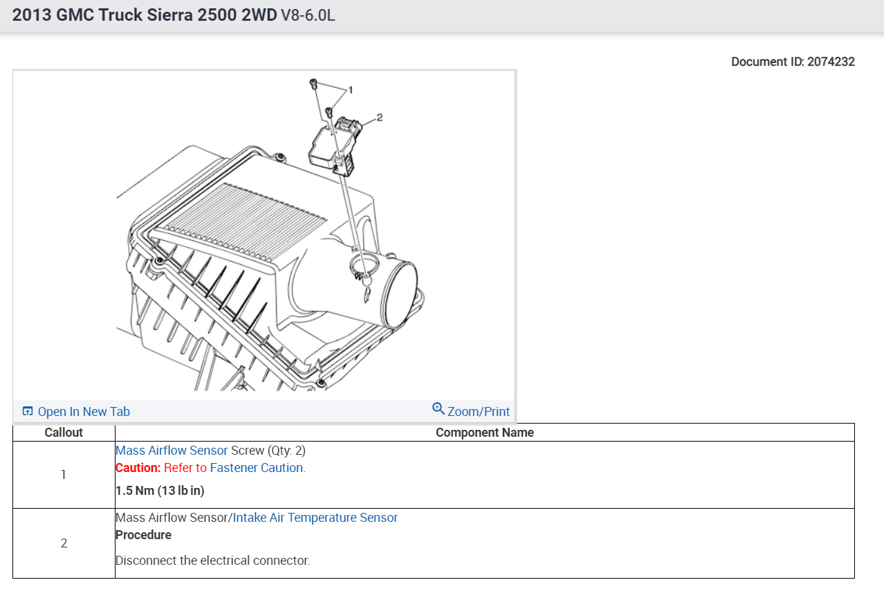

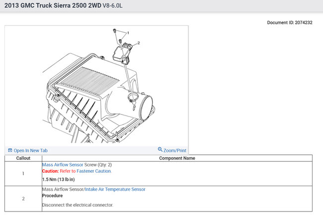

Also, it could be the MAF sensor needs to be replaced.
Here is a guide below that can help as well:
https://www.2carpros.com/articles/engine-has-low-power-output
Here is how to change the MAF sensor out in case you need it. Check out the images (below). Please let us know what happens.

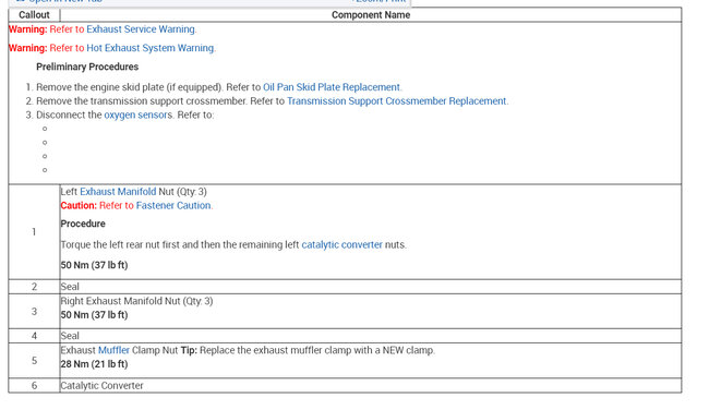

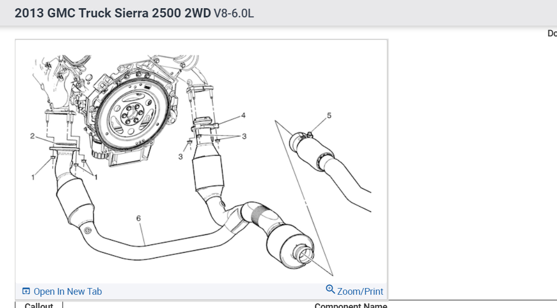

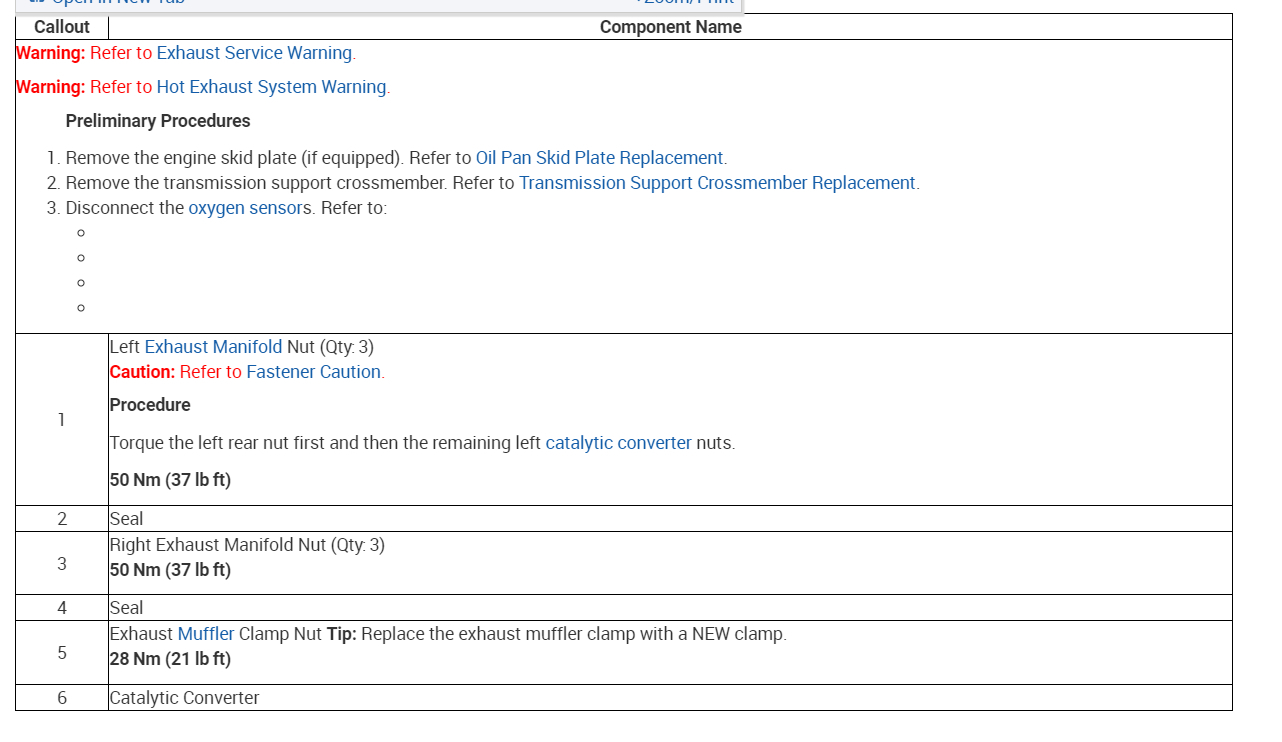

So, we need to check the catalytic converter because if it is partially clogged it can cause these codes.
This guide can help:
and
https://youtu.be/CORe9JyrexI

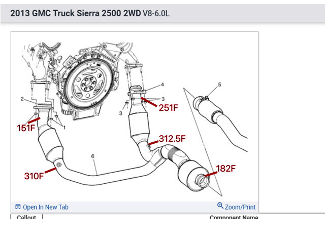

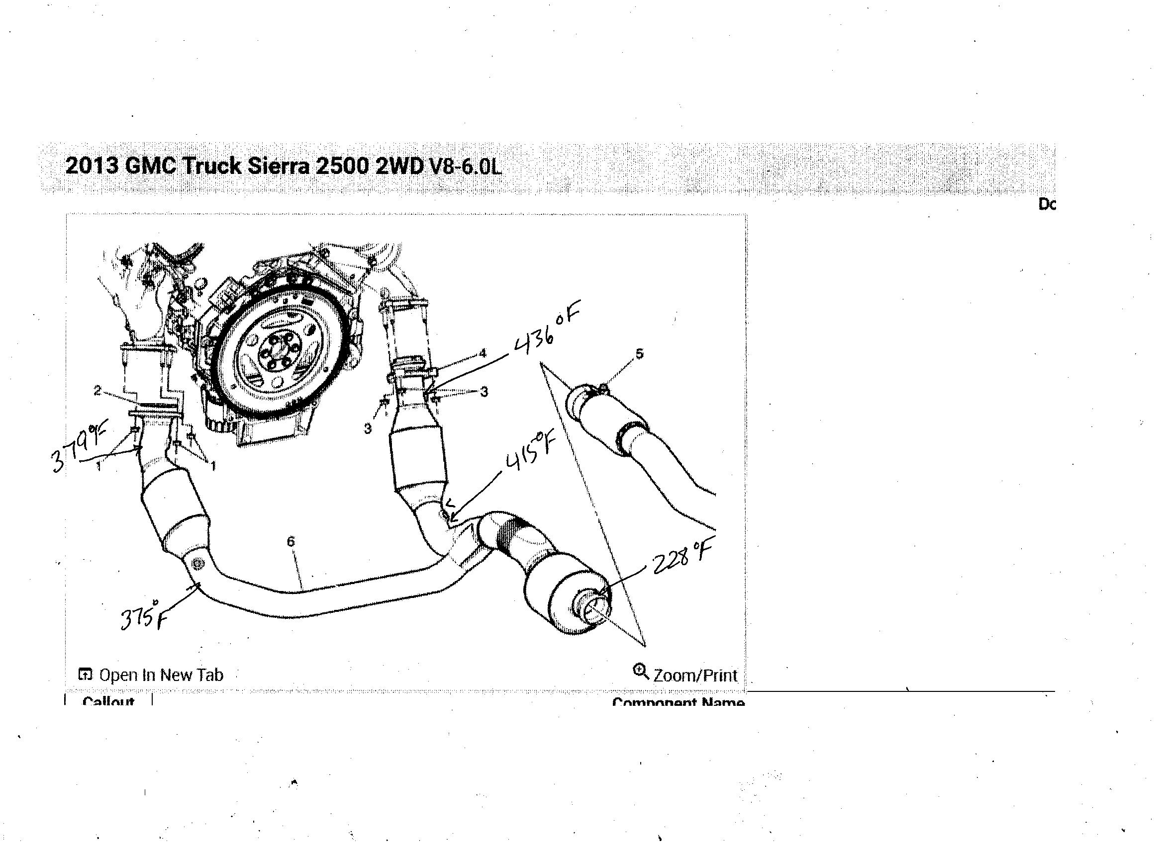

I got the engine to normal temperature. Turned off truck and took the following readings. I have attached a photo.
Saturday, June 17th, 2023 AT 5:43 AM
KEN L
  • MASTER CERTIFIED MECHANIC
  • 55,486 POSTS
The truck needs to be running when taking the readings but from what I can see the cats might be clogged up. Please resend the readings.
Monday, June 19th, 2023 AT 9:49 AM
RONALD DEVOLD
  • 134 POSTS
I retook the temperature reading while the engine was hot at normal temperature.
Tuesday, June 20th, 2023 AT 7:17 PM
KEN L
  • 55,486 POSTS
The first cat looks okay, but the rear cat looks like it might be clogged. Also, I noticed a big difference in the input temperature on the driver's side, is the engine running smoothly?

I'm still have a delay or drag when accelerating. I'm working with another member on a knock sensor code. And I forgot to mention that I cleaned the MAF Sensor, and that code went away. I only just have the P0332 code.

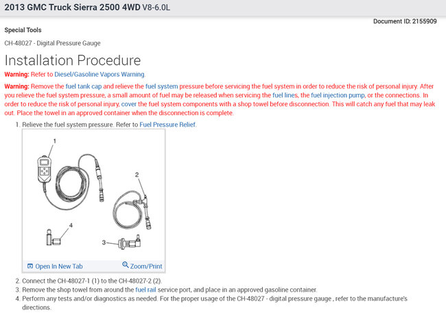

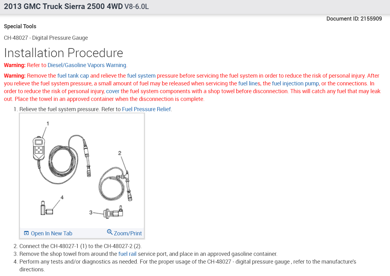

I would do a fuel pressure test because lack of fuel can make it ping and cause the code. You can rent a fuel pressure gauge at the local auto parts store for cheap or free here is a guide to help.
The fuel pressure should be about 60 PSI

I have 52 PSI of fuel pressure.
Saturday, June 24th, 2023 AT 5:00 AM
RONALD DEVOLD
  • 134 POSTS
I connected the gauge and turned the ignition on. The pressure gradually went to 54 PSI and slowly dropped to 52 PSI. Started the engine and the pressure jumped to 60psi. I applied the emergency brake and put the truck in reverse and idled the engine and the pressure held at 60 PSI.
Saturday, June 24th, 2023 AT 5:58 AM
KEN L
  • 55,486 POSTS
That is a good sign, I think the pump is okay, did you try a new MAF sensor they can cause low power and not give a code.

I installed a new MAF Sensor and the code came back.
